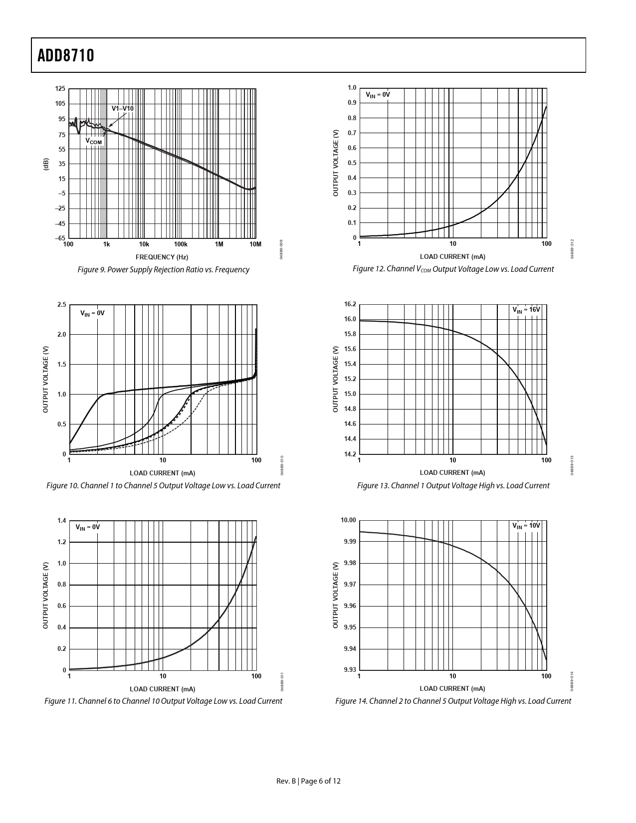

ADD8710. 125. 1.0. VIN = 0V. 105. 0.9. V1–V10. 0.8. 0.7. COM. 0.6. LTAG. 0.5. UT P. 0.4. 0.3. –25. 0.2. –45. 0.1. –65. 100. 10k. 100k. 10M. FREQUENCY (Hz)

04 04 Figure 9. Power Supply Rejection Ratio vs. Frequency Figure 12. Channel VCOM Output Voltage Low vs. Load Current

04 Figure 10. Channel 1 to Channel 5 Output Voltage Low vs. Load Current Figure 13. Channel 1 Output Voltage High vs. Load Current

04 Figure 11. Channel 6 to Channel 10 Output Voltage Low vs. Load Current Figure 14. Channel 2 to Channel 5 Output Voltage High vs. Load Current Rev. B | Page 6 of 12 Document Outline FEATURES APPLICATIONS GENERAL DESCRIPTION PIN CONFIGURATION FUNCTIONAL BLOCK DIAGRAM TABLE OF CONTENTS REVISION HISTORY SPECIFICATIONS ABSOLUTE MAXIMUM RATINGS THERMAL RESISTANCE ESD CAUTION TYPICAL PERFORMANCE CHARACTERISTICS OUTLINE DIMENSIONS ORDERING GUIDE
