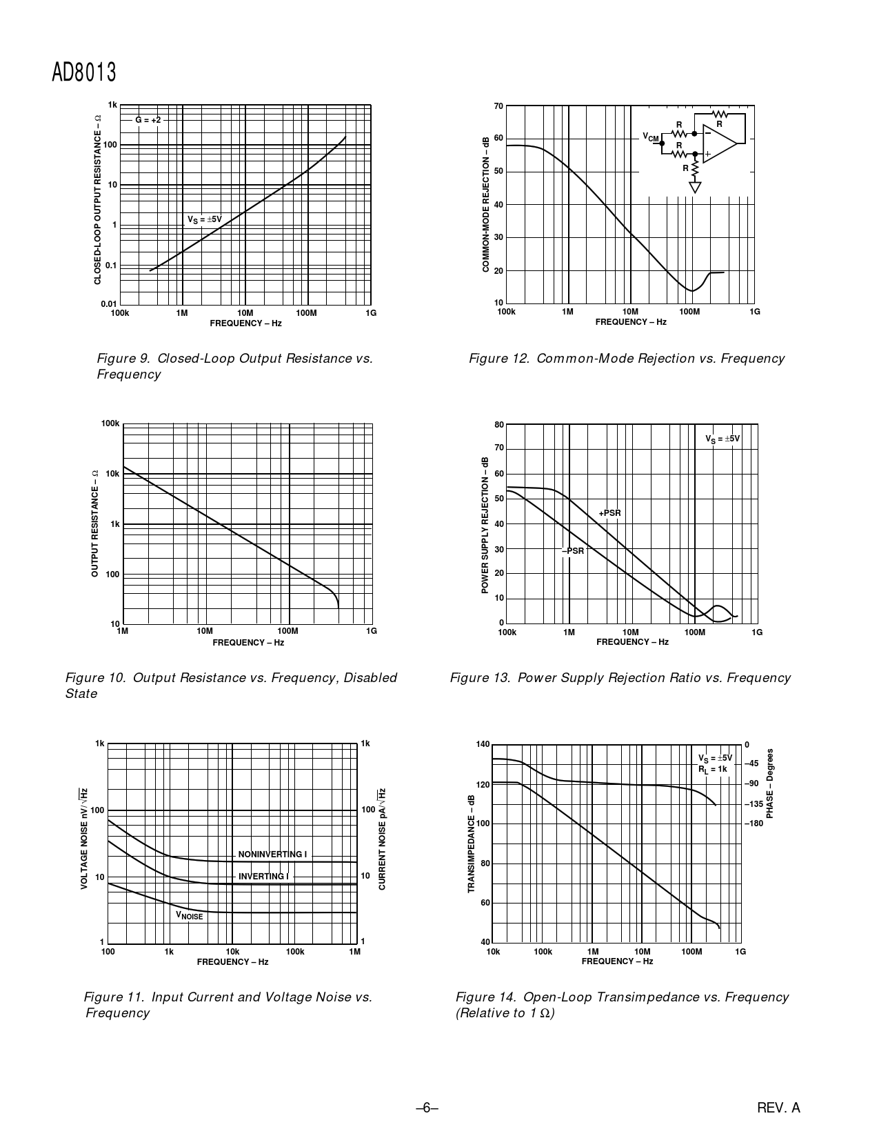

AD8013. G = +2. VCM. 100. S =. 0.1. COMMON-MODE REJECTION – dB 20. CLOSED-LOOP OUTPUT RESISTANCE –. 0.01. 100k. 10M. 100M. FREQUENCY – Hz. VS =
AD8013 G = +2 VCM 100 S = 0.1 COMMON-MODE REJECTION – dB 20 CLOSED-LOOP OUTPUT RESISTANCE – 0.01 100k 10M 100M FREQUENCY – Hz VS =
AD8013 1k 70
G = +2 R R 60 VCM 100 R 50 R 10 40 V 1 S =
5V 30 0.1 COMMON-MODE REJECTION – dB 20 CLOSED-LOOP OUTPUT RESISTANCE – 0.01 10 100k 1M 10M 100M 1G 100k 1M 10M 100M 1G FREQUENCY – Hz FREQUENCY – Hz
Figure 9. Closed-Loop Output Resistance vs. Figure 12. Common-Mode Rejection vs. Frequency Frequency
100k 80 VS =
5V 70
10k 60 50 +PSR 1k 40 30 –PSR OUTPUT RESISTANCE – 100 20 POWER SUPPLY REJECTION – dB 10 10 0 1M 10M 100M 1G 100k 1M 10M 100M 1G FREQUENCY – Hz FREQUENCY – Hz
Figure 10. Output Resistance vs. Frequency, Disabled Figure 13. Power Supply Rejection Ratio vs. Frequency State
1k 1k 140 0 VS =
5V –45 RL = 1k 120 –90
Hz
Hz / –135 100 100 PHASE – Degrees 100 –180 NONINVERTING I 80 10 INVERTING I 10 VOLTAGE NOISE nV CURRENT NOISE pA/ TRANSIMPEDANCE – dB 60 VNOISE 1 1 40 100 1k 10k 100k 1M 10k 100k 1M 10M 100M 1G FREQUENCY – Hz FREQUENCY – Hz
Figure 11. Input Current and Voltage Noise vs. Figure 14. Open-Loop Transimpedance vs. Frequency Frequency (Relative to 1 Ω) –6– REV. A
