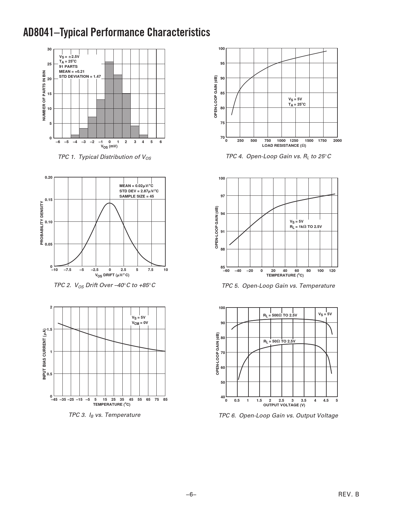

AD8041–Typical Performance Characteristics. 100. VS =. 2.5V T. A = 25. 91 PARTS MEAN = +0.21 STD DEVIATION = 1.47. VS = 5V TA = 25
AD8041–Typical Performance Characteristics 100 VS = 2.5V T A = 25 91 PARTS MEAN = +0.21 STD DEVIATION = 1.47 VS = 5V TA = 25
AD8041
AD8041–Typical Performance Characteristics 30 100 VS =
2.5V T 25 A = 25
C 95 91 PARTS MEAN = +0.21 STD DEVIATION = 1.47 20 90 15 85 VS = 5V TA = 25
C 10 80 OPEN-LOOP GAIN (dB) NUMBER OF PARTS IN BIN 5 75 0 70 –6 –5 –4 –3 –2 –1 0 1 2 3 4 5 6 0 250 500 750 1000 1250 1500 1750 2000 V LOAD RESISTANCE (
) OS (mV)
TPC 1. Typical Distribution of V TPC 4. Open-Loop Gain vs. R OS L to 25°C
0.20 100 MEAN = 0.02
V/
C STD DEV = 2.87
V/
C SAMPLE SIZE = 45 97 0.15 94 0.10 VS = 5V RL = 1k
TO 2.5V 91 PROBABILITY DENSITY 0.05 OPEN-LOOP GAIN (dB) 88 0 85 –10 –7.5 –5 –2.5 0 2.5 5 7.5 10 –60 –40 –20 0 20 40 60 80 100 120 VOS DRIFT (
V/
C) TEMPERATURE (
C)
TPC 2. VOS Drift Over –40°C to +85°C TPC 5. Open-Loop Gain vs. Temperature
2 100 R V L = 500
TO 2.5V VS = 5V S = 5V VCM = 0V 90 1.5 A)
80 RL = 50
TO 2.5V 1 70 60 0.5 OPEN-LOOP GAIN (dB) INPUT BIAS CURRENT ( 50 0 40 –45 –35 –25 –15 –5 5 15 25 35 45 55 65 75 85 0 0.5 1 1.5 2 2.5 3 3.5 4 4.5 5 TEMPERATURE (
C) OUTPUT VOLTAGE (V)
TPC 3. IB vs. Temperature TPC 6. Open-Loop Gain vs. Output Voltage –6– REV. B Document Outline FEATURES APPLICATIONS PRODUCT DESCRIPTION CONNECTION DIAGRAM SPECIFICATIONS ABSOLUTE MAXIMUM RATINGS MAXIMUM POWER DISSIPATION ORDERING GUIDE Typical Performance Characteristics Overdrive Recovery Circuit Description Output Impedance Disable Operation Single-Supply A/D Conversion APPLICATIONS RGB Buffer Single-Supply Composite Video Line Driver Sync Stripper Layout Considerations OUTLINE DIMENSIONS Revision History
