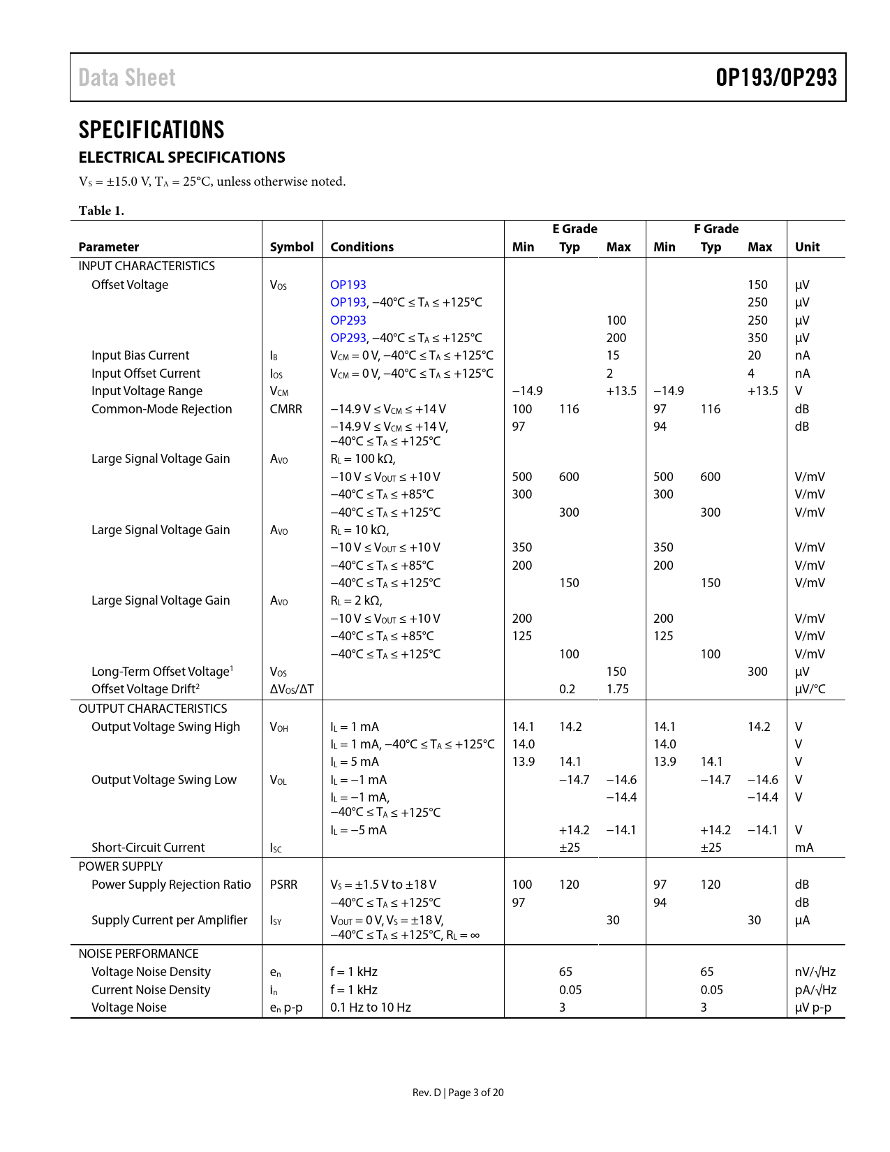

Data Sheet. OP193/OP293. SPECIFICATIONS ELECTRICAL SPECIFICATIONS. Table 1. E Grade. F Grade. Parameter. Symbol Conditions. Min. Typ. Max
Data Sheet OP193/OP293 SPECIFICATIONS ELECTRICAL SPECIFICATIONS Table 1 E Grade F Grade Parameter Symbol Conditions Min Typ Max
link to page 4 link to page 4
VS = ±15.0 V, TA = 25°C, unless otherwise noted.
Table 1. E Grade F Grade Parameter Symbol Conditions Min Typ Max Min Typ Max Unit
INPUT CHARACTERISTICS Offset Voltage VOS OP193 150 μV OP193, −40°C ≤ TA ≤ +125°C 250 μV OP293 100 250 μV OP293, −40°C ≤ TA ≤ +125°C 200 350 μV Input Bias Current IB VCM = 0 V, −40°C ≤ TA ≤ +125°C 15 20 nA Input Offset Current IOS VCM = 0 V, −40°C ≤ TA ≤ +125°C 2 4 nA Input Voltage Range VCM −14.9 +13.5 −14.9 +13.5 V Common-Mode Rejection CMRR −14.9 V ≤ VCM ≤ +14 V 100 116 97 116 dB −14.9 V ≤ VCM ≤ +14 V, 97 94 dB −40°C ≤ TA ≤ +125°C Large Signal Voltage Gain AVO RL = 100 kΩ, −10 V ≤ VOUT ≤ +10 V 500 600 500 600 V/mV −40°C ≤ TA ≤ +85°C 300 300 V/mV −40°C ≤ TA ≤ +125°C 300 300 V/mV Large Signal Voltage Gain AVO RL = 10 kΩ, −10 V ≤ VOUT ≤ +10 V 350 350 V/mV −40°C ≤ TA ≤ +85°C 200 200 V/mV −40°C ≤ TA ≤ +125°C 150 150 V/mV Large Signal Voltage Gain AVO RL = 2 kΩ, −10 V ≤ VOUT ≤ +10 V 200 200 V/mV −40°C ≤ TA ≤ +85°C 125 125 V/mV −40°C ≤ TA ≤ +125°C 100 100 V/mV Long-Term Offset Voltage1 VOS 150 300 μV Offset Voltage Drift2 ΔVOS/ΔT 0.2 1.75 μV/°C OUTPUT CHARACTERISTICS Output Voltage Swing High VOH IL = 1 mA 14.1 14.2 14.1 14.2 V IL = 1 mA, −40°C ≤ TA ≤ +125°C 14.0 14.0 V IL = 5 mA 13.9 14.1 13.9 14.1 V Output Voltage Swing Low VOL IL = −1 mA −14.7 −14.6 −14.7 −14.6 V IL = −1 mA, −14.4 −14.4 V −40°C ≤ TA ≤ +125°C IL = −5 mA +14.2 −14.1 +14.2 −14.1 V Short-Circuit Current ISC ±25 ±25 mA POWER SUPPLY Power Supply Rejection Ratio PSRR VS = ±1.5 V to ±18 V 100 120 97 120 dB −40°C ≤ TA ≤ +125°C 97 94 dB Supply Current per Amplifier ISY VOUT = 0 V, VS = ±18 V, 30 30 μA −40°C ≤ TA ≤ +125°C, RL = ∞ NOISE PERFORMANCE Voltage Noise Density en f = 1 kHz 65 65 nV/√Hz Current Noise Density in f = 1 kHz 0.05 0.05 pA/√Hz Voltage Noise en p-p 0.1 Hz to 10 Hz 3 3 μV p-p Rev. D | Page 3 of 20 Document Outline FEATURES APPLICATIONS GENERAL DESCRIPTION PIN CONFIGURATIONS TABLE OF CONTENTS REVISION HISTORY SPECIFICATIONS ELECTRICAL SPECIFICATIONS ABSOLUTE MAXIMUM RATINGS THERMAL RESISTANCE ESD CAUTION TYPICAL PERFORMANCE CHARACTERISTICS FUNCTIONAL DESCRIPTION DRIVING CAPACITIVE LOADS INPUT OVERVOLTAGE PROTECTION OUTPUT PHASE REVERSAL—OP193 OUTPUT PHASE REVERSAL—OP293 BATTERY-POWERED APPLICATIONS A MICROPOWER FALSE-GROUND GENERATOR A BATTERY-POWERED VOLTAGE REFERENCE A SINGLE-SUPPLY CURRENT MONITOR A SINGLE-SUPPLY INSTRUMENTATION AMPLIFIER A LOW POWER, TEMPERATURE TO 4 mA TO 20 mA TRANSMITTER A MICROPOWER VOLTAGE CONTROLLED OSCILLATOR OUTLINE DIMENSIONS ORDERING GUIDE
