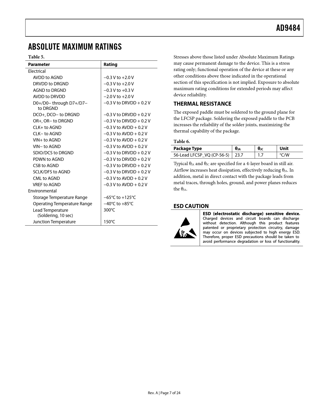

AD9484 ABSOLUTE MAXIMUM RATINGS Table 5.
Stresses above those listed under Absolute Maximum Ratings
Parameter Rating
may cause permanent damage to the device. This is a stress Electrical rating only; functional operation of the device at these or any AVDD to AGND −0.3 V to +2.0 V other conditions above those indicated in the operational DRVDD to DRGND −0.3 V to +2.0 V section of this specification is not implied. Exposure to absolute AGND to DRGND −0.3 V to +0.3 V maximum rating conditions for extended periods may affect AVDD to DRVDD −2.0 V to +2.0 V device reliability. D0+/D0− through D7+/D7− −0.3 V to DRVDD + 0.2 V
THERMAL RESISTANCE
to DRGND The exposed paddle must be soldered to the ground plane for DCO+, DCO− to DRGND −0.3 V to DRVDD + 0.2 V the LFCSP package. Soldering the exposed paddle to the PCB OR+, OR− to DRGND −0.3 V to DRVDD + 0.2 V increases the reliability of the solder joints, maximizing the CLK+ to AGND −0.3 V to AVDD + 0.2 V thermal capability of the package. CLK− to AGND −0.3 V to AVDD + 0.2 V VIN+ to AGND −0.3 V to AVDD + 0.2 V
Table 6.
VIN− to AGND −0.3 V to AVDD + 0.2 V
Package Type θJA θJC Unit
SDIO/DCS to DRGND −0.3 V to DRVDD + 0.2 V 56-Lead LFCSP_VQ (CP-56-5) 23.7 1.7 °C/W PDWN to AGND −0.3 V to DRVDD + 0.2 V CSB to AGND −0.3 V to DRVDD + 0.2 V Typical θJA and θJC are specified for a 4-layer board in still air. SCLK/DFS to AGND −0.3 V to DRVDD + 0.2 V Airflow increases heat dissipation, effectively reducing θJA. In CML to AGND −0.3 V to AVDD + 0.2 V addition, metal in direct contact with the package leads from VREF to AGND −0.3 V to AVDD + 0.2 V metal traces, through holes, ground, and power planes reduces Environmental the θJA. Storage Temperature Range −65°C to +125°C Operating Temperature Range −40°C to +85°C
