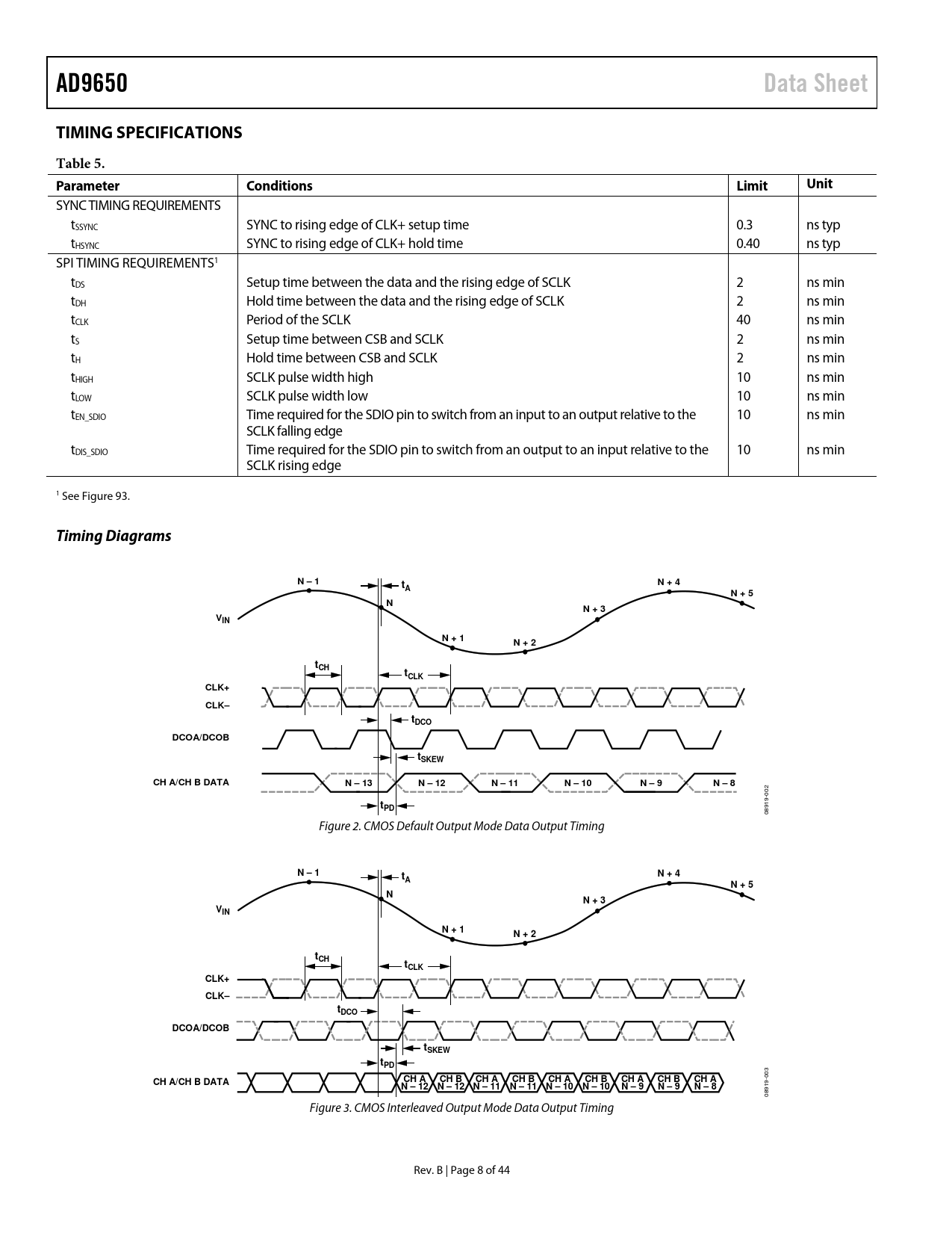

AD9650. Data Sheet. TIMING SPECIFICATIONS. Table 5. Parameter. Conditions. Limit. Unit. Timing Diagrams. N – 1. N + 4. N + 5. N + 3. VIN. N + 1
AD9650 Data Sheet TIMING SPECIFICATIONS Table 5 Parameter Conditions Limit Unit Timing Diagrams N – 1 N + 4 N + 5 N + 3 VIN N + 1
link to page 38
AD9650 Data Sheet TIMING SPECIFICATIONS Table 5. Parameter Conditions Limit Unit
SYNC TIMING REQUIREMENTS tSSYNC SYNC to rising edge of CLK+ setup time 0.3 ns typ tHSYNC SYNC to rising edge of CLK+ hold time 0.40 ns typ SPI TIMING REQUIREMENTS1 tDS Setup time between the data and the rising edge of SCLK 2 ns min tDH Hold time between the data and the rising edge of SCLK 2 ns min tCLK Period of the SCLK 40 ns min tS Setup time between CSB and SCLK 2 ns min tH Hold time between CSB and SCLK 2 ns min tHIGH SCLK pulse width high 10 ns min tLOW SCLK pulse width low 10 ns min tEN_SDIO Time required for the SDIO pin to switch from an input to an output relative to the 10 ns min SCLK falling edge tDIS_SDIO Time required for the SDIO pin to switch from an output to an input relative to the 10 ns min SCLK rising edge 1 See Figure 93.
Timing Diagrams N – 1 N + 4 tA N + 5 N N + 3 VIN N + 1 N + 2 tCH tCLK CLK+ CLK– tDCO DCOA/DCOB tSKEW CH A/CH B DATA N – 13 N – 12 N – 11 N – 10 N – 9 N – 8
02 0 9-
tPD
91 08 Figure 2. CMOS Default Output Mode Data Output Timing
N – 1 N + 4 tA N + 5 N N + 3 VIN N + 1 N + 2 tCH tCLK CLK+ CLK– tDCO DCOA/DCOB tSKEW tPD
03
CH A CH B CH A CH B CH A CH B CH A CH B CH A
-0
CH A/CH B DATA N – 12 N – 12 N – 11 N – 11 N – 10 N – 10 N – 9 N – 9 N – 8
19 89 0 Figure 3. CMOS Interleaved Output Mode Data Output Timing Rev. B | Page 8 of 44 Document Outline FEATURES APPLICATIONS GENERAL DESCRIPTION FUNCTIONAL BLOCK DIAGRAM PRODUCT HIGHLIGHTS TABLE OF CONTENTS REVISION HISTORY SPECIFICATIONS ADC DC SPECIFICATIONS ADC AC SPECIFICATIONS DIGITAL SPECIFICATIONS SWITCHING SPECIFICATIONS TIMING SPECIFICATIONS Timing Diagrams ABSOLUTE MAXIMUM RATINGS THERMAL CHARACTERISTICS ESD CAUTION PIN CONFIGURATIONS AND FUNCTION DESCRIPTIONS TYPICAL PERFORMANCE CHARACTERISTICS AD9650-25 AD9650-65 AD9650-80 AD9650-105 EQUIVALENT CIRCUITS THEORY OF OPERATION ADC ARCHITECTURE ANALOG INPUT CONSIDERATIONS Input Common Mode Common-Mode Voltage Servo Dither Large-Signal FFT Small-Signal FFT Static Linearity Differential Input Configurations VOLTAGE REFERENCE Internal Reference Connection External Reference Operation Clock Input Considerations Clock Input Options Input Clock Divider Clock Duty Cycle Jitter Considerations CHANNEL/CHIP SYNCHRONIZATION POWER DISSIPATION AND STANDBY MODE DIGITAL OUTPUTS Digital Output Enable Function (OEB) TIMING Data Clock Output (DCO) BUILT-IN SELF-TEST (BIST) AND OUTPUT TEST BUILT-IN SELF-TEST (BIST) OUTPUT TEST MODES SERIAL PORT INTERFACE (SPI) CONFIGURATION USING THE SPI HARDWARE INTERFACE CONFIGURATION WITHOUT THE SPI SPI ACCESSIBLE FEATURES MEMORY MAP READING THE MEMORY MAP REGISTER TABLE Open Locations Default Values Logic Levels Transfer Register Map Channel-Specific Registers MEMORY MAP REGISTER TABLE MEMORY MAP REGISTER DESCRIPTIONS SYNC Control (Register 0x100) Bits[7:3]—Reserved Bit 2—Clock Divider Next SYNC Only Bit 1—Clock Divider SYNC Enable Bit 0—Master SYNC Enable APPLICATIONS INFORMATION DESIGN GUIDELINES Power and Ground Recommendations LVDS Operation Exposed Paddle Thermal Heat Slug Recommendations VCM RBIAS Reference Decoupling SPI Port OUTLINE DIMENSIONS ORDERING GUIDE
