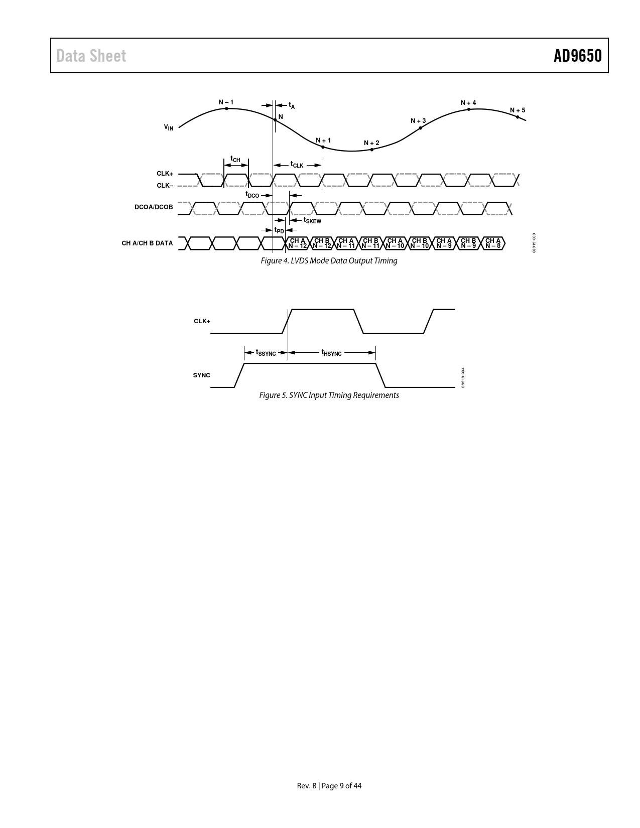

Data Sheet. AD9650. N – 1. N + 4. N + 5. N + 3. VIN. N + 1. N + 2. tCH. tCLK. CLK+. CLK–. tDCO. DCOA/DCOB. tSKEW. tPD. CH A. CH B. CH A/CH B DATA. N – 12
Data Sheet AD9650 N – 1 N + 4 N + 5 N + 3 VIN N + 1 N + 2 tCH tCLK CLK+ CLK– tDCO DCOA/DCOB tSKEW tPD CH A CH B CH A/CH B DATA N – 12
Data Sheet AD9650 N – 1 N + 4 tA N + 5 N N + 3 VIN N + 1 N + 2 tCH tCLK CLK+ CLK– tDCO DCOA/DCOB tSKEW tPD CH A CH B CH A CH B CH A CH B CH A CH B CH A
-003
CH A/CH B DATA N – 12 N – 12 N – 11 N – 11 N – 10 N – 10 N – 9 N – 9 N – 8
19 89 0 Figure 4. LVDS Mode Data Output Timing
CLK+ t t SSYNC HSYNC
04
SYNC
0 9- 91 08 Figure 5. SYNC Input Timing Requirements Rev. B | Page 9 of 44 Document Outline FEATURES APPLICATIONS GENERAL DESCRIPTION FUNCTIONAL BLOCK DIAGRAM PRODUCT HIGHLIGHTS TABLE OF CONTENTS REVISION HISTORY SPECIFICATIONS ADC DC SPECIFICATIONS ADC AC SPECIFICATIONS DIGITAL SPECIFICATIONS SWITCHING SPECIFICATIONS TIMING SPECIFICATIONS Timing Diagrams ABSOLUTE MAXIMUM RATINGS THERMAL CHARACTERISTICS ESD CAUTION PIN CONFIGURATIONS AND FUNCTION DESCRIPTIONS TYPICAL PERFORMANCE CHARACTERISTICS AD9650-25 AD9650-65 AD9650-80 AD9650-105 EQUIVALENT CIRCUITS THEORY OF OPERATION ADC ARCHITECTURE ANALOG INPUT CONSIDERATIONS Input Common Mode Common-Mode Voltage Servo Dither Large-Signal FFT Small-Signal FFT Static Linearity Differential Input Configurations VOLTAGE REFERENCE Internal Reference Connection External Reference Operation Clock Input Considerations Clock Input Options Input Clock Divider Clock Duty Cycle Jitter Considerations CHANNEL/CHIP SYNCHRONIZATION POWER DISSIPATION AND STANDBY MODE DIGITAL OUTPUTS Digital Output Enable Function (OEB) TIMING Data Clock Output (DCO) BUILT-IN SELF-TEST (BIST) AND OUTPUT TEST BUILT-IN SELF-TEST (BIST) OUTPUT TEST MODES SERIAL PORT INTERFACE (SPI) CONFIGURATION USING THE SPI HARDWARE INTERFACE CONFIGURATION WITHOUT THE SPI SPI ACCESSIBLE FEATURES MEMORY MAP READING THE MEMORY MAP REGISTER TABLE Open Locations Default Values Logic Levels Transfer Register Map Channel-Specific Registers MEMORY MAP REGISTER TABLE MEMORY MAP REGISTER DESCRIPTIONS SYNC Control (Register 0x100) Bits[7:3]—Reserved Bit 2—Clock Divider Next SYNC Only Bit 1—Clock Divider SYNC Enable Bit 0—Master SYNC Enable APPLICATIONS INFORMATION DESIGN GUIDELINES Power and Ground Recommendations LVDS Operation Exposed Paddle Thermal Heat Slug Recommendations VCM RBIAS Reference Decoupling SPI Port OUTLINE DIMENSIONS ORDERING GUIDE
