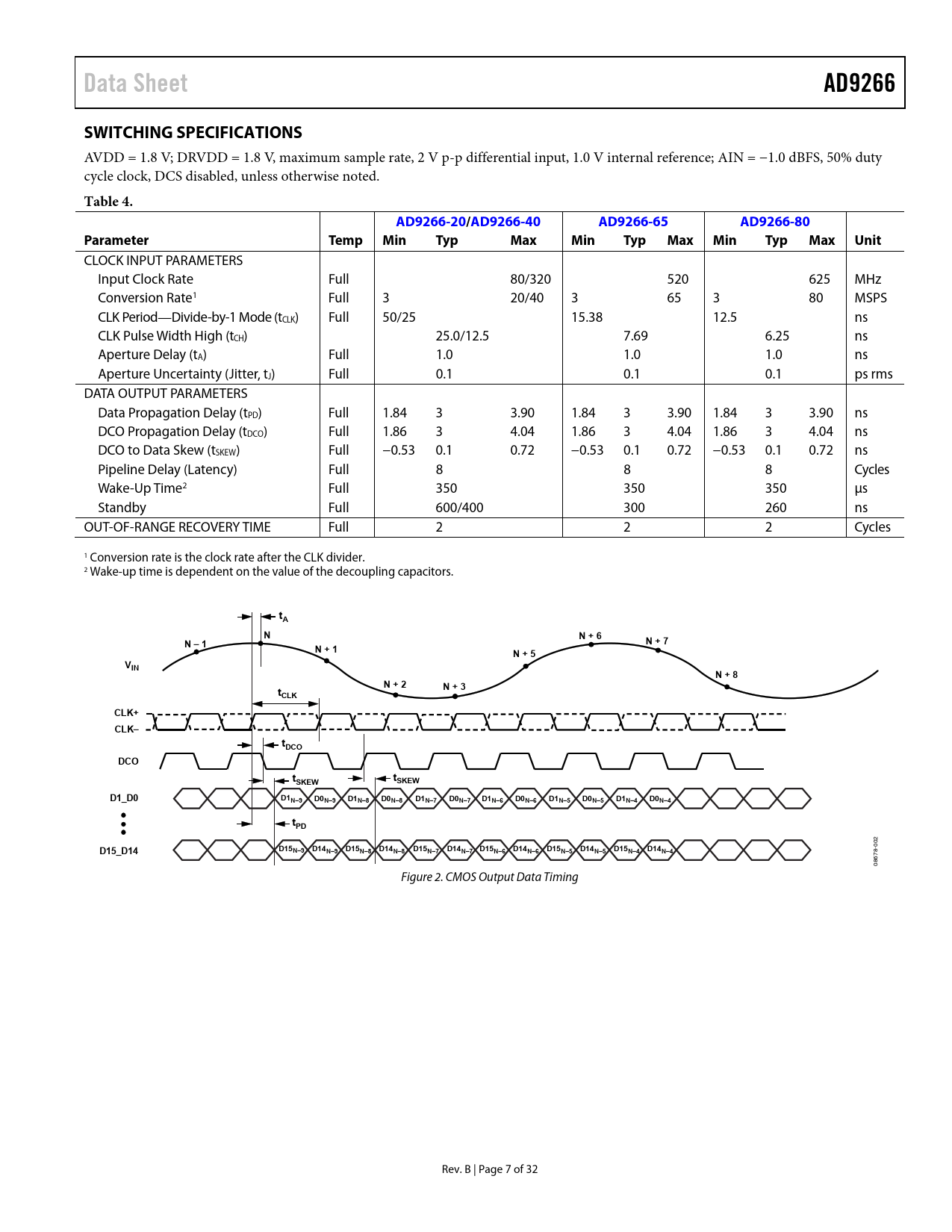

Data Sheet. AD9266. SWITCHING SPECIFICATIONS. Table 4. AD9266-20/AD9266-40. AD9266-65. AD9266-80. Parameter Temp. Min Typ. Max Min Typ. Max
Data Sheet AD9266 SWITCHING SPECIFICATIONS Table 4 AD9266-20/AD9266-40 AD9266-65 AD9266-80 Parameter Temp Min Typ Max Min Typ Max
AVDD = 1.8 V; DRVDD = 1.8 V, maximum sample rate, 2 V p-p differential input, 1.0 V internal reference; AIN = −1.0 dBFS, 50% duty cycle clock, DCS disabled, unless otherwise noted.
Table 4. AD9266-20/AD9266-40 AD9266-65 AD9266-80 Parameter Temp Min Typ Max Min Typ Max Min Typ Ma Unit x
CLOCK INPUT PARAMETERS Input Clock Rate Full 80/320 520 625 MHz Conversion Rate1 Full 3 20/40 3 65 3 80 MSPS CLK Period—Divide-by-1 Mode (tCLK) Full 50/25 15.38 12.5 ns CLK Pulse Width High (tCH) 25.0/12.5 7.69 6.25 ns Aperture Delay (tA) Full 1.0 1.0 1.0 ns Aperture Uncertainty (Jitter, tJ) Full 0.1 0.1 0.1 ps rms DATA OUTPUT PARAMETERS Data Propagation Delay (tPD) Full 1.84 3 3.90 1.84 3 3.90 1.84 3 3.90 ns DCO Propagation Delay (tDCO) Full 1.86 3 4.04 1.86 3 4.04 1.86 3 4.04 ns DCO to Data Skew (tSKEW) Full −0.53 0.1 0.72 −0.53 0.1 0.72 −0.53 0.1 0.72 ns Pipeline Delay (Latency) Full 8 8 8 Cycles Wake-Up Time2 Full 350 350 350 μs Standby Full 600/400 300 260 ns OUT-OF-RANGE RECOVERY TIME Full 2 2 2 Cycles 1 Conversion rate is the clock rate after the CLK divider. 2 Wake-up time is dependent on the value of the decoupling capacitors.
tA N N + 6 N – 1 N + 7 N + 1 N + 5 VIN N + 8 N + 2 t N + 3 CLK CLK+ CLK– tDCO DCO t t SKEW SKEW D1_D0 D1N–9 D0N–9 D1N–8 D0N–8 D1N–7 D0N–7 D1N–6 D0N–6 D1N–5 D0N–5 D1N–4 D0N–4 tPD
2 -00
D15 D15_D14 N–9 D14N–9 D15N–8 D14N–8 D15N–7 D14N–7 D15N–6 D14N–6 D15N–5 D14N–5 D15N–4 D14N–4
