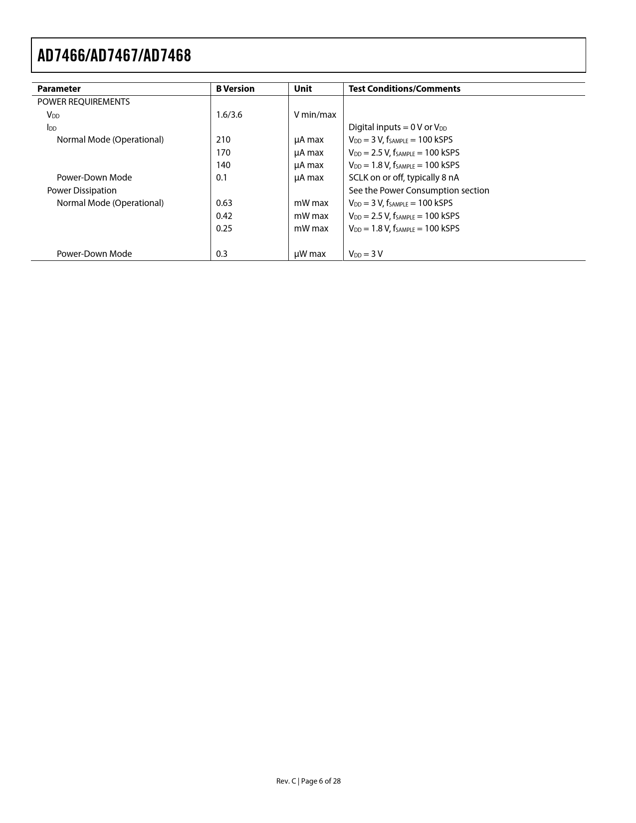

AD7466/AD7467/AD7468 Parameter B Version Unit Test Conditions/Comments
POWER REQUIREMENTS VDD 1.6/3.6 V min/max IDD Digital inputs = 0 V or VDD Normal Mode (Operational) 210 μA max VDD = 3 V, fSAMPLE = 100 kSPS 170 μA max VDD = 2.5 V, fSAMPLE = 100 kSPS 140 μA max VDD = 1.8 V, fSAMPLE = 100 kSPS Power-Down Mode 0.1 μA max SCLK on or off, typically 8 nA Power Dissipation See the Power Consumption section Normal Mode (Operational) 0.63 mW max VDD = 3 V, fSAMPLE = 100 kSPS 0.42 mW max VDD = 2.5 V, fSAMPLE = 100 kSPS 0.25 mW max VDD = 1.8 V, fSAMPLE = 100 kSPS Power-Down Mode 0.3 μW max VDD = 3 V Rev. C | Page 6 of 28 Document Outline FEATURES APPLICATIONS FUNCTIONAL BLOCK DIAGRAM GENERAL DESCRIPTION PRODUCT HIGHLIGHTS TABLE OF CONTENTS REVISION HISTORY SPECIFICATIONS AD7466 AD7467 AD7468 TIMING SPECIFICATIONS TIMING EXAMPLES Timing Example 1 Timing Example 2 ABSOLUTE MAXIMUM RATINGS ESD CAUTION PIN CONFIGURATIONS AND FUNCTION DESCRIPTIONS TYPICAL PERFORMANCE CHARACTERISTICS DYNAMIC PERFORMANCE CURVES DC ACCURACY CURVES POWER REQUIREMENT CURVES TERMINOLOGY THEORY OF OPERATION CIRCUIT INFORMATION CONVERTER OPERATION ADC TRANSFER FUNCTION TYPICAL CONNECTION DIAGRAM ANALOG INPUT DIGITAL INPUTS NORMAL MODE POWER CONSUMPTION Power Consumption Example 1 Power Consumption Example 2 SERIAL INTERFACE MICROPROCESSOR INTERFACING AD7466/AD7467/AD7468 to TMS320C541 Interface AD7466/AD7467/AD7468 to ADSP-218x Interface AD7466/AD7467/AD7468 to DSP563xx Interface APPLICATION HINTS GROUNDING AND LAYOUT EVALUATING THE PERFORMANCE OF THE AD7466 AND AD7467 OUTLINE DIMENSIONS ORDERING GUIDE
