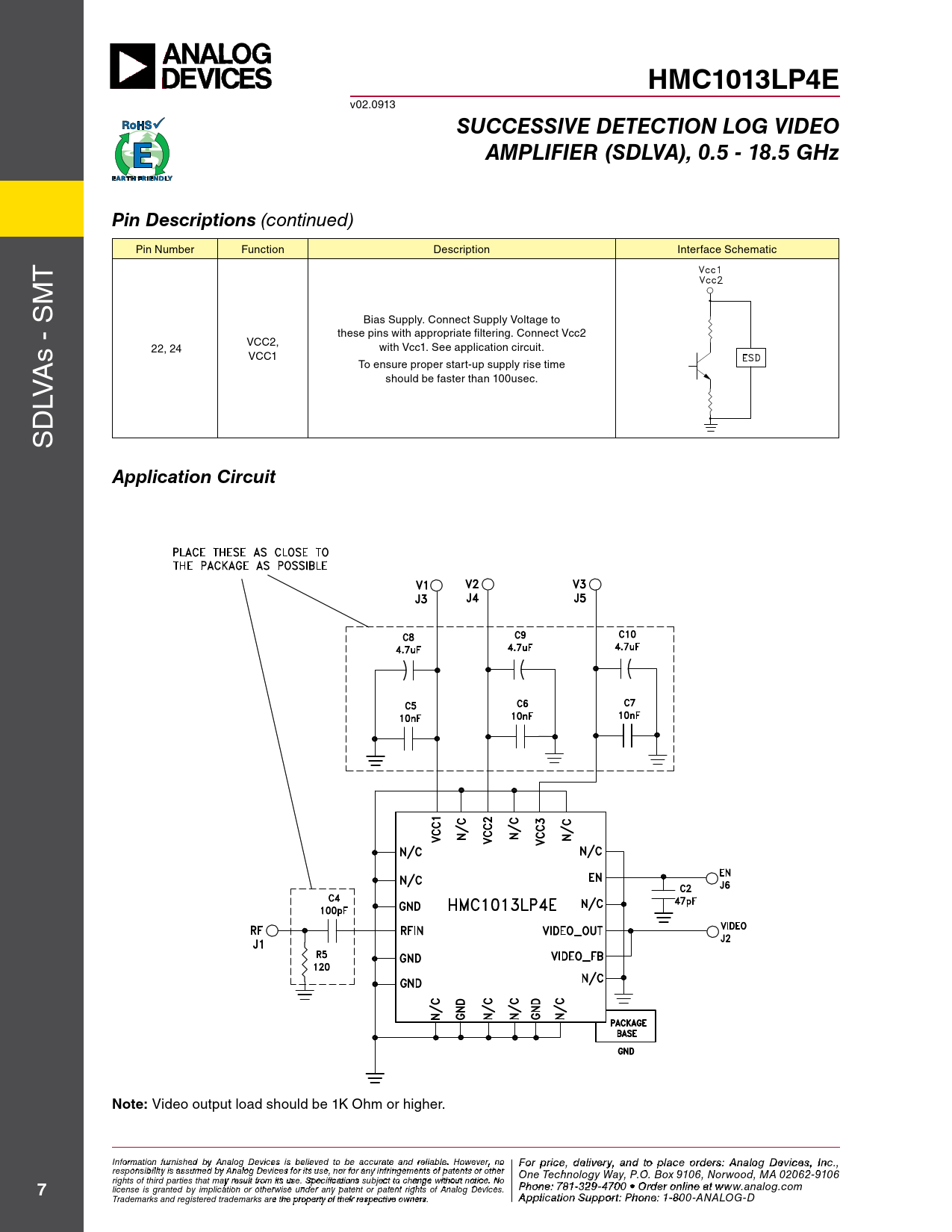

HMC1013LP4E. SUCCESSIVE DETECTION LOG VIDEO. AMPLIFIER (SDLVA), 0.5 - 18.5 GHz. Pin Descriptions. Application Circuit. Note:
HMC1013LP4E SUCCESSIVE DETECTION LOG VIDEO AMPLIFIER (SDLVA), 0.5 - 18.5 GHz Pin Descriptions Application Circuit Note:
HMC1013LP4E
v02.0913
(continued) Pin Number Function Description Interface Schematic T M S Bias Supply. Connect Supply Voltage to - these pins with appropriate filtering. Connect Vcc2 VCC2, 22, 24 with Vcc1. See application circuit. As VCC1 To ensure proper start-up supply rise time should be faster than 100usec. LV SD
Video output load should be 1K Ohm or higher. Inf F or o m r p atio r n ifc ur e n , d ishe e d lbiv y e A r n y a alog n D d t evic o p es is la beclie o eved rd to ebre sa: H ccur iattti e tae M nd re ilicarbloew . H a o ve C wever, o n rp o For price, delivery, and to place orders: Analog Devices, Inc., responsibility is assumed by Analog Devices for its use, nor for any infringements of patents or other oration, 2 Elizabeth Drive, Chelmsford, MA 01824 One Technology Way, P.O. Box 9106, Norwood, MA 02062-9106 Phone: 978-250-3343 Fax: 978-250-3373 O rights of third parties that may result from its use. Specifications subject to change without notice. No P rd hone e r O : 7 n 81- -3li 2n 9 e a -47 t w 0 w 0 • O w rd .h e it r o t niltie n .c e ao t m
