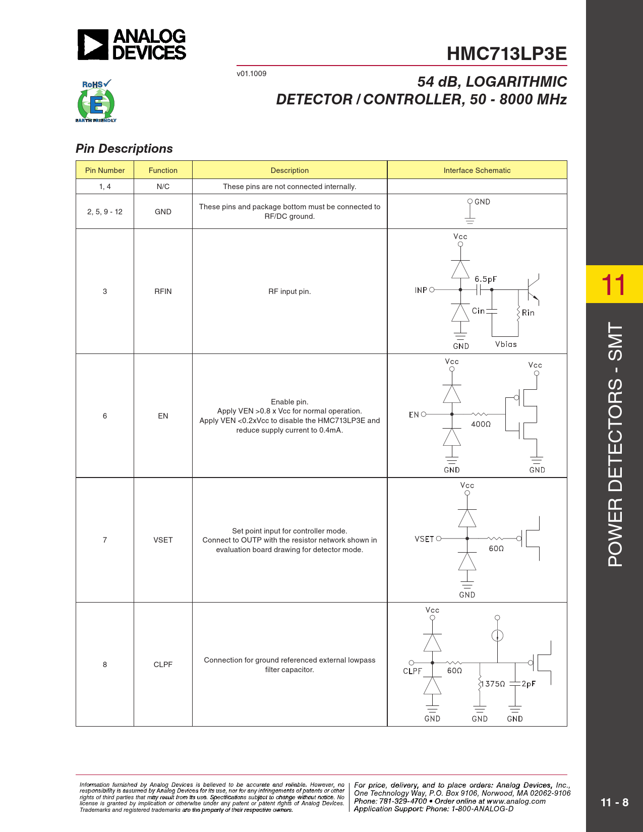

54 dB, LOGARITHMIC DETECTOR / CONTROLLER, 50 - 8000 MHz Pin Descriptions
Pin Number Function Description Interface schematic 1, 4 N/c these pins are not connected internally. these pins and package bottom must be connected to 2, 5, 9 - 12 GND rF/Dc ground. 3 rFIN rF input pin. 11 t M s s - enable pin. r Apply VeN >0.8 x Vcc for normal operation. 6 eN o Apply VeN <0.2xVcc to disable the HMc713LP3e and reduce supply current to 0.4mA. t c e t e D r e set point input for controller mode. 7 Vset connect to oUtP with the resistor network shown in w evaluation board drawing for detector mode. o P connection for ground referenced external lowpass 8 cLPF filter capacitor. Inf F or o m rat ip o r n ifc ur e n ,is hd e e d lbiv y e Anry alo a g n D d evi cto es ips la beclie ev eo d rtd o e b r e sa: ccH ur iattte itaen M d reliic a r bl o e w . H a o v weev eC r, o n r o For price, delivery, and to place orders: Analog Devices, Inc., responsibility is assumed by Analog Devices for its use, nor for any infringements of patents or other poration, 20 Alpha Road, Chelmsford, MA 01824 One Technology Way, P.O. Box 9106, Norwood, MA 02062-9106 Phone: 978-250-3343 Fax: 978-250-3373 rights of third parties that may result from its use. Specifications subject to change without notice. No Or P d hoe n r e O : 7 n- 81-li 3 n 2 e 9- a 4 t 7 0 www 0 • O . rdh e itt r o it n e li . n co e a m license is granted by implication or otherwise under any patent or patent rights of Analog Devices. t www.analog.com
