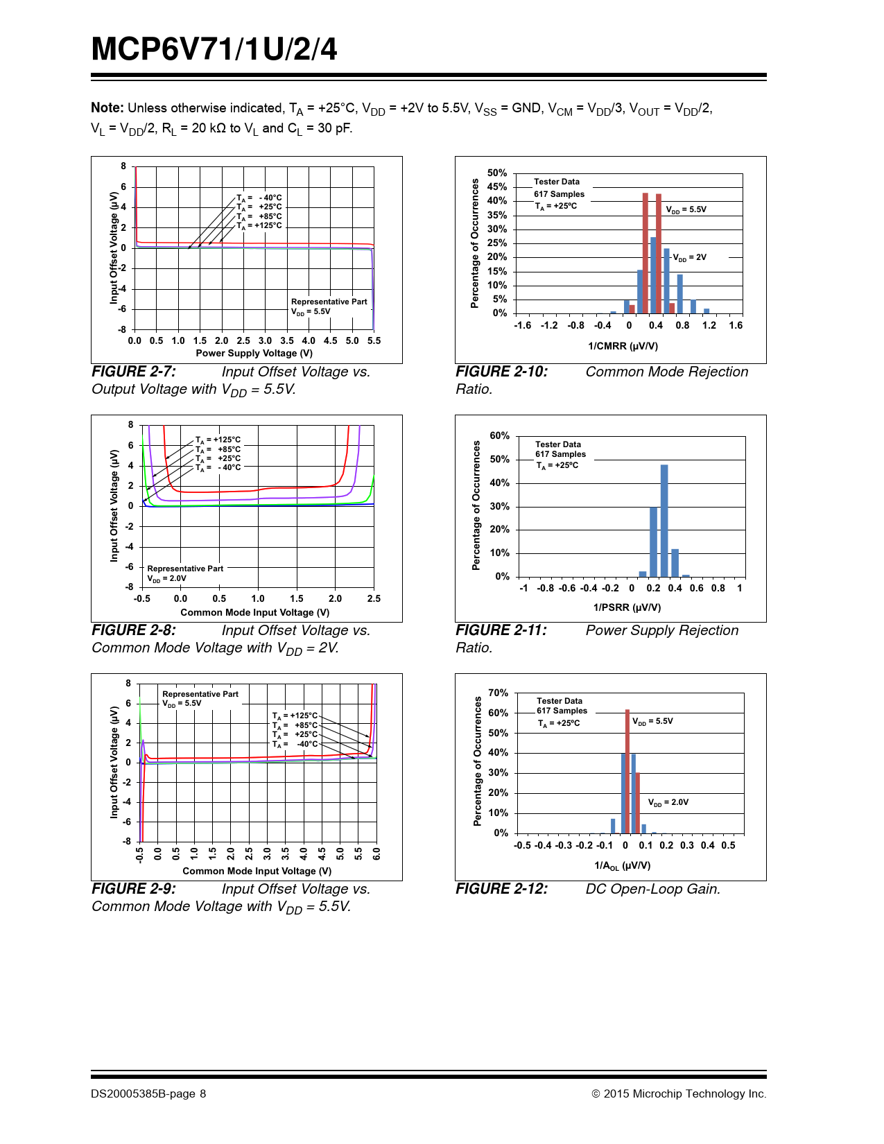

Pages / Page46 / 8 — MCP6V71/1U/2/4. Note:. 50%. Tester Data. 45%. T = - 40°C. 617 Samples. …
MCP6V71/1U/2/4. Note:. 50%. Tester Data. 45%. T = - 40°C. 617 Samples. 40%. (µV) 4. T = +25°C. T = +25ºC. = 5.5V. T = +85°C. 35%. T = +125°C. ltage
MCP6V71/1U/2/4 Note: 50% Tester Data 45% T = - 40°C 617 Samples 40% (µV) 4 T = +25°C T = +25ºC = 5.5V T = +85°C 35% T = +125°C ltage
Unless otherwise indicated, TA = +25°C, VDD = +2V to 5.5V, VSS = GND, VCM = VDD/3, VOUT = VDD/2, VL = VDD/2, RL = 20 kΩ to VL and CL = 30 pF.
8 50% Tester Data 6 45% T = - 40°C 617 Samples A 40% (µV) 4 T = +25°C T = +25ºC A A V = 5.5V DD T = +85°C 35% A 2 T = +125°C ltage A 30% o Occurrences 25% 0 20% V = 2V DD -2 15% -4 10% Input Offset V Representative Part 5% -6 Percentage of V = 5.5V DD 0% -8 -1.6 -1.2 -0.8 -0.4 0 0.4 0.8 1.2 1.6 0.0 0.5 1.0 1.5 2.0 2.5 3.0 3.5 4.0 4.5 5.0 5.5 1/CMRR (µV/V) Power Supply Voltage (V) FIGURE 2-7:
Input Offset Voltage vs.
FIGURE 2-10:
Common Mode Rejection Output Voltage with VDD = 5.5V. Ratio.
8 60% T = +125°C 6 A Tester Data T = +85°C A 617 Samples T = +25°C 50% (µV) 4 A T = - 40°C T = +25ºC A A 2 40% ltage o Occurrences 0 30% -2 20% -4 10% Input Offset V -6 Representative Part Percentage of V = 2.0V 0% DD -8 -1 -0.8 -0.6 -0.4 -0.2 0 0.2 0.4 0.6 0.8 1 -0.5 0.0 0.5 1.0 1.5 2.0 2.5 1/PSRR (µV/V) Common Mode Input Voltage (V) FIGURE 2-8:
FIGURE 2-11:
Power Supply Rejection Common Mode Voltage with VDD = 2V. Ratio.
8 Representative Part 70% 6 V = 5.5V Tester Data DD 617 Samples T = +125°C 60% (µV) 4 A V = 5.5V T = +85°C T = +25ºC DD A A T = +25°C 50% A 2 ltage T = -40°C A o Occurrences 40% 0 30% -2 20% -4 V = 2.0V DD Input Offset V 10% -6 Percentage of 0% -8 -0.5 -0.4 -0.3 -0.2 -0.1 0 0.1 0.2 0.3 0.4 0.5 -0.5 0.0 0.5 1.0 1.5 2.0 2.5 3.0 3.5 4.0 4.5 5.0 5.5 6.0 1/A (µV/V) Common Mode Input Voltage (V) OL FIGURE 2-9:
FIGURE 2-12:
DC Open-Loop Gain. Common Mode Voltage with VDD = 5.5V. DS20005385B-page 8  2015 Microchip Technology Inc. Document Outline Features Typical Applications Design Aids Related Parts Description Package Types Typical Application Circuit 1.0 Electrical Characteristics 1.1 Absolute Maximum Ratings † 1.2 Specifications TABLE 1-1: DC Electrical Specifications (Continued) TABLE 1-2: AC Electrical Specifications TABLE 1-3: Temperature Specifications 1.3 Timing Diagrams FIGURE 1-1: Amplifier Start Up. FIGURE 1-2: Offset Correction Settling Time. FIGURE 1-3: Output Overdrive Recovery. 1.4 Test Circuits FIGURE 1-4: AC and DC Test Circuit for Most Noninverting Gain Conditions. FIGURE 1-5: AC and DC Test Circuit for Most Inverting Gain Conditions. FIGURE 1-6: Test Circuit for Dynamic Input Behavior. 2.0 Typical Performance Curves 2.1 DC Input Precision FIGURE 2-1: Input Offset Voltage. FIGURE 2-2: Input Offset Voltage Drift. FIGURE 2-3: Input Offset Voltage Quadratic Temp. Co. FIGURE 2-4: Input Offset Voltage vs. Power Supply Voltage with VCM = VCML. FIGURE 2-5: Input Offset Voltage vs. Power Supply Voltage with VCM = VCMH. FIGURE 2-6: Input Offset Voltage vs. Output Voltage with VDD = 2.0V. FIGURE 2-7: Input Offset Voltage vs. Output Voltage with VDD = 5.5V. FIGURE 2-8: Input Offset Voltage vs. Common Mode Voltage with VDD = 2V. FIGURE 2-9: Input Offset Voltage vs. Common Mode Voltage with VDD = 5.5V. FIGURE 2-10: Common Mode Rejection Ratio. FIGURE 2-11: Power Supply Rejection Ratio. FIGURE 2-12: DC Open-Loop Gain. FIGURE 2-13: CMRR and PSRR vs. Ambient Temperature. FIGURE 2-14: DC Open-Loop Gain vs. Ambient Temperature. FIGURE 2-15: Input Bias and Offset Currents vs. Common Mode Input Voltage with TA = +85°C. FIGURE 2-16: Input Bias and Offset Currents vs. Common Mode Input Voltage with TA = +125°C. FIGURE 2-17: Input Bias and Offset Currents vs. Ambient Temperature with VDD = +5.5V. FIGURE 2-18: Input Bias Current vs. Input Voltage (below VSS). 2.2 Other DC Voltages and Currents FIGURE 2-19: Input Common Mode Voltage Headroom (Range) vs. Ambient Temperature. FIGURE 2-20: Output Voltage Headroom vs. Output Current. FIGURE 2-21: Output Voltage Headroom vs. Ambient Temperature. FIGURE 2-22: Output Short Circuit Current vs. Power Supply Voltage. FIGURE 2-23: Supply Current vs. Power Supply Voltage. FIGURE 2-24: Power-On Reset Trip Voltage. FIGURE 2-25: Power-On Reset Voltage vs. Ambient Temperature. 2.3 Frequency Response FIGURE 2-26: CMRR and PSRR vs. Frequency. FIGURE 2-27: Open-Loop Gain vs. Frequency with VDD = 2V. FIGURE 2-28: Open-Loop Gain vs. Frequency with VDD = 5.5V. FIGURE 2-29: Gain Bandwidth Product and Phase Margin vs. Ambient Temperature. FIGURE 2-30: Gain Bandwidth Product and Phase Margin vs. Common Mode Input Voltage. FIGURE 2-31: Gain Bandwidth Product and Phase Margin vs. Output Voltage. FIGURE 2-32: Closed-Loop Output Impedance vs. Frequency with VDD = 2V. FIGURE 2-33: Closed-Loop Output Impedance vs. Frequency with VDD = 5.5V. FIGURE 2-34: Maximum Output Voltage Swing vs. Frequency. FIGURE 2-35: EMIRR vs Frequency. FIGURE 2-36: EMIRR vs RF Input Peak Voltage. FIGURE 2-37: Channel-to-Channel Separation vs. Frequency. 2.4 Input Noise and Distortion FIGURE 2-38: Input Noise Voltage Density and Integrated Input Noise Voltage vs. Frequency. FIGURE 2-39: Input Noise Voltage Density vs. Input Common Mode Voltage. FIGURE 2-40: Intermodulation Distortion vs. Frequency with VCM Disturbance (see Figure 1-6). FIGURE 2-41: Intermodulation Distortion vs. Frequency with VDD Disturbance (see Figure 1-6). FIGURE 2-42: Input Noise vs. Time with 1 Hz and 10 Hz Filters and VDD = 2V. FIGURE 2-43: Input Noise vs. Time with 1 Hz and 10 Hz Filters and VDD = 5.5V. 2.5 Time Response FIGURE 2-44: Input Offset Voltage vs. Time with Temperature Change. FIGURE 2-45: Input Offset Voltage vs. Time at Power-Up. FIGURE 2-46: The MCP6V71/1U/2/4 Family Shows No Input Phase Reversal with Overdrive. FIGURE 2-47: Non-inverting Small Signal Step Response. FIGURE 2-48: Non-inverting Large Signal Step Response. FIGURE 2-49: Inverting Small Signal Step Response. FIGURE 2-50: Inverting Large Signal Step Response. FIGURE 2-51: Slew Rate vs. Ambient Temperature. FIGURE 2-52: Output Overdrive Recovery vs. Time with G = -10 V/V. FIGURE 2-53: Output Overdrive Recovery Time vs. Inverting Gain. 3.0 Pin Descriptions TABLE 3-1: Pin Function Table 3.1 Analog Outputs 3.2 Analog Inputs 3.3 Power Supply Pins 3.4 Exposed Thermal Pad (EP) 4.0 Applications 4.1 Overview of Zero-Drift Operation FIGURE 4-1: Simplified Zero-Drift Op Amp Functional Diagram. FIGURE 4-2: First Chopping Clock Phase; Equivalent Amplifier Diagram. FIGURE 4-3: Second Chopping Clock Phase; Equivalent Amplifier Diagram. 4.2 Other Functional Blocks FIGURE 4-4: Simplified Analog Input ESD Structures. FIGURE 4-5: Protecting the Analog Inputs Against High Voltages. FIGURE 4-6: Protecting the Analog Inputs Against High Currents. 4.3 Application Tips FIGURE 4-7: Output Resistor, RISO, Stabilizes Capacitive Loads. FIGURE 4-8: Recommended RISO values for Capacitive Loads. FIGURE 4-9: Output Load. FIGURE 4-10: Amplifier with Parasitic Capacitance. 4.4 Typical Applications FIGURE 4-11: Simple Design. FIGURE 4-12: RTD Sensor. FIGURE 4-13: Offset Correction. FIGURE 4-14: Precision Comparator. 5.0 Design Aids 5.1 FilterLab® Software 5.2 Microchip Advanced Part Selector (MAPS) 5.3 Analog Demonstration and Evaluation Boards 5.4 Application Notes 6.0 Packaging Information 6.1 Package Marking Information 170 µA, 2 MHz Zero-Drift Op Amps Appendix A: Revision History Revision B (September 2015) Revision A (March 2015) Product Identification System AMERICAS ASIA/PACIFIC ASIA/PACIFIC EUROPE Worldwide Sales and Service
