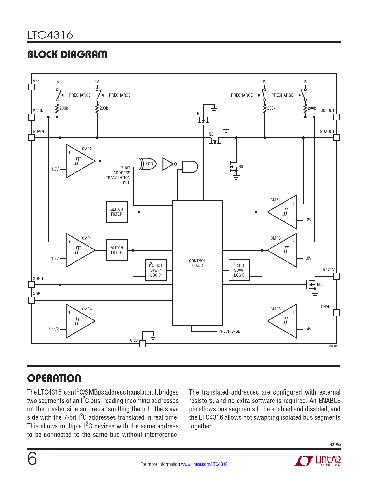

BLOCK DIAGRAM. OPERATION
BLOCK DIAGRAM OPERATION
LTC4316
BLOCK DIAGRAM
VCC 1V 1V 1V 1V PRECHARGE PRECHARGE PRECHARGE PRECHARGE 200k SCLIN 200k 200k 200k SCLOUT N1 SDAIN SDAOUT N2 CMP2 + XOR 7-BIT N3 1.8V – ADDRESS TRANSLATION BYTE CMP4 + GLITCH FILTER – 1.8V CMP1 CMP3 + + GLITCH FILTER 1.8V – – CONTROL 1.8V I2C HOT LOGIC I2C HOT SWAP SWAP READY LOGIC LOGIC XORH N4 XORL CMP6 CMP5 ENABLE + + VCC/2 – PRECHARGE – 1.4V GND 4316 BD
OPERATION
The LTC4316 is an I2C/SMBus address translator. It bridges The translated addresses are configured with external two segments of an I2C bus, reading incoming addresses resistors, and no extra software is required. An ENABLE on the master side and retransmitting them to the slave pin allows bus segments to be enabled and disabled, and side with the 7-bit I2C addresses translated in real time. the LTC4316 allows hot swapping isolated bus segments This allows multiple I2C devices with the same address together. to be connected to the same bus without interference. 4316fa 6 For more information www.linear.com/LTC4316
