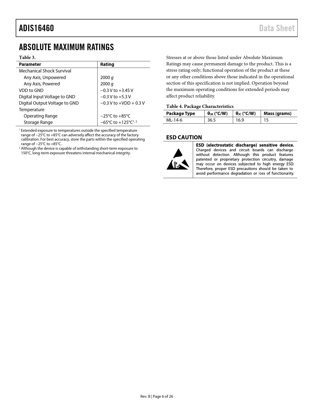

ADIS16460. Data Sheet. ABSOLUTE MAXIMUM RATINGS Table 3. Parameter. Rating. Table 4. Package Characteristics. Package Type. JA (°C/W)
ADIS16460 Data Sheet ABSOLUTE MAXIMUM RATINGS Table 3 Parameter Rating Table 4 Package Characteristics Package Type JA (°C/W)
ADIS16460 Data Sheet ABSOLUTE MAXIMUM RATINGS Table 3.
Stresses at or above those listed under Absolute Maximum
Parameter Rating
Ratings may cause permanent damage to the product. This is a Mechanical Shock Survival stress rating only; functional operation of the product at these Any Axis, Unpowered 2000 g or any other conditions above those indicated in the operational Any Axis, Powered 2000 g section of this specification is not implied. Operation beyond VDD to GND −0.3 V to +3.45 V the maximum operating conditions for extended periods may Digital Input Voltage to GND −0.3 V to +5.3 V affect product reliability. Digital Output Voltage to GND −0.3 V to +VDD + 0.3 V
Temperature
Package Type θ
Operating Range −25°C to +85°C
JA (°C/W) θJC (°C/W) Mass (grams)
Storage Range −65°C to +125°C1, 2 ML-14-6 36.5 16.9 15 1 Extended exposure to temperatures outside the specified temperature range of −25°C to +85°C can adversely affect the accuracy of the factory calibration. For best accuracy, store the parts within the specified operating
ESD CAUTION
range of −25°C to +85°C. 2 Although the device is capable of withstanding short-term exposure to 150°C, long-term exposure threatens internal mechanical integrity. Rev. B | Page 6 of 26 Document Outline FEATURES APPLICATIONS GENERAL DESCRIPTION FUNCTIONAL BLOCK DIAGRAM TABLE OF CONTENTS REVISION HISTORY SPECIFICATIONS TIMING SPECIFICATIONS Timing Diagrams ABSOLUTE MAXIMUM RATINGS ESD CAUTION PIN CONFIGURATION AND FUNCTION DESCRIPTIONS TYPICAL PERFORMANCE CHARACTERISTICS THEORY OF OPERATION READING SENSOR DATA Burst Read Function SPI Read Test Sequence DEVICE CONFIGURATION Dual Memory Structure USER REGISTERS OUTPUT DATA REGISTERS ROTATION Angular Rate Data Delta Angle Data ACCELEROMETERS Linear Acceleration Delta Velocity Data INTERNAL TEMPERATURE PRODUCT IDENTIFICATION STATUS/ERROR FLAGS Manual Flash Update SPI Communication Failure Sensor Overrange Self Test Failure Flash Test Failure Input Clock Sync Failure SYSTEM FUNCTIONS GLOBAL COMMANDS SOFTWARE RESET FLASH MEMORY TEST MANUAL FLASH UPDATE AUTOMATED SELF TEST INPUT/OUTPUT CONFIGURATION DATA READY (DR) PIN CONFIGURATION SYNC PIN CONFIGURATION Sample Time Indicator Precision Input Sync with Data Counter Direct Sample Control DIGITAL PROCESSING CONFIGURATION GYROSCOPES/ACCELEROMETERS Digital Filtering CALIBRATION GYROSCOPES Gyroscope Bias Error Estimation Gyroscope Bias Correction Factors Single Command Bias Correction ACCELEROMETERS Accelerometer Bias Error Estimation Accelerometer Bias Correction Factors Point of Percussion Alignment RESTORING FACTORY CALIBRATION APPLICATIONS INFORMATION MOUNTING TIPS POWER SUPPLY CONSIDERATIONS BREAKOUT BOARD PC-BASED EVALUATION TOOLS Estimating the Number of Relevant Bits OUTLINE DIMENSIONS ORDERING GUIDE
