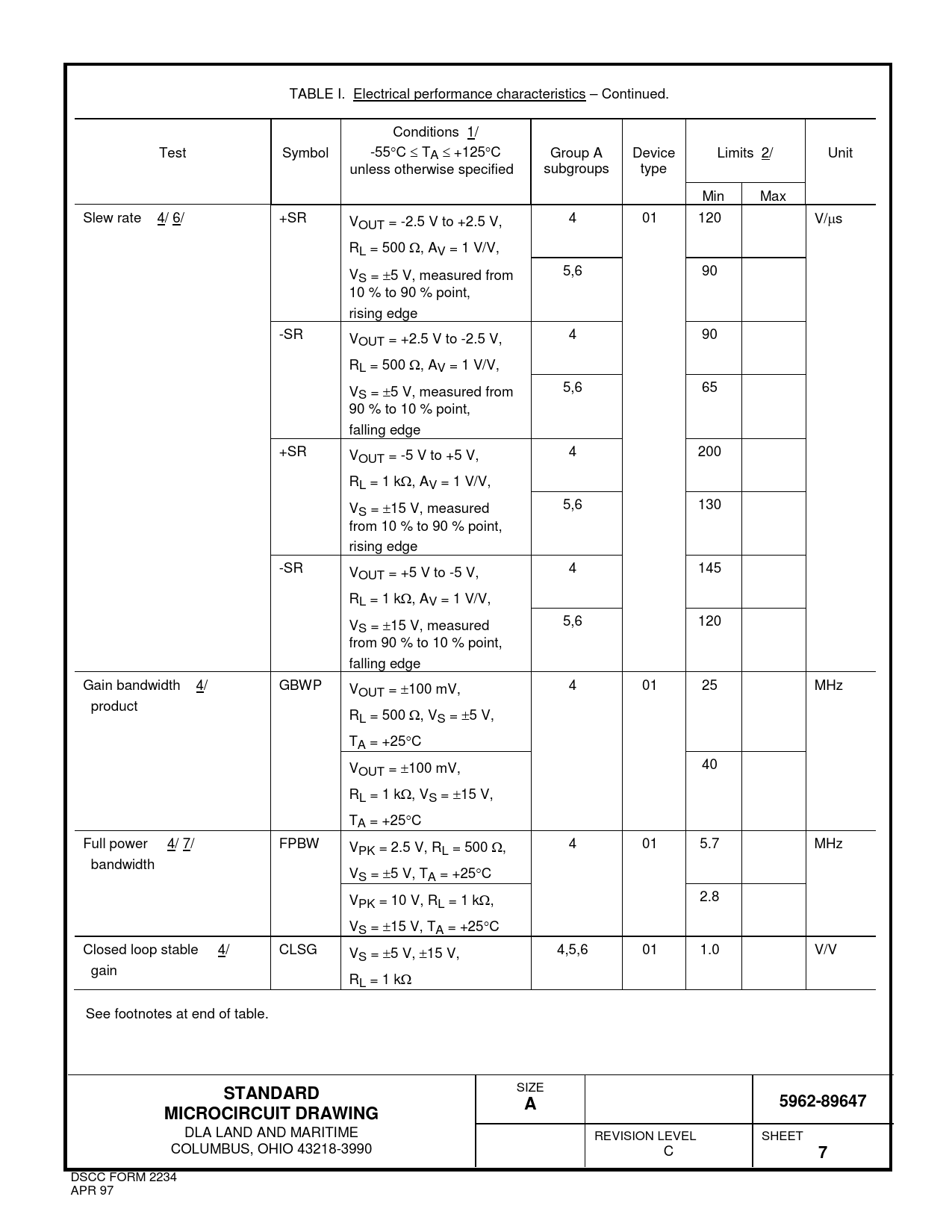

STANDARD. 5962-89647. MICROCIRCUIT DRAWING
STANDARD 5962-89647 MICROCIRCUIT DRAWING
TABLE I. Electrical performance characteristics – Continued. Conditions 1/ Test Symbol -55°C ≤ TA ≤ +125°C Group A Device Limits 2/ Unit unless otherwise specified subgroups type Min Max Slew rate 4/ 6/ +SR V 4 01 120 V/µs OUT = -2.5 V to +2.5 V, RL = 500 Ω, AV = 1 V/V, V 5,6 90 S = ±5 V, measured from 10 % to 90 % point, rising edge -SR V 4 90 OUT = +2.5 V to -2.5 V, RL = 500 Ω, AV = 1 V/V, V 5,6 65 S = ±5 V, measured from 90 % to 10 % point, falling edge +SR V 4 200 OUT = -5 V to +5 V, RL = 1 kΩ, AV = 1 V/V, V 5,6 130 S = ±15 V, measured from 10 % to 90 % point, rising edge -SR V 4 145 OUT = +5 V to -5 V, RL = 1 kΩ, AV = 1 V/V, V 5,6 120 S = ±15 V, measured from 90 % to 10 % point, falling edge Gain bandwidth 4/ GBWP V 4 01 25 MHz OUT = ±100 mV, product RL = 500 Ω, VS = ±5 V, TA = +25°C V 40 OUT = ±100 mV, RL = 1 kΩ, VS = ±15 V, TA = +25°C Full power 4/ 7/ FPBW V 4 01 5.7 MHz PK = 2.5 V, RL = 500 Ω, bandwidth VS = ±5 V, TA = +25°C V 2.8 PK = 10 V, RL = 1 kΩ, VS = ±15 V, TA = +25°C Closed loop stable 4/ CLSG V 4,5,6 01 1.0 V/V S = ±5 V, ±15 V, gain RL = 1 kΩ See footnotes at end of table.
