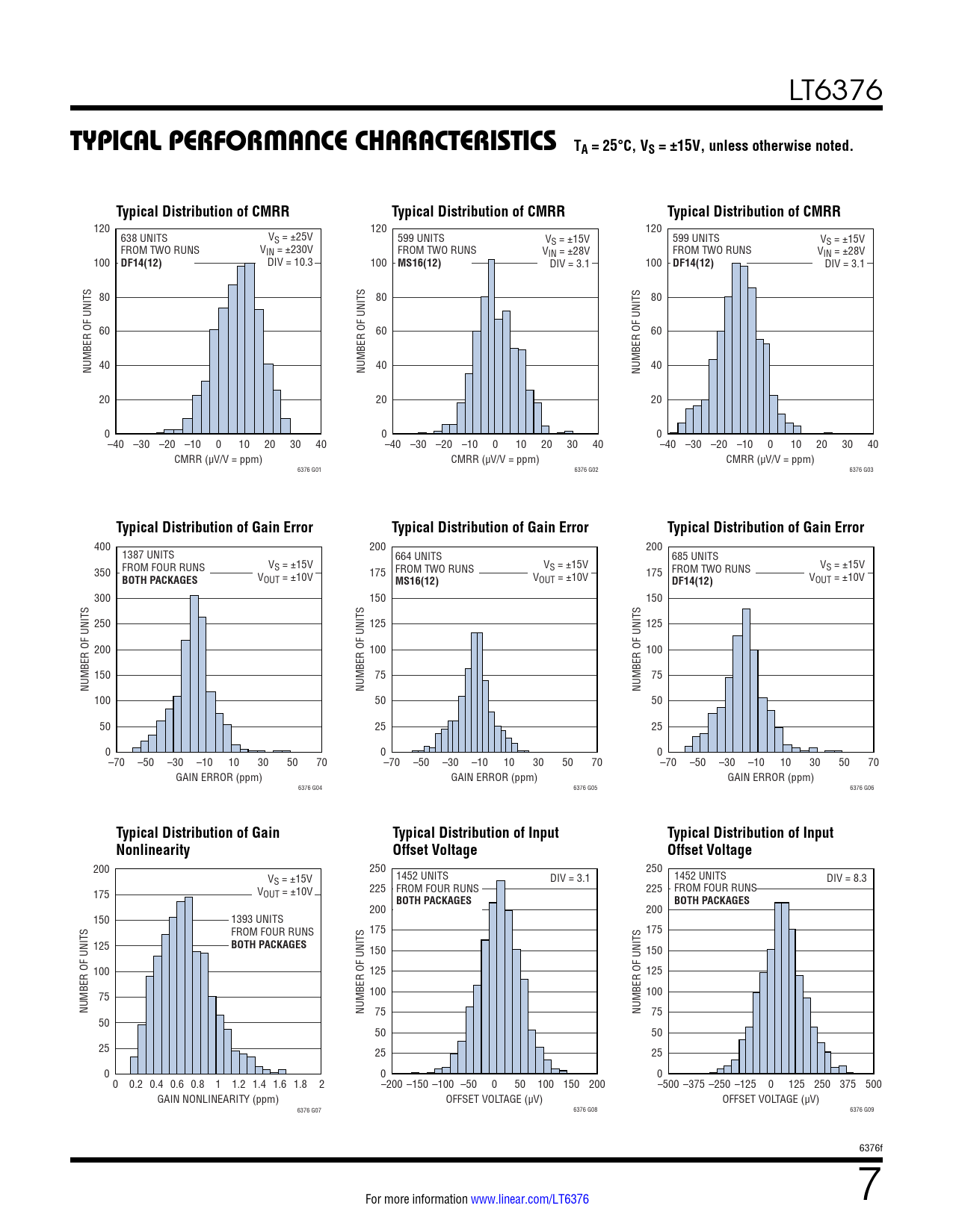

Datasheet LT6376 (Analog Devices) - 7
Description±230V Common Mode Voltage G = 10 Difference Amplifier
Pages / Page30 / 7 — TYPICAL PERFORMANCE CHARACTERISTICS TA = 25°C, VS = ±15V, unless …
TYPICAL PERFORMANCE CHARACTERISTICS TA = 25°C, VS = ±15V, unless otherwise noted. Typical Distribution of CMRR. DF14(12)
TYPICAL PERFORMANCE CHARACTERISTICS TA = 25°C, VS = ±15V, unless otherwise noted Typical Distribution of CMRR DF14(12)
LT6376
TYPICAL PERFORMANCE CHARACTERISTICS TA = 25°C, VS = ±15V, unless otherwise noted. Typical Distribution of CMRR Typical Distribution of CMRR Typical Distribution of CMRR
120 120 120 638 UNITS VS = ±25V 599 UNITS VS = ±15V 599 UNITS VS = ±15V FROM TWO RUNS VIN = ±230V FROM TWO RUNS VIN = ±28V FROM TWO RUNS VIN = ±28V 100
DF14(12)
DIV = 10.3 100
MS16(12)
DIV = 3.1 100
DF14(12)
DIV = 3.1 80 80 80 60 60 60 40 NUMBER OF UNITS 40 NUMBER OF UNITS 40 NUMBER OF UNITS 20 20 20 0 0 0 –40 –30 –20 –10 0 10 20 30 40 –40 –30 –20 –10 0 10 20 30 40 –40 –30 –20 –10 0 10 20 30 40 CMRR (µV/V = ppm) CMRR (µV/V = ppm) CMRR (µV/V = ppm) 6376 G01 6376 G02 6376 G03
Typical Distribution of Gain Error Typical Distribution of Gain Error Typical Distribution of Gain Error
400 200 200 1387 UNITS 664 UNITS 685 UNITS FROM FOUR RUNS VS = ±15V V V 350 FROM TWO RUNS S = ±15V 175 FROM TWO RUNS S = ±15V 175
BOTH PACKAGES
VOUT = ±10V
MS16(12)
VOUT = ±10V
DF14(12)
VOUT = ±10V 300 150 150 250 125 125 200 100 100 150 75 75 NUMBER OF UNITS NUMBER OF UNITS NUMBER OF UNITS 100 50 50 50 25 25 0 0 0 –70 –50 –30 –10 10 30 50 70 –70 –50 –30 –10 10 30 50 70 –70 –50 –30 –10 10 30 50 70 GAIN ERROR (ppm) GAIN ERROR (ppm) GAIN ERROR (ppm) 6376 G04 6376 G05 6376 G06
Typical Distribution of Gain Typical Distribution of Input Typical Distribution of Input Nonlinearity Offset Voltage Offset Voltage
200 250 250 1452 UNITS V DIV = 3.1 1452 UNITS DIV = 8.3 S = ±15V V 225 FROM FOUR RUNS 225 FROM FOUR RUNS 175 OUT = ±10V
BOTH PACKAGES BOTH PACKAGES
200 200 150 1393 UNITS FROM FOUR RUNS 175 175 125
BOTH PACKAGES
150 150 100 125 125 100 100 75 NUMBER OF UNITS NUMBER OF UNITS 75 NUMBER OF UNITS 75 50 50 50 25 25 25 0 0 0 0 0.2 0.4 0.6 0.8 1 1.2 1.4 1.6 1.8 2 –200 –150 –100 –50 0 50 100 150 200 –500 –375 –250 –125 0 125 250 375 500 GAIN NONLINEARITY (ppm) OFFSET VOLTAGE (µV) OFFSET VOLTAGE (µV) 6376 G07 6376 G08 6376 G09 6376f For more information www.linear.com/LT6376 7 Document Outline FEATURES DESCRIPTION APPLICATIONS TYPICAL APPLICATION ABSOLUTE MAXIMUM RATINGS PIN CONFIGURATION ORDER INFORMATION E LECTRICAL CHARACTERISTICS TYPICAL PERFORMANCE CHARACTERISTICS PIN FUNCTIONS BLOCK DIAGRAM APPLICATIONS INFORMATION TYPICAL APPLICATIONS PACKAGE DESCRIPTION TYPICAL APPLICATION RELATED PARTS
