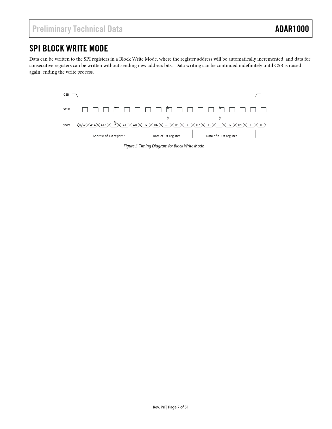

Preliminary Technical Data. ADAR1000. SPI BLOCK WRITE MODE
Preliminary Technical Data ADAR1000 SPI BLOCK WRITE MODE
Data can be written to the SPI registers in a Block Write Mode, where the register address will be automatically incremented, and data for consecutive registers can be written without sending new address bits. Data writing can be continued indefinitely until CSB is raised again, ending the write process. Figure 5 Timing Diagram for Block Write Mode Rev. PrF| Page 7 of 51 Document Outline Features Applications General Description Functional Block Diagram Specifications Timing Specifications Timing Diagram SPI Block Write Mode Absolute Maximum Ratings ESD Caution Pin Configuration and Function Descriptions Typical Performance Characteristics Theory of Operation Changes from Previous Silicon Revision T/R switch driver output External PA and LNA bias DACs Eliminated the -3.3V supply input to the chip New PA_ON input pin Applications Gain Control Registers Switched Attenuator Control TR_SW_POS and TR_SW_NEG (T/R Switch Control) TX/RX Subcircuit Control TR_SOURCE = 0 SPI Programming Example Register Maps Address: 0x000, Reset: 0x00, Name: INTERFACE_CONFIG_A Outline Dimensions
