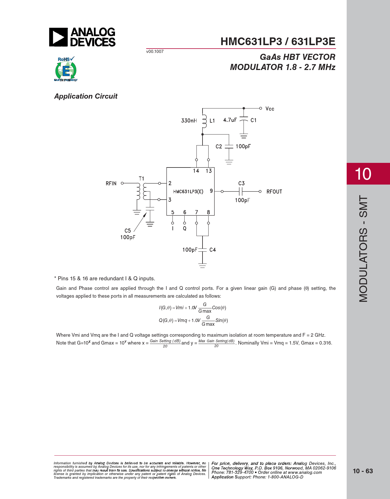

GaAs HBT VECTOR MODULATOR 1.8 - 2.7 MHz Application Circuit
10 T - SM S R O T A L U * Pins 15 & 16 are redundant I & Q inputs. Gain and Phase control are applied through the I and Q control ports. For a given linear gain (G) and phase (θ) setting, the voltages applied to these ports in all measurements are calculated as follows: MOD G I G ( ,θ ) =Vmi + 1. V 0 Cos(θ ) G max G Q G ( ,θ ) =Vmq + 1. V 0 Sin(θ ) G max Where Vmi and Vmq are the I and Q voltage settings corresponding to maximum isolation at room temperature and F = 2 GHz. Gain Setting dB ( ) Note that G=10
X
and Gmax = 10
Y
where x = and y = . N Max G ain Setting ( dB) ominally Vmi = Vmq = 1.5V, Gmax = 0.316. 20 20 Information furnishe F d o b r pr y Analic o e g , D d evi e ce li s v i e s brey li , a eve n d t d to p o be acc luac rat e o e an r d d rele ia rs ble , p . Hole we a ves r, e n c o ont Fo ac r p t H rice i, tt dit ele M iveryic , r a owa nd to ve C plac o e r o p rdo e r r at s: i Ao n n al:og Devices, Inc., responsibility is assumed by Analog Devices for its use, nor for any infringements of patents or other 20 Alpha Road, Chelmsford, MA 01824 Phone One Technology Way, P.O. Box 9106, Norwood, MA 02062-9106 rights of third parties that may result from its use. Specifications subject to change without notice. No : 978-250-3343 Fax: 978-250-3373 license is granted by implication or otherwise under any patent or patent rights of Analog Devices. Phone: 781-329-4700 • Order online at www.analog.com
