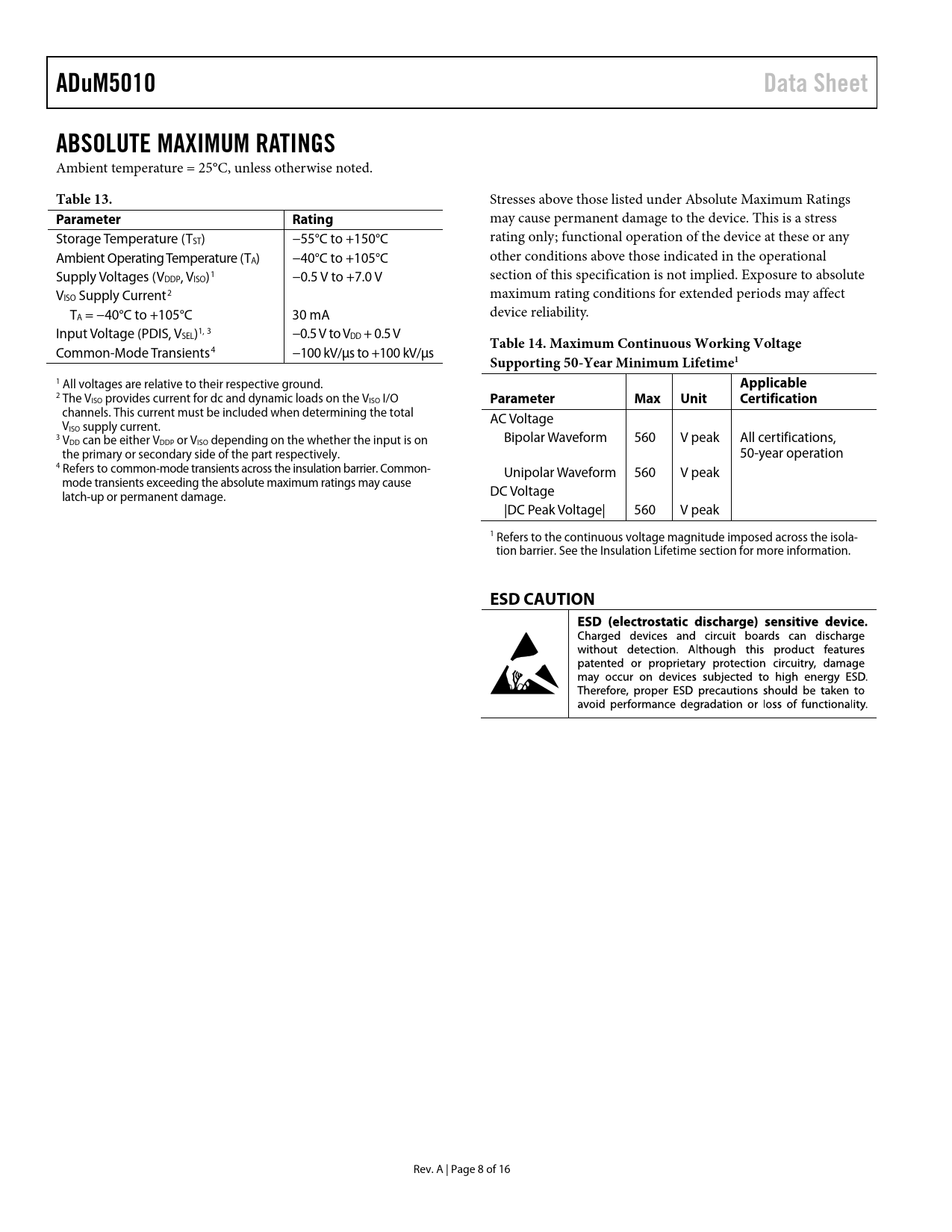

ADuM5010. Data Sheet. ABSOLUTE MAXIMUM RATINGS. Table 13. Parameter. Rating. Table 14. Maximum Continuous Working Voltage
ADuM5010 Data Sheet ABSOLUTE MAXIMUM RATINGS Table 13 Parameter Rating Table 14 Maximum Continuous Working Voltage
link to page 13 link to page 8 link to page 8 link to page 8 link to page 8 link to page 8
Ambient temperature = 25°C, unless otherwise noted.
Table 13.
Stresses above those listed under Absolute Maximum Ratings
Parameter Rating
may cause permanent damage to the device. This is a stress Storage Temperature (TST) −55°C to +150°C rating only; functional operation of the device at these or any Ambient Operating Temperature (TA) −40°C to +105°C other conditions above those indicated in the operational Supply Voltages (VDDP, VISO)1 −0.5 V to +7.0 V section of this specification is not implied. Exposure to absolute VISO Supply Current2 maximum rating conditions for extended periods may affect TA = −40°C to +105°C 30 mA device reliability. Input Voltage (PDIS, VSEL)1, 3 −0.5 V to VDD + 0.5 V
Common-Mode Transients4 −100 kV/µs to +100 kV/µs
Supporting 50-Year Minimum Lifetime1
1 All voltages are relative to their respective ground.
Applicable
2 The VISO provides current for dc and dynamic loads on the VISO I/O
Parameter Max Unit Certification
channels. This current must be included when determining the total AC Voltage VISO supply current. 3 V Bipolar Waveform 560 V peak DD can be either VDDP or VISO depending on the whether the input is on All certifications, the primary or secondary side of the part respectively. 50-year operation 4 Refers to common-mode transients across the insulation barrier. Common- Unipolar Waveform 560 V peak mode transients exceeding the absolute maximum ratings may cause latch-up or permanent damage. DC Voltage |DC Peak Voltage| 560 V peak 1 Refers to the continuous voltage magnitude imposed across the isola- tion barrier. See the Insulation Lifetime section for more information.
