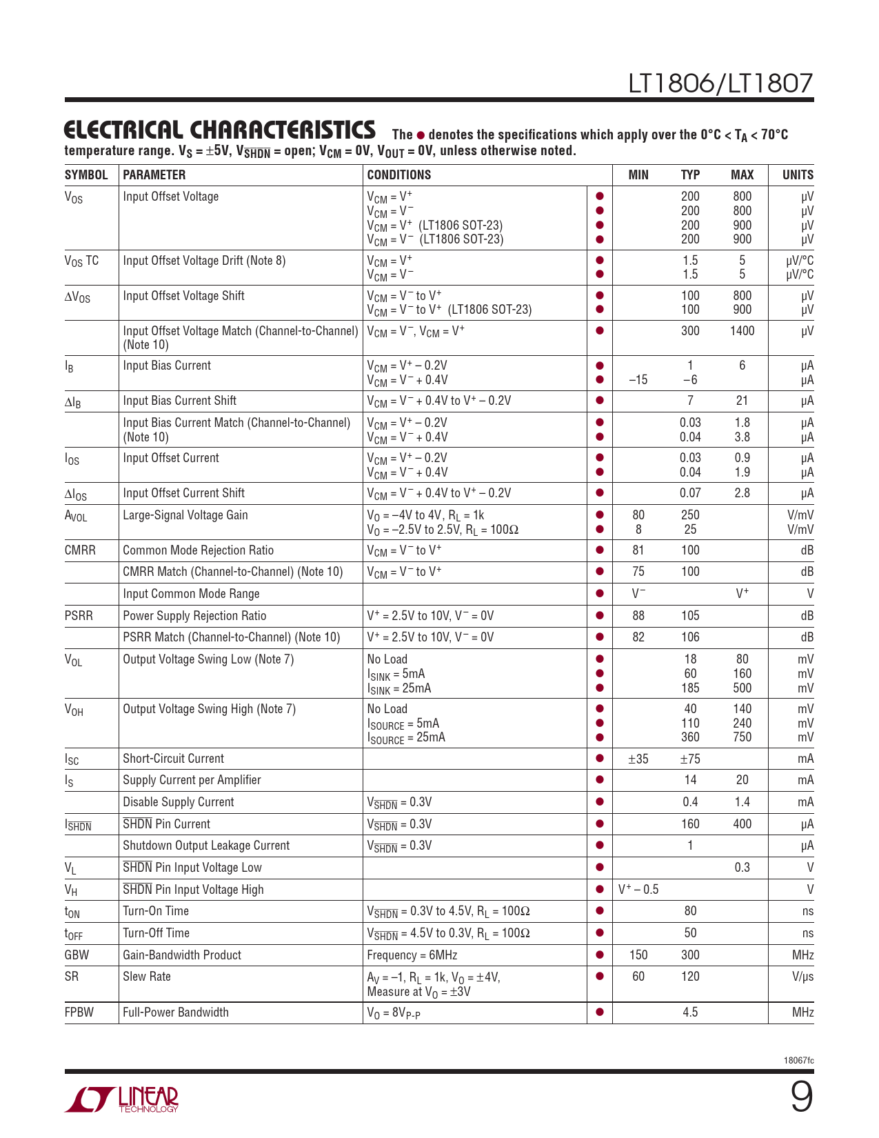

ELECTRICAL CHARACTERISTICS. denotes the specifi cations which apply over the 0°C < TA < 70°C. temperature range. VS =
ELECTRICAL CHARACTERISTICS denotes the specifi cations which apply over the 0°C < TA < 70°C temperature range VS =
LT1806/LT1807
Th ELECTRICAL CHARACTERISTICS e
l
denotes the specifi cations which apply over the 0°C < TA < 70°C temperature range. VS =
5V, VSHDN = open; VCM = 0V, VOUT = 0V, unless otherwise noted. SYMBOL PARAMETER CONDITIONS MIN TYP MAX UNITS
VOS Input Offset Voltage VCM = V+ l 200 800 μV VCM = V – l 200 800 μV VCM = V+ (LT1806 SOT-23) l 200 900 μV VCM = V – (LT1806 SOT-23) l 200 900 μV VOS TC Input Offset Voltage Drift (Note 8) VCM = V+ l 1.5 5 μV/°C VCM = V – l 1.5 5 μV/°C ΔV l OS Input Offset Voltage Shift VCM = V – to V+ 100 800 μV VCM = V – to V+ (LT1806 SOT-23) l 100 900 μV Input Offset Voltage Match (Channel-to-Channel) VCM = V –, VCM = V+ l 300 1400 μV (Note 10) IB Input Bias Current VCM = V+ – 0.2V l 1 6 μA VCM = V – + 0.4V l –15 – 6 μA ΔIB Input Bias Current Shift VCM = V – + 0.4V to V+ – 0.2V l 7 21 μA Input Bias Current Match (Channel-to-Channel) VCM = V+ – 0.2V l 0.03 1.8 μA (Note 10) VCM = V – + 0.4V l 0.04 3.8 μA IOS Input Offset Current VCM = V+ – 0.2V l 0.03 0.9 μA VCM = V – + 0.4V l 0.04 1.9 μA ΔIOS Input Offset Current Shift VCM = V – + 0.4V to V+ – 0.2V l 0.07 2.8 μA AVOL Large-Signal Voltage Gain VO = –4V to 4V, RL = 1k l 80 250 V/mV VO = –2.5V to 2.5V, RL = 100Ω l 8 25 V/mV CMRR Common Mode Rejection Ratio VCM = V – to V+ l 81 100 dB CMRR Match (Channel-to-Channel) (Note 10) VCM = V – to V+ l 75 100 dB Input Common Mode Range l V – V+ V PSRR Power Supply Rejection Ratio V+ = 2.5V to 10V, V – = 0V l 88 105 dB PSRR Match (Channel-to-Channel) (Note 10) V+ = 2.5V to 10V, V – = 0V l 82 106 dB VOL Output Voltage Swing Low (Note 7) No Load l 18 80 mV ISINK = 5mA l 60 160 mV ISINK = 25mA l 185 500 mV VOH Output Voltage Swing High (Note 7) No Load l 40 140 mV ISOURCE = 5mA l 110 240 mV ISOURCE = 25mA l 360 750 mV ISC Short-Circuit Current l ±35 ±75 mA IS Supply Current per Amplifi er l 14 20 mA Disable Supply Current VSHDN = 0.3V l 0.4 1.4 mA ISHDN SHDN Pin Current VSHDN = 0.3V l 160 400 μA Shutdown Output Leakage Current VSHDN = 0.3V l 1 μA VL SHDN Pin Input Voltage Low l 0.3 V VH SHDN Pin Input Voltage High l V+ – 0.5 V tON Turn-On Time VSHDN = 0.3V to 4.5V, RL = 100Ω l 80 ns tOFF Turn-Off Time VSHDN = 4.5V to 0.3V, RL = 100Ω l 50 ns GBW Gain-Bandwidth Product Frequency = 6MHz l 150 300 MHz SR Slew Rate A l V = –1, RL = 1k, VO = ± 4V, 60 120 V/μs Measure at VO = ±3V FPBW Full-Power Bandwidth VO = 8VP-P l 4.5 MHz 18067fc 9
