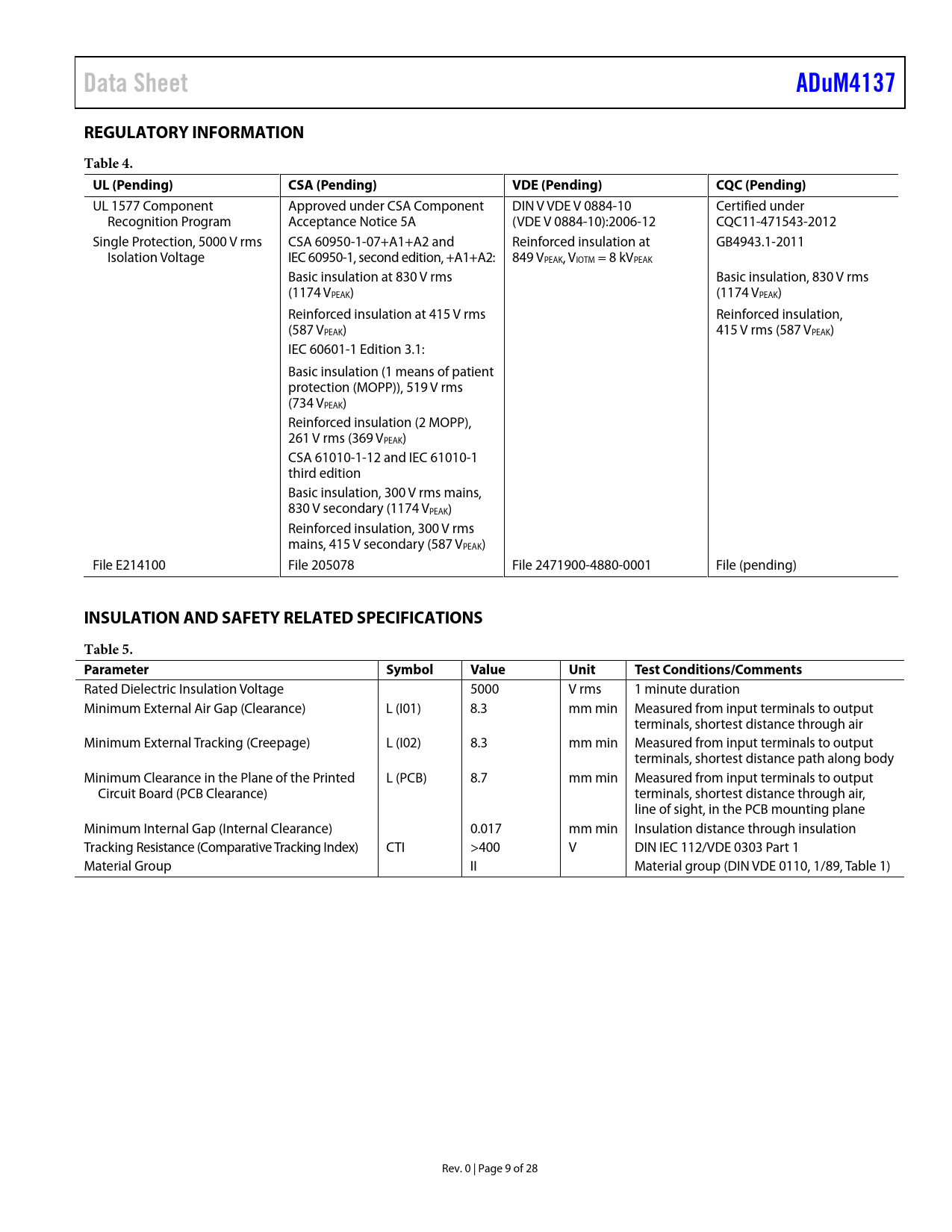

Data Sheet. ADuM4137. REGULATORY INFORMATION. Table 4. UL (Pending). CSA (Pending). VDE (Pending). CQC (Pending)
Data Sheet ADuM4137 REGULATORY INFORMATION Table 4 UL (Pending) CSA (Pending) VDE (Pending) CQC (Pending)
Data Sheet ADuM4137 REGULATORY INFORMATION Table 4. UL (Pending) CSA (Pending) VDE (Pending) CQC (Pending)
UL 1577 Component Approved under CSA Component DIN V VDE V 0884-10 Certified under Recognition Program Acceptance Notice 5A (VDE V 0884-10):2006-12 CQC11-471543-2012 Single Protection, 5000 V rms CSA 60950-1-07+A1+A2 and Reinforced insulation at GB4943.1-2011 Isolation Voltage IEC 60950-1, second edition, +A1+A2: 849 VPEAK, VIOTM = 8 kVPEAK Basic insulation at 830 V rms Basic insulation, 830 V rms (1174 VPEAK) (1174 VPEAK) Reinforced insulation at 415 V rms Reinforced insulation, (587 VPEAK) 415 V rms (587 VPEAK) IEC 60601-1 Edition 3.1: Basic insulation (1 means of patient protection (MOPP)), 519 V rms (734 VPEAK) Reinforced insulation (2 MOPP), 261 V rms (369 VPEAK) CSA 61010-1-12 and IEC 61010-1 third edition Basic insulation, 300 V rms mains, 830 V secondary (1174 VPEAK) Reinforced insulation, 300 V rms mains, 415 V secondary (587 VPEAK) File E214100 File 205078 File 2471900-4880-0001 File (pending)
INSULATION AND SAFETY RELATED SPECIFICATIONS Table 5. Parameter Symbol Value Unit Test Conditions/Comments
Rated Dielectric Insulation Voltage 5000 V rms 1 minute duration Minimum External Air Gap (Clearance) L (I01) 8.3 mm min Measured from input terminals to output terminals, shortest distance through air Minimum External Tracking (Creepage) L (I02) 8.3 mm min Measured from input terminals to output terminals, shortest distance path along body Minimum Clearance in the Plane of the Printed L (PCB) 8.7 mm min Measured from input terminals to output Circuit Board (PCB Clearance) terminals, shortest distance through air, line of sight, in the PCB mounting plane Minimum Internal Gap (Internal Clearance) 0.017 mm min Insulation distance through insulation Tracking Resistance (Comparative Tracking Index) CTI >400 V DIN IEC 112/VDE 0303 Part 1 Material Group II Material group (DIN VDE 0110, 1/89, Table 1) Rev. 0 | Page 9 of 28 Document Outline FEATURES APPLICATIONS GENERAL DESCRIPTION TABLE OF CONTENTS REVISION HISTORY FUNCTIONAL BLOCK DIAGRAM SPECIFICATIONS ELECTRICAL CHARACTERISTICS SPI TIMING SPECIFICATIONS SPI Timing Diagram PACKAGE CHARACTERISTICS REGULATORY INFORMATION INSULATION AND SAFETY RELATED SPECIFICATIONS DIN V VDE V 0884-10 (VDE V 0884-10) INSULATION CHARACTERISTICS RECOMMENDED OPERATING CONDITIONS ABSOLUTE MAXIMUM RATINGS THERMAL RESISTANCE ESD CAUTION PIN CONFIGURATION AND FUNCTION DESCRIPTIONS TYPICAL PERFORMANCE CHARACTERISTICS THEORY OF OPERATION APPLICATIONS INFORMATION PCB LAYOUT SPI AND EEPROM OPERATION SPI Programming USER REGISTER MAP USER REGISTER BITS OFFSET_2[5:0] Bits GAIN_2[5:0] Bits OFFSET_1[5:0] Bits GAIN_1[5:0] Bits CONFIGURATION REGISTER BITS OT_FAULT_OP Bit OT_FAULT_SEL Bit OC_TIME_OP Bit OC_2LEV_OP Bit LOW_T_OP Bit OC_BLANK_OP Bit tBLANK[3:0] Bits ECC_OFF_OP Bit T_RAMP_OP Bit PWM_OSC CONTROL REGISTER BITS ECC2_DBL_ERR Bit ECC2_SNG_ERR Bit ECC1_DBL_ERR Bit ECC1_SNG_ERR Bit PROG_BUSY Bit SIM_TRIM Bit SPI SAFETY PROPAGATION DELAY RELATED PARAMETERS PROTECTION FEATURES Primary Side UVLO Fault Reporting Overcurrent Detection High Speed, Two-Level Turn Off Miller Clamp Thermal Shutdown ASC Pin Functionality Isolated Temperature Sensor Low Temperature Operation Mode FAULTB Pin DRIVER_FAULTB Pin UVLO_FAULTB Pin VDD2 UVLO Fault UVLO_FAULTB Fault, Gate Low Dead Time Control DRIVER_FAULTB Fault, Dead Time Fault Power Dissipation INSULATION LIFETIME DC CORRECTNESS AND MAGNETIC FIELD IMMUNITY TYPICAL APPLICATION CIRCUIT OUTLINE DIMENSIONS ORDERING GUIDE AUTOMOTIVE PRODUCTS
