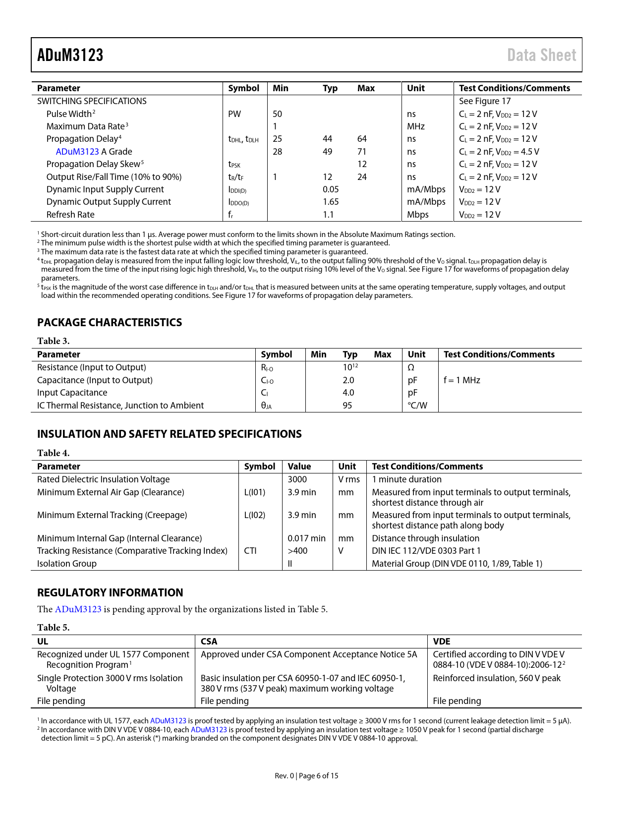

ADuM3123. Data Sheet. Parameter. Symbol. Min. Typ. Max. Unit. Test Conditions/Comments. PACKAGE CHARACTERISTICS Table 3. Parameter
ADuM3123 Data Sheet Parameter Symbol Min Typ Max Unit Test Conditions/Comments PACKAGE CHARACTERISTICS Table 3 Parameter
link to page 12 link to page 8 link to page 12 link to page 12 link to page 6 link to page 8
SWITCHING SPECIFICATIONS See Figure 17 Pulse Width2 PW 50 ns CL = 2 nF, VDD2 = 12 V Maximum Data Rate3 1 MHz CL = 2 nF, VDD2 = 12 V Propagation Delay4 tDHL, tDLH 25 44 64 ns CL = 2 nF, VDD2 = 12 V ADuM3123 A Grade 28 49 71 ns CL = 2 nF, VDD2 = 4.5 V Propagation Delay Skew5 tPSK 12 ns CL = 2 nF, VDD2 = 12 V Output Rise/Fall Time (10% to 90%) tR/tF 1 12 24 ns CL = 2 nF, VDD2 = 12 V Dynamic Input Supply Current IDDI(D) 0.05 mA/Mbps VDD2 = 12 V Dynamic Output Supply Current IDDO(D) 1.65 mA/Mbps VDD2 = 12 V Refresh Rate fr 1.1 Mbps VDD2 = 12 V 1 Short-circuit duration less than 1 µs. Average power must conform to the limits shown in the Absolute Maximum Ratings section. 2 The minimum pulse width is the shortest pulse width at which the specified timing parameter is guaranteed. 3 The maximum data rate is the fastest data rate at which the specified timing parameter is guaranteed. 4 tDHL propagation delay is measured from the input falling logic low threshold, VIL, to the output falling 90% threshold of the VO signal. tDLH propagation delay is measured from the time of the input rising logic high threshold, VIH, to the output rising 10% level of the VO signal. See Figure 17 for waveforms of propagation delay parameters. 5 tPSK is the magnitude of the worst case difference in tDLH and/or tDHL that is measured between units at the same operating temperature, supply voltages, and output load within the recommended operating conditions. See Figure 17 for waveforms of propagation delay parameters.
PACKAGE CHARACTERISTICS Table 3. Parameter Symbol Min Typ Max Unit Test Conditions/Comments
Resistance (Input to Output) RI-O 1012 Ω Capacitance (Input to Output) CI-O 2.0 pF f = 1 MHz Input Capacitance CI 4.0 pF IC Thermal Resistance, Junction to Ambient θJA 95 °C/W
INSULATION AND SAFETY RELATED SPECIFICATIONS Table 4. Parameter Symbol Value Unit Test Conditions/Comments
Rated Dielectric Insulation Voltage 3000 V rms 1 minute duration Minimum External Air Gap (Clearance) L(I01) 3.9 min mm Measured from input terminals to output terminals, shortest distance through air Minimum External Tracking (Creepage) L(I02) 3.9 min mm Measured from input terminals to output terminals, shortest distance path along body Minimum Internal Gap (Internal Clearance) 0.017 min mm Distance through insulation Tracking Resistance (Comparative Tracking Index) CTI >400 V DIN IEC 112/VDE 0303 Part 1 Isolation Group II Material Group (DIN VDE 0110, 1/89, Table 1)
REGULATORY INFORMATION
The ADuM3123 is pending approval by the organizations listed in Table 5.
Table 5. UL CSA VDE
Recognized under UL 1577 Component Approved under CSA Component Acceptance Notice 5A Certified according to DIN V VDE V Recognition Program1 0884-10 (VDE V 0884-10):2006-122 Single Protection 3000 V rms Isolation Basic insulation per CSA 60950-1-07 and IEC 60950-1, Reinforced insulation, 560 V peak Voltage 380 V rms (537 V peak) maximum working voltage File pending File pending File pending 1 In accordance with UL 1577, each ADuM3123 is proof tested by applying an insulation test voltage ≥ 3000 V rms for 1 second (current leakage detection limit = 5 µA). 2 In accordance with DIN V VDE V 0884-10, each ADuM3123 is proof tested by applying an insulation test voltage ≥ 1050 V peak for 1 second (partial discharge detection limit = 5 pC). An asterisk (*) marking branded on the component designates DIN V VDE V 0884-10 approval. Rev. 0 | Page 6 of 15 Document Outline Features Applications General Description Functional Block Diagram Revision History Specifications Electrical Characteristics—5 V Operation Electrical Characteristics—3.3 V Operation Package Characteristics Insulation and Safety Related Specifications Regulatory Information DIN V VDE V 0884-10 (VDE V 0884-10) Insulation Characteristics Recommended Operating Conditions Absolute Maximum Ratings ESD Caution Pin Configuration and Function Descriptions Typical Performance Characteristics Applications Information Printed Circuit Board (PCB) Layout Propagation Delay Related Parameters Thermal Limitations and Switch Load Characteristics Output Load Characteristics DC Correctness and Magnetic Field Immunity Power Consumption Insulation Lifetime Outline Dimensions Ordering Guide
