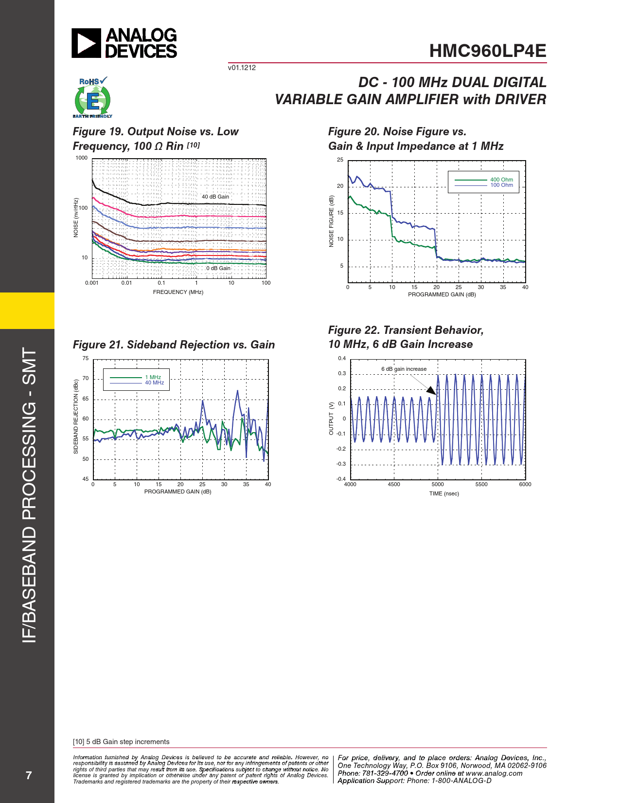

HMC960LP4E. DC - 100 MHz DUAL DigitAL. VAriAbLe gAin AMpLifier with DriVer. figure 19. Output noise vs. Low
HMC960LP4E DC - 100 MHz DUAL DigitAL VAriAbLe gAin AMpLifier with DriVer figure 19 Output noise vs Low
HMC960LP4E
v01.1212
DC - 100 MHz DUAL DigitAL VAriAbLe gAin AMpLifier with DriVer figure 19. Output noise vs. Low figure 20. noise figure vs. frequency, 100 Ω rin [10] gain & input impedance at 1 MHz
1000 25 400 Ohm 20 100 Ohm ) 40 dB Gain z B) tH (d 100 /r E v R 15 (n U E IG F OIS N ISE 10 O N 10 5 0 dB Gain 0.001 0.01 0.1 1 10 100 0 5 10 15 20 25 30 35 40 FREQUENCY (MHz) PROGRAMMED GAIN (dB)

figure 21. Sideband rejection vs. gain 10 MHz, 6 db gain increase
M 75 0.4 6 dB gain increase S 0.3 ) 70 1 MHz 40 MHz - Bc 0.2 (d N G 65 IO T 0.1 EC (V) T IN EJ 60 0 PU R T S D U O -0.1 55 S EBAN D -0.2 E SI 50 -0.3 C 45 -0.4 0 5 10 15 20 25 30 35 40 4000 4500 5000 5500 6000 PROGRAMMED GAIN (dB) RO TIME (nsec) P D N A B E S A IF/B [10] 5 dB Gain step increments Inf F or o m r p atio r n ifc ur e n , d ishe e d lbiv y e Anry a alog n D d t evic o p es is la be c liee o ved rd to e b r e sa: H ccur iattte itae M nd reliic a r bl o e. w H a o v wee C ver, o n rp o For price, delivery, and to place orders: Analog Devices, Inc., responsibility is assumed by Analog Devices for its use, nor for any infringements of patents or other oration, 2 Elizabeth Drive, Chelmsford, MA 01824 One Technology Way, P.O. Box 9106, Norwood, MA 02062-9106
