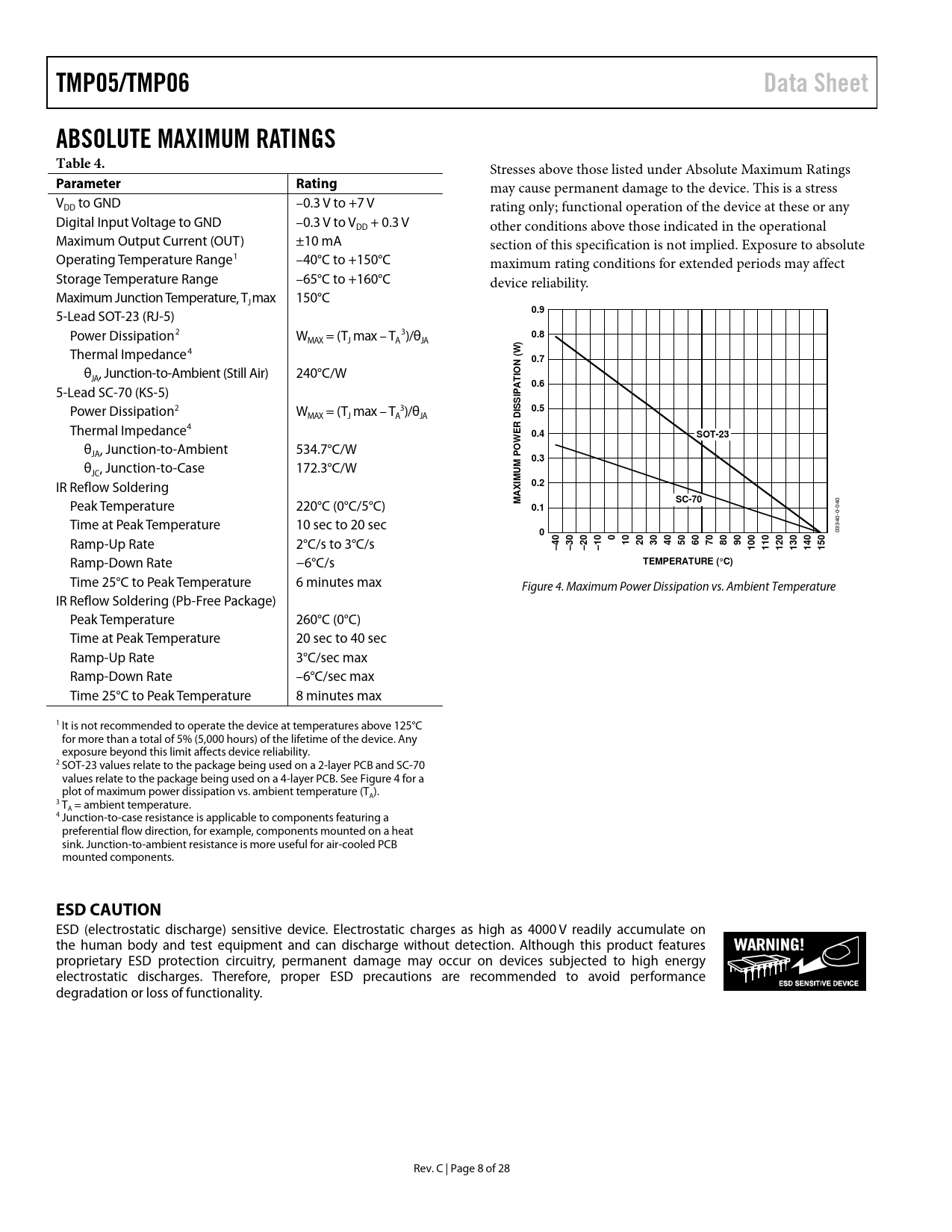

TMP05/TMP06 Data Sheet ABSOLUTE MAXIMUM RATINGS Table 4.
Stresses above those listed under Absolute Maximum Ratings
Parameter Rating
may cause permanent damage to the device. This is a stress V to GND –0.3 V to +7 V DD rating only; functional operation of the device at these or any Digital Input Voltage to GND –0.3 V to V + 0.3 V DD other conditions above those indicated in the operational Maximum Output Current (OUT) ±10 mA section of this specification is not implied. Exposure to absolute Operating Temperature Range1 –40°C to +150°C maximum rating conditions for extended periods may affect Storage Temperature Range –65°C to +160°C device reliability. Maximum Junction Temperature, T max 150°C J 5-Lead SOT-23 (RJ-5)
0.9
Power Dissipation2 W = (T max – T 3)/θ
0.8
MAX J A JA Thermal Impedance4
0.7
θ , Junction-to-Ambient (Still Air) 240°C/W JA
0.6
5-Lead SC-70 (KS-5) Power Dissipation2 W = (T max – T 3)/θ
0.5
0.4 SOT-23
θ , Junction-to-Ambient 534.7°C/W JA
0.3
θ , Junction-to-Case 172.3°C/W JC IR Reflow Soldering
0.2
Peak Temperature 220°C (0°C/5°C)
MAXIMUM POWER DISSIPATION (W) SC-70 0.1
Time at Peak Temperature 10 sec to 20 sec
0
03340-0-040 Ramp-Up Rate 2°C/s to 3°C/s
0 10 20 30 40 50 60 70 80 90 –40 –30 –20 –10 100 110 120 130 140 150
Ramp-Down Rate −6°C/s
TEMPERATURE (
C)
Time 25°C to Peak Temperature 6 minutes max Figure 4. Maximum Power Dissipation vs. Ambient Temperature IR Reflow Soldering (Pb-Free Package) Peak Temperature 260°C (0°C) Time at Peak Temperature 20 sec to 40 sec Ramp-Up Rate 3°C/sec max Ramp-Down Rate –6°C/sec max Time 25°C to Peak Temperature 8 minutes max 1 It is not recommended to operate the device at temperatures above 125°C for more than a total of 5% (5,000 hours) of the lifetime of the device. Any exposure beyond this limit affects device reliability. 2 SOT-23 values relate to the package being used on a 2-layer PCB and SC-70 values relate to the package being used on a 4-layer PCB. See Figure 4 for a plot of maximum power dissipation vs. ambient temperature (TA). 3 TA = ambient temperature. 4 Junction-to-case resistance is applicable to components featuring a preferential flow direction, for example, components mounted on a heat sink. Junction-to-ambient resistance is more useful for air-cooled PCB mounted components.
