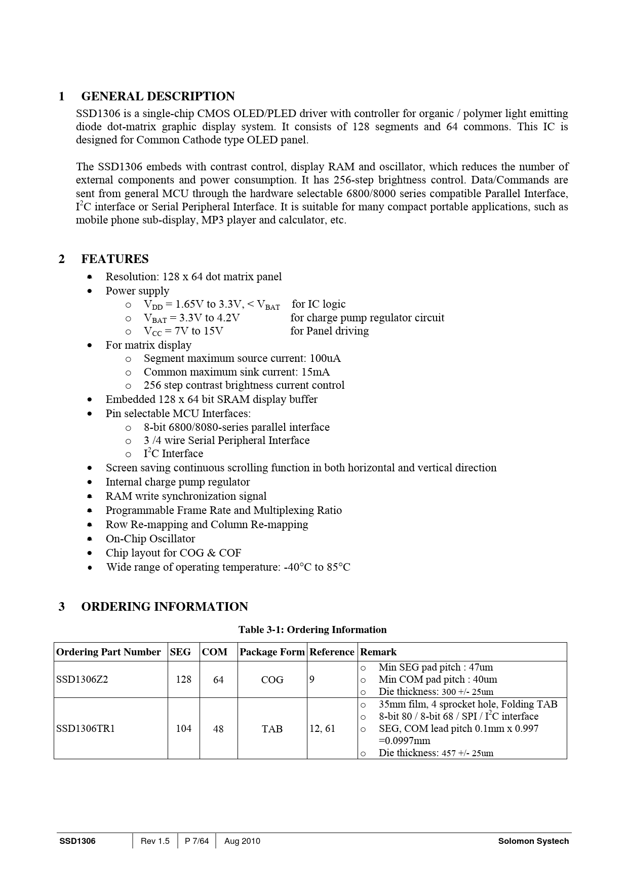

1 GENERAL DESCRIPTION
SSD1306 is a single-chip CMOS OLED/PLED driver with controller for organic / polymer light emitting diode dot-matrix graphic display system. It consists of 128 segments and 64 commons. This IC is designed for Common Cathode type OLED panel. The SSD1306 embeds with contrast control, display RAM and oscillator, which reduces the number of external components and power consumption. It has 256-step brightness control. Data/Commands are sent from general MCU through the hardware selectable 6800/8000 series compatible Parallel Interface, I2C interface or Serial Peripheral Interface. It is suitable for many compact portable applications, such as mobile phone sub-display, MP3 player and calculator, etc.
2 FEATURES
• Resolution: 128 x 64 dot matrix panel • Power supply o VDD = 1.65V to 3.3V, < VBAT for IC logic o VBAT = 3.3V to 4.2V for charge pump regulator circuit o VCC = 7V to 15V for Panel driving • For matrix display o Segment maximum source current: 100uA o Common maximum sink current: 15mA o 256 step contrast brightness current control • Embedded 128 x 64 bit SRAM display buffer • Pin selectable MCU Interfaces: o 8-bit 6800/8080-series parallel interface o 3 /4 wire Serial Peripheral Interface o I2C Interface • Screen saving continuous scrolling function in both horizontal and vertical direction • Internal charge pump regulator • RAM write synchronization signal • Programmable Frame Rate and Multiplexing Ratio • Row Re-mapping and Column Re-mapping • On-Chip Oscillator • Chip layout for COG & COF • Wide range of operating temperature: -40°C to 85°C
3 ORDERING INFORMATION Table 3-1: Ordering Information Ordering Part Number SEG COM Package Form Reference Remark
o Min SEG pad pitch : 47um SSD1306Z2 128 64 COG 9 o Min COM pad pitch : 40um o Die thickness: 300 +/- 25um o 35mm film, 4 sprocket hole, Folding TAB o 8-bit 80 / 8-bit 68 / SPI / I2C interface SSD1306TR1 104 48 TAB 12, 61 o SEG, COM lead pitch 0.1mm x 0.997 =0.0997mm o Die thickness: 457 +/- 25um
