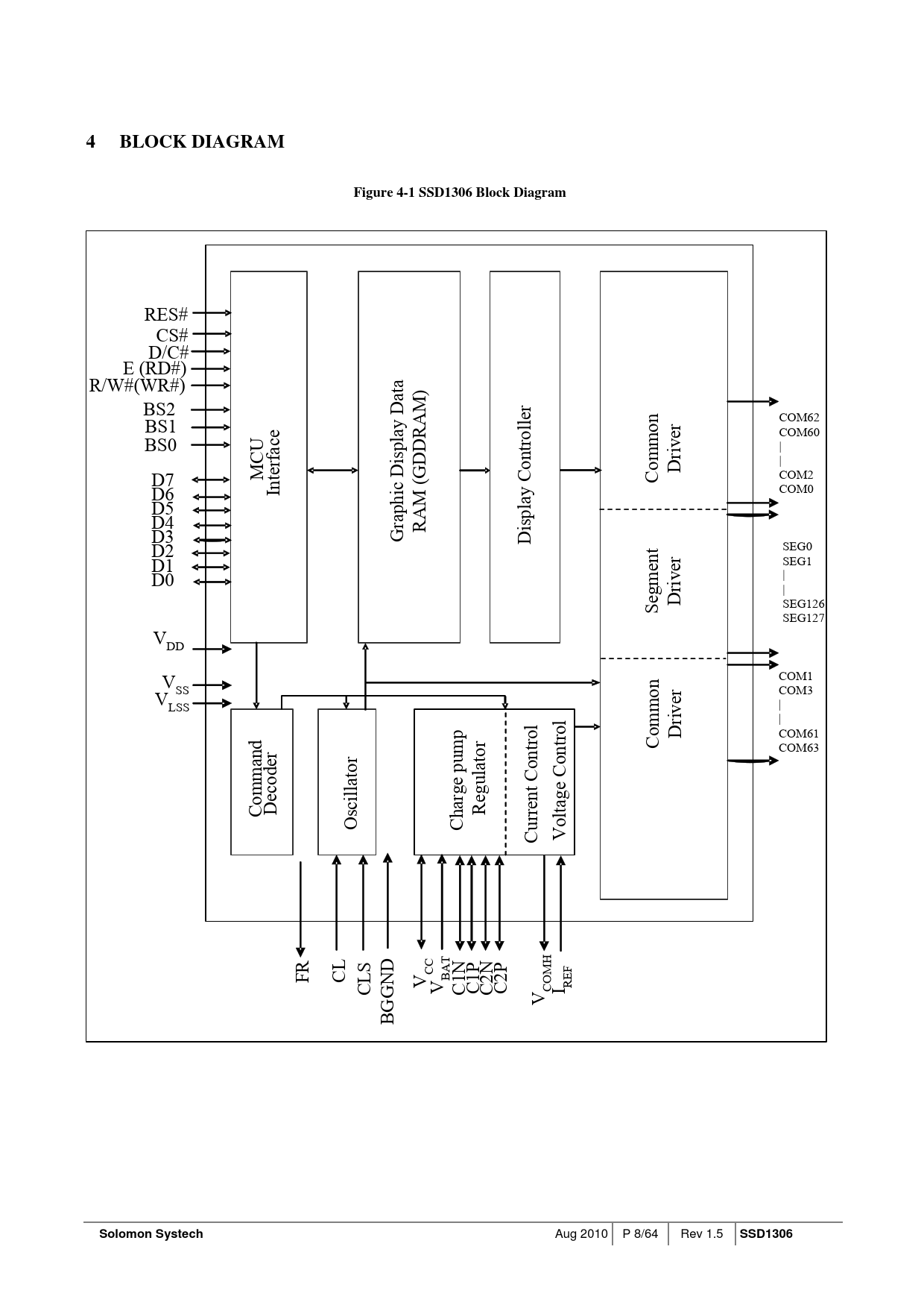

Pages / Page64 / 8 — BLOCK DIAGRAM. Figure 4-1 SSD1306 Block Diagram. Solomon Systech. SSD1306
BLOCK DIAGRAM Figure 4-1 SSD1306 Block Diagram Solomon Systech SSD1306
4 BLOCK DIAGRAM Figure 4-1 SSD1306 Block Diagram
RES# CS# D/C# E (RD#) R/W#(WR#) ta ) BS2 r BS1 y Da lle on COM62 la RAM m er COM60 BS0 sp m iv | DD | ontro MCU D7 Co Dr c Di (G COM2 Interface D6 COM0 D5 phi D4 play C D3 Gra RAM Dis D2 SEG0 t D1 SEG1 en er D0 | gm iv | Dr SEG126 Se SEG127 VDD COM1 V n SS COM3 V | LSS ver | mmo Dri d rol COM61 mp nt Co COM63 an tor der or la lat mm gu e Co Co Deco scil arge pu ag Re rent Control O Ch olt Cur V S T H D CC P P FR CL N N M BA CL V V C1 C2 CO C2 I REF C1 V BGGN
