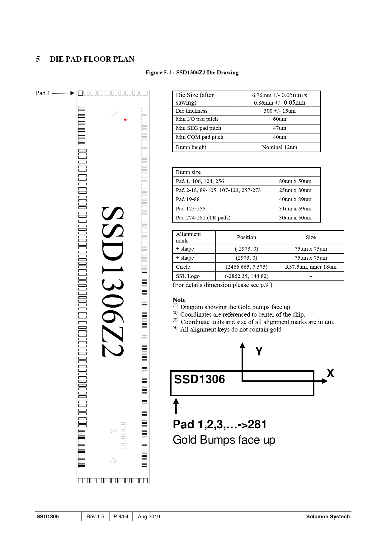

DIE PAD FLOOR PLAN. Figure 5-1 : SSD1306Z2 Die Drawing. Note. SSD1306. Pad 1,2,3,…->281. Solomon Systech
DIE PAD FLOOR PLAN Figure 5-1 : SSD1306Z2 Die Drawing Note SSD1306 Pad 1,2,3,…->281 Solomon Systech
5 DIE PAD FLOOR PLAN Figure 5-1 : SSD1306Z2 Die Drawing
Pad 1 Die Size (after 6.76mm +/- 0.05mm x sawing) 0.86mm +/- 0.05mm Die thickness 300 +/- 15um Min I/O pad pitch 60um Min SEG pad pitch 47um Min COM pad pitch 40um Bump height Nominal 12um Bump size Pad 1, 106, 124, 256 80um x 50um Pad 2-18, 89-105, 107-123, 257-273 25um x 80um SSD1306Z2 Pad 19-88 40um x 89um Pad 125-255 31um x 59um Pad 274-281 (TR pads) 30um x 50um Alignment Position Size mark + shape (-2973, 0) 75um x 75um + shape (2973, 0) 75um x 75um Circle (2466.665, 7.575) R37.5um, inner 18um SSL Logo (-2862.35, 144.82) - (For details dimension please see p.9 )
Note
(1) Diagram showing the Gold bumps face up. (2) Coordinates are referenced to center of the chip. (3) Coordinate units and size of all alignment marks are in um. (4) All alignment keys do not contain gold
Y X SSD1306 Pad 1,2,3,…->281
Gold Bumps face up
SSD1306
