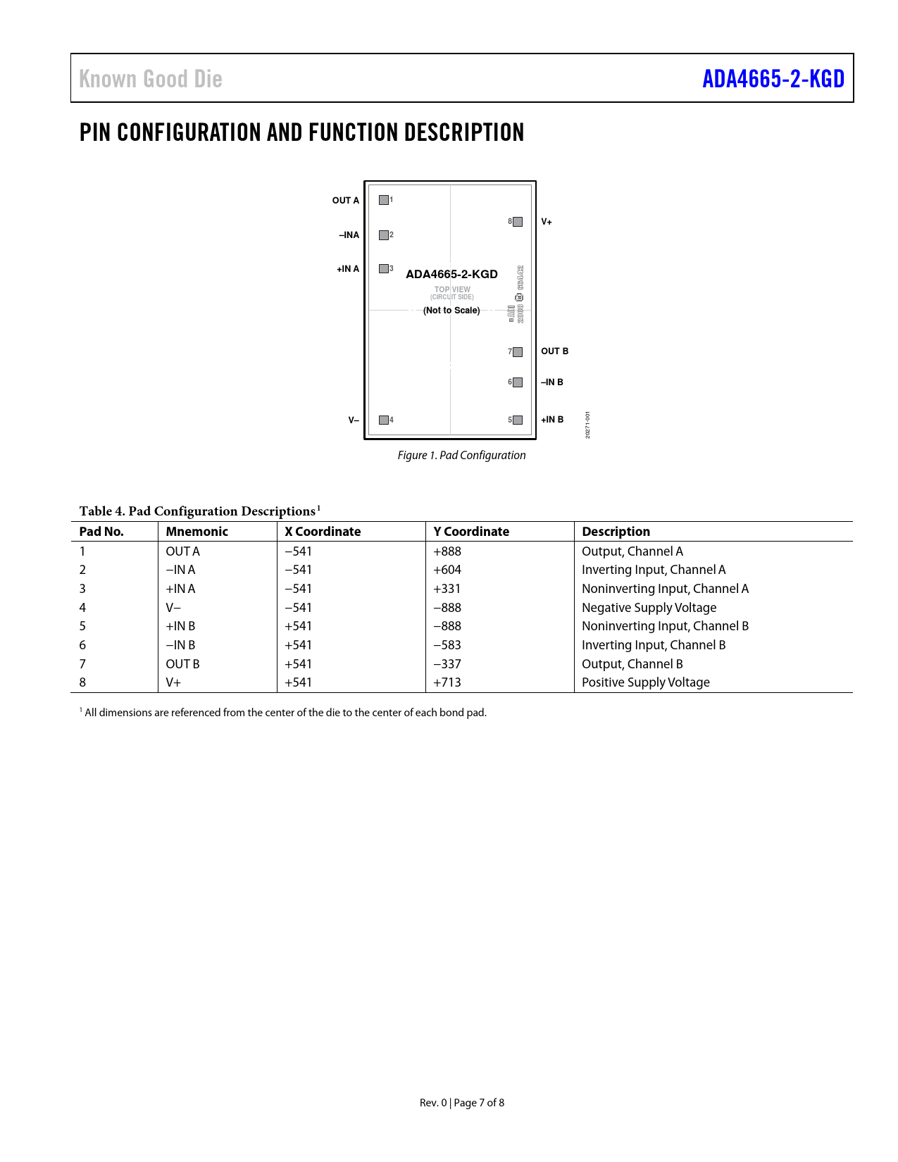

Known Good Die. ADA4665-2-KGD. PIN CONFIGURATION AND FUNCTION DESCRIPTION. OUT A. –INA. +IN A. TOP VIEW. (CIRCUIT SIDE). (Not to Scale)
Known Good Die ADA4665-2-KGD PIN CONFIGURATION AND FUNCTION DESCRIPTION OUT A –INA +IN A TOP VIEW (CIRCUIT SIDE) (Not to Scale)
Known Good Die ADA4665-2-KGD PIN CONFIGURATION AND FUNCTION DESCRIPTION OUT A 1 8 V+ –INA 2 +IN A 3 ADA4665-2-KGD TOP VIEW (CIRCUIT SIDE) (Not to Scale) 7 OUT B 6 –IN B V– 4 5 +IN B
001 20271- Figure 1. Pad Configuration
Table 4. Pad Configuration Descriptions1 Pad No. Mnemonic X Coordinate Y Coordinate Description
1 OUT A −541 +888 Output, Channel A 2 −IN A −541 +604 Inverting Input, Channel A 3 +IN A −541 +331 Noninverting Input, Channel A 4 V− −541 −888 Negative Supply Voltage 5 +IN B +541 −888 Noninverting Input, Channel B 6 −IN B +541 −583 Inverting Input, Channel B 7 OUT B +541 −337 Output, Channel B 8 V+ +541 +713 Positive Supply Voltage 1 All dimensions are referenced from the center of the die to the center of each bond pad. Rev. 0 | Page 7 of 8 Document Outline FEATURES APPLICATIONS GENERAL DESCRIPTION TABLE OF CONTENTS REVISION HISTORY SPECIFICATIONS ELECTRICAL CHARACTERISTICS—16 V OPERATION ELECTRICAL CHARACTERISTICS—5 V OPERATION ABSOLUTE MAXIMUM RATINGS ESD CAUTION PIN CONFIGURATION AND FUNCTION DESCRIPTION OUTLINE DIMENSIONS DIE SPECIFICATIONS AND ASSEMBLY RECOMMENDATIONS ORDERING GUIDE
