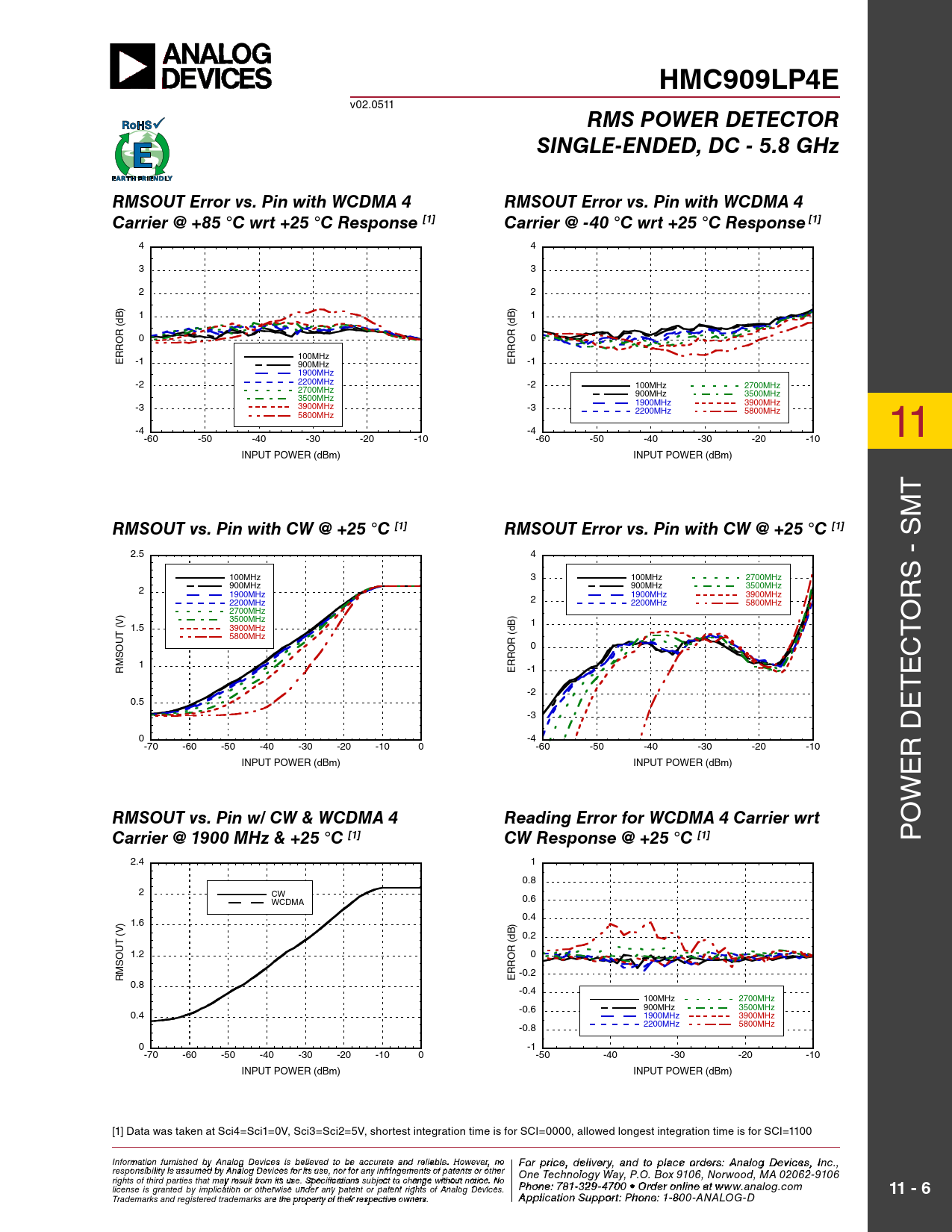

HMC909LP4E. RMS POWER DETECTOR. SINGLE-ENDED, DC - 5.8 GHz. RMSOUT Error vs. Pin with WCDMA 4
HMC909LP4E RMS POWER DETECTOR SINGLE-ENDED, DC - 5.8 GHz RMSOUT Error vs Pin with WCDMA 4
HMC909LP4E
v02.0511
RMS POWER DETECTOR SINGLE-ENDED, DC - 5.8 GHz RMSOUT Error vs. Pin with WCDMA 4 RMSOUT Error vs. Pin with WCDMA 4 Carrier @ +85 °C wrt +25 °C Response [1] Carrier @ -40 °C wrt +25 °C Response [1]
4 4 3 3 2 2 1 1 (dB) (dB) 0 0 ERROR -1 100MHz 900MHz ERROR -1 1900MHz -2 2200MHz -2 2700MHz 100MHz 2700MHz 3500MHz 900MHz 3500MHz -3 3900MHz -3 1900MHz 3900MHz 5800MHz 2200MHz 5800MHz -4 -4 -60 -50 -40 -30 -20 -10 -60 -50 -40 -30 -20 -10 11 INPUT POWER (dBm) INPUT POWER (dBm) t M
RMSOUT vs. Pin with CW @ +25 °C [1] RMSOUT Error vs. Pin with CW @ +25 °C [1]
s 2.5 4 - 100MHz 3 100MHz 2700MHz 900MHz 900MHz 3500MHz 2 1900MHz 2 1900MHz 3900MHz rs 2200MHz 2200MHz 5800MHz 2700MHz 3500MHz (V) 1 o 1.5 3900MHz (dB) 5800MHz t 0 c 1 RMSOUT ERROR -1 e -2 t 0.5 e -3 0 -4 D -70 -60 -50 -40 -30 -20 -10 0 -60 -50 -40 -30 -20 -10 r INPUT POWER (dBm) INPUT POWER (dBm) e w
RMSOUT vs. Pin w/ CW & WCDMA 4 Reading Error for WCDMA 4 Carrier wrt
o
Carrier @ 1900 MHz & +25 °C [1] CW Response @ +25 °C [1]
P 2.4 1 0.8 2 CW WCDMA 0.6 0.4 1.6 (V) 0.2 (dB) 1.2 0 -0.2 RMSOUT ERROR 0.8 -0.4 100MHz 2700MHz -0.6 900MHz 3500MHz 0.4 1900MHz 3900MHz -0.8 2200MHz 5800MHz 0 -1 -70 -60 -50 -40 -30 -20 -10 0 -50 -40 -30 -20 -10 INPUT POWER (dBm) INPUT POWER (dBm) [1] Data was taken at sci4=sci1=0V, sci3=sci2=5V, shortest integration time is for scI=0000, allowed longest integration time is for scI=1100 Info F rmoatr p ion rfiurcne is , d hed ebly ivAe n r al y a og D n evd t ice o p s is bla eli c eve o ed t rd o b e e ras: H ccuratite tiatne M d reli iac bl reo . w Ho av wev e C er, n o o For price, delivery, and to place orders: Analog Devices, Inc., responsibility is assumed by Analog Devices for its use, nor for any infringements of patents or other rporation, 20 Alpha Road, Chelmsford, MA 01824 One Technology Way, P.O. Box 9106, Norwood, MA 02062-9106 Phone: 978-250-3343 Fax: 978-250-3373 O rights of third parties that may result from its use. Specifications subject to change without notice. No P rd ho e ne r O : 7 n 81- -3li 2n 9 e a -47 t w 0 w 0 • O w rd .h e it r o tniltie n .c e ao t m license is granted by implication or otherwise under any patent or patent rights of Analog Devices. www.analog.com
