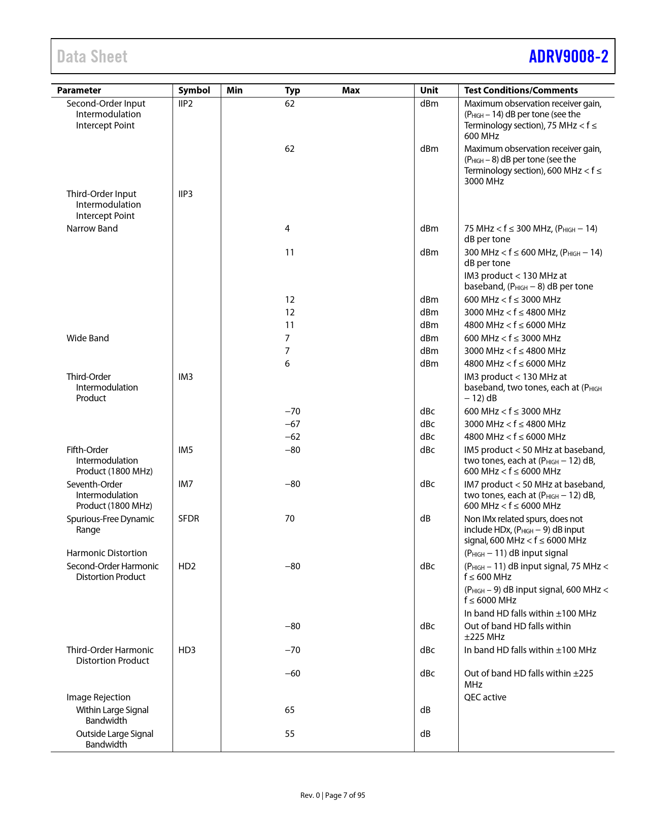

DescriptionIntegrated Dual RF Transmitter and Observation Receiver
Pages / Page95 / 7 — Data Sheet. ADRV9008-2. Parameter. Symbol. Min. Typ. Max. Unit. Test …
File Format / SizePDF / 2.5 Mb
Data Sheet. ADRV9008-2. Parameter. Symbol. Min. Typ. Max. Unit. Test Conditions/Comments
Data Sheet ADRV9008-2 Parameter Symbol Min Typ Max Unit Test Conditions/Comments
link to page 68 link to page 68
Second-Order Input IIP2 62 dBm Maximum observation receiver gain, Intermodulation (PHIGH – 14) dB per tone (see the Intercept Point Terminology section), 75 MHz < f ≤ 600 MHz 62 dBm Maximum observation receiver gain, (PHIGH – 8) dB per tone (see the Terminology section), 600 MHz < f ≤ 3000 MHz Third-Order Input IIP3 Intermodulation Intercept Point Narrow Band 4 dBm 75 MHz < f ≤ 300 MHz, (PHIGH − 14) dB per tone 11 dBm 300 MHz < f ≤ 600 MHz, (PHIGH − 14) dB per tone IM3 product < 130 MHz at baseband, (PHIGH − 8) dB per tone 12 dBm 600 MHz < f ≤ 3000 MHz 12 dBm 3000 MHz < f ≤ 4800 MHz 11 dBm 4800 MHz < f ≤ 6000 MHz Wide Band 7 dBm 600 MHz < f ≤ 3000 MHz 7 dBm 3000 MHz < f ≤ 4800 MHz 6 dBm 4800 MHz < f ≤ 6000 MHz Third-Order IM3 IM3 product < 130 MHz at Intermodulation baseband, two tones, each at (PHIGH Product − 12) dB −70 dBc 600 MHz < f ≤ 3000 MHz −67 dBc 3000 MHz < f ≤ 4800 MHz −62 dBc 4800 MHz < f ≤ 6000 MHz Fifth-Order IM5 −80 dBc IM5 product < 50 MHz at baseband, Intermodulation two tones, each at (PHIGH − 12) dB, Product (1800 MHz) 600 MHz < f ≤ 6000 MHz Seventh-Order IM7 −80 dBc IM7 product < 50 MHz at baseband, Intermodulation two tones, each at (PHIGH − 12) dB, Product (1800 MHz) 600 MHz < f ≤ 6000 MHz Spurious-Free Dynamic SFDR 70 dB Non IMx related spurs, does not Range include HDx, (PHIGH − 9) dB input signal, 600 MHz < f ≤ 6000 MHz Harmonic Distortion (PHIGH − 11) dB input signal Second-Order Harmonic HD2 −80 dBc (PHIGH – 11) dB input signal, 75 MHz < Distortion Product f ≤ 600 MHz (PHIGH – 9) dB input signal, 600 MHz < f ≤ 6000 MHz In band HD falls within ±100 MHz −80 dBc Out of band HD falls within ±225 MHz Third-Order Harmonic HD3 −70 dBc In band HD falls within ±100 MHz Distortion Product −60 dBc Out of band HD falls within ±225 MHz Image Rejection QEC active Within Large Signal 65 dB Bandwidth Outside Large Signal 55 dB Bandwidth Rev. 0 | Page 7 of 95 Document Outline Features Applications General Description Revision History Functional Block Diagram Specifications Current and Power Consumption Specifications Timing Diagrams Absolute Maximum Ratings Reflow Profile Thermal Management Thermal Resistance ESD Caution Pin Configuration and Function Descriptions Typical Performance Characteristics 75 MHz to 525 MHz Band 650 MHz to 3000 MHz Band 3400 MHz to 4800 MHz Band 5100 MHz to 5900 MHz Band Transmitter Output Impedance Observation Receiver Input Impedance Terminology Theory of Operation Transmitter Observation Receiver Clock Input Synthesizers RF PLL Clock PLL Serial Peripheral Interface (SPI) JTAG Boundary Scan Power Supply Sequence GPIO_x Pins Auxiliary Converters AUXADC_x Auxiliary DAC x JESD204B Data Interface Applications Information PCB Layout and Power Supply Recommendations Overview PCB Material and Stackup Selection Fanout and Trace Space Guidelines Component Placement and Routing Guidelines Signals with Highest Routing Priority Signals with Second Routing Priority Signals with Lowest Routing Priority RF and JESD204B Transmission Line Layout RF Routing Guidelines Transmitter Balun DC Feed Supplies JESD204B Trace Routing Recommendations Routing Recommendations Stripline Transmission Lines vs. Microstrip Transmission Lines Isolation Techniques Used on the ADRV9008-2W/PCBZ Isolation Goals Isolation Between JESD204B Lines RF Port Interface Information RF Port Impedance Data Advanced Design System (ADS) Setup Using the DataAccessComponent and SEDZ File Transmitter Bias and Port Interface General Observation Receiver Path Interface Impedance Matching Network Example Outline Dimensions Ordering Guide
