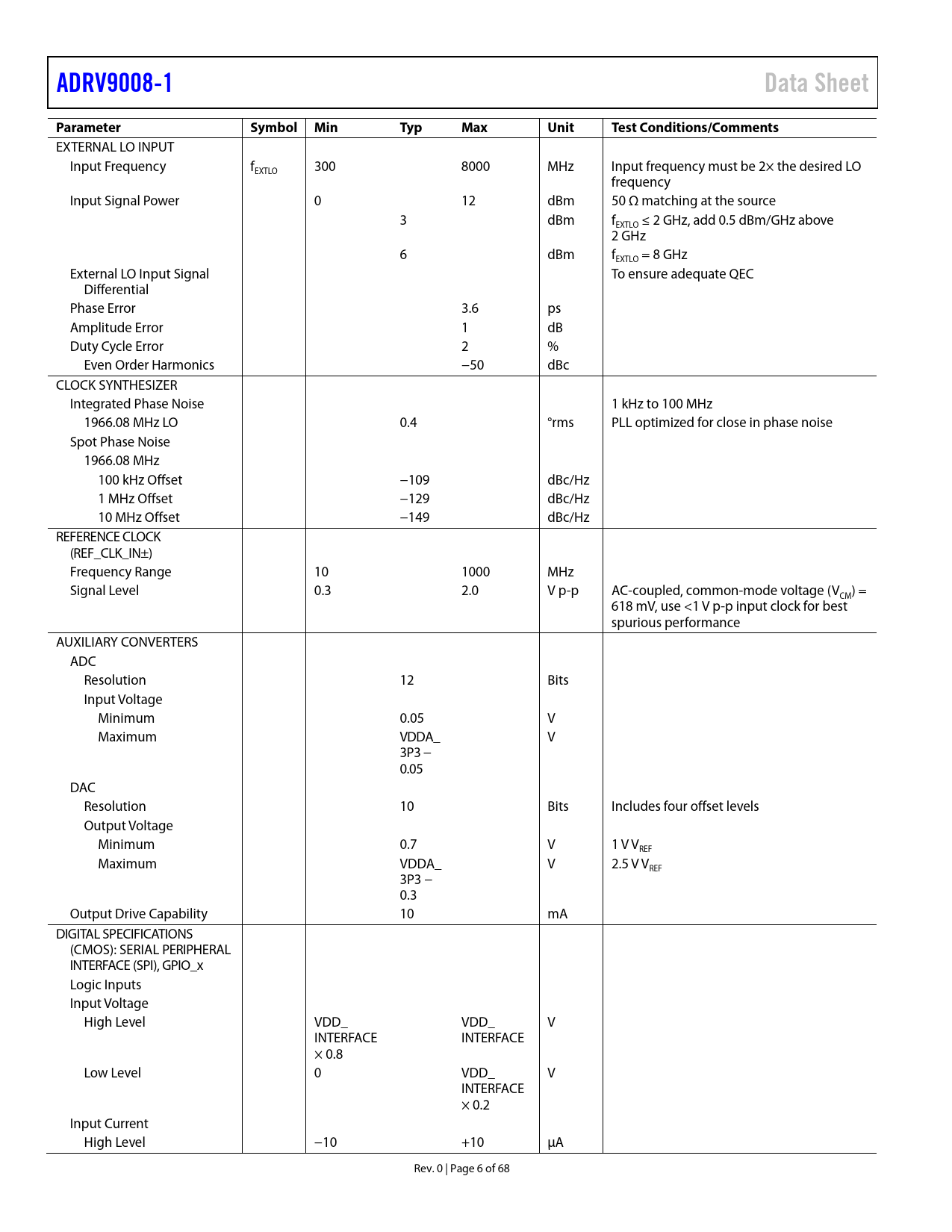

ADRV9008-1. Data Sheet. Parameter. Symbol Min. Typ. Max. Unit. Test Conditions/Comments
ADRV9008-1 Data Sheet Parameter Symbol Min Typ Max Unit Test Conditions/Comments
EXTERNAL LO INPUT Input Frequency f 300 8000 MHz Input frequency must be 2× the desired LO EXTLO frequency Input Signal Power 0 12 dBm 50 Ω matching at the source 3 dBm f ≤ 2 GHz, add 0.5 dBm/GHz above EXTLO 2 GHz 6 dBm f = 8 GHz EXTLO External LO Input Signal To ensure adequate QEC Differential Phase Error 3.6 ps Amplitude Error 1 dB Duty Cycle Error 2 % Even Order Harmonics −50 dBc CLOCK SYNTHESIZER Integrated Phase Noise 1 kHz to 100 MHz 1966.08 MHz LO 0.4 °rms PLL optimized for close in phase noise Spot Phase Noise 1966.08 MHz 100 kHz Offset −109 dBc/Hz 1 MHz Offset −129 dBc/Hz 10 MHz Offset −149 dBc/Hz REFERENCE CLOCK (REF_CLK_IN±) Frequency Range 10 1000 MHz Signal Level 0.3 2.0 V p-p AC-coupled, common-mode voltage (V ) = CM 618 mV, use <1 V p-p input clock for best spurious performance AUXILIARY CONVERTERS ADC Resolution 12 Bits Input Voltage Minimum 0.05 V Maximum VDDA_ V 3P3 − 0.05 DAC Resolution 10 Bits Includes four offset levels Output Voltage Minimum 0.7 V 1 V V REF Maximum VDDA_ V 2.5 V V REF 3P3 − 0.3 Output Drive Capability 10 mA DIGITAL SPECIFICATIONS (CMOS): SERIAL PERIPHERAL INTERFACE (SPI), GPIO_x Logic Inputs Input Voltage High Level VDD_ VDD_ V INTERFACE INTERFACE × 0.8 Low Level 0 VDD_ V INTERFACE × 0.2 Input Current High Level −10 +10 μA Rev. 0 | Page 6 of 68 Document Outline Features Applications General Description Revision History Functional Block Diagram Specifications Current and Power Consumption Specifications Timing Diagrams Absolute Maximum Ratings Reflow Profile Thermal Management Thermal Resistance ESD Caution Pin Configuration and Function Descriptions Typical Performance Characteristics 75 MHz to 525 MHz Band 650 MHz to 3000 MHz Band 3400 MHz to 4800 MHz Band 5100 MHz to 5900 MHz Band Receiver Input Impedance Terminology Theory of Operation Receivers Clock Input Synthesizers RF PLL Clock PLL SPI JTAG Boundary Scan Power Supply Sequence GPIO_x Pins Auxiliary Converters AUXADC_x Auxiliary DAC x JESD204B Data Interface Applications Information PCB Layout and Power Supply Recommendations Overview PCB Material and Stackup Selection Fanout and Trace Space Guidelines Component Placement and Routing Guidelines Signals with Highest Routing Priority Signals with Second Routing Priority Signals with Lowest Routing Priority RF and JESD204B Transmission Line Layout RF Routing Guidelines JESD204B Trace Routing Recommendations Routing Recommendations Stripline Transmission Lines vs. Microstrip Transmission Lines Isolation Techniques Used on the ADRV9008-1W/PCBZ Isolation Goals Isolation Between JESD204B Lines RF Port Interface Information RF Port Impedance Data Advanced Design System (ADS) Setup Using the DataAccessComponent and SEDZ File General Receiver Path Interface Impedance Matching Network Examples Outline Dimensions Ordering Guide
