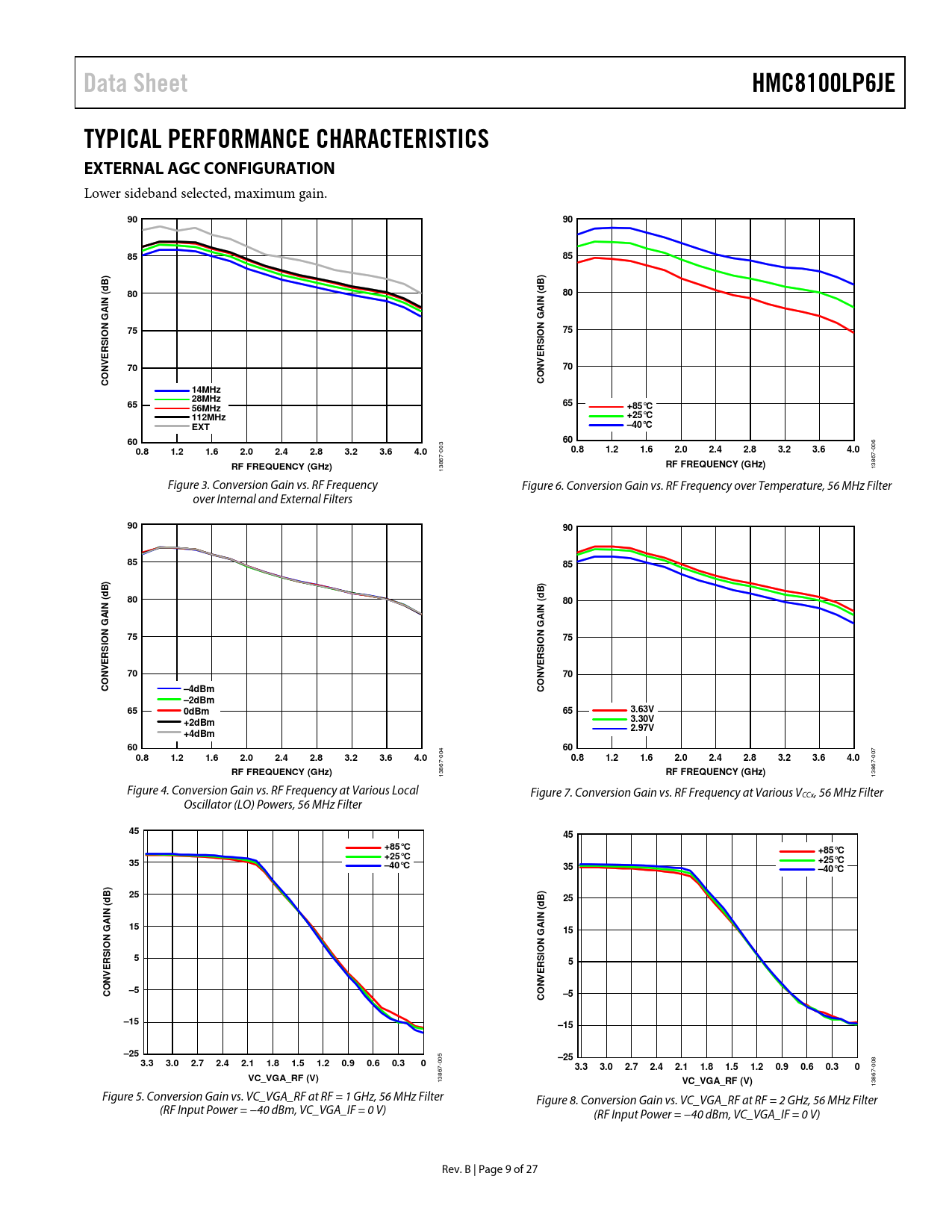

Data Sheet. HMC8100LP6JE. TYPICAL PERFORMANCE CHARACTERISTICS EXTERNAL AGC CONFIGURATION. O SI. RS E. VER. 14MHz 28MHz. 56MHz. +85°C
Data Sheet HMC8100LP6JE TYPICAL PERFORMANCE CHARACTERISTICS EXTERNAL AGC CONFIGURATION O SI RS E VER 14MHz 28MHz 56MHz +85°C
Lower sideband selected, maximum gain.
90 90 85 85 ) B) B (d 80 (d 80 N IN AI A G G N N 75 75 IO O SI RS E VER NV 70 N 70 O CO C 14MHz 28MHz 65 65 56MHz +85°C 112MHz +25°C EXT –40°C 60 60
03 006
0.8 1.2 1.6 2.0 2.4 2.8 3.2 3.6 4.0
0
7- 86
RF FREQUENCY (GHz) RF FREQUENCY (GHz)
13 13867- Figure 3. Conversion Gain vs. RF Frequency Figure 6. Conversion Gain vs. RF Frequency over Temperature, 56 MHz Filter over Internal and External Filters
90 90 85 85 ) B) B (d 80 (d 80 N IN AI A G G N 75 N 75 IO O SI RS E VER NV 70 N 70 O CO –4dBm C –2dBm 65 0dBm 65 3.63V +2dBm 3.30V 2.97V +4dBm 60 60
04
0
007 7- 86
RF FREQUENCY (GHz)
13
RF FREQUENCY (GHz)
13867- Figure 4. Conversion Gain vs. RF Frequency at Various Local Figure 7. Conversion Gain vs. RF Frequency at Various VCCx, 56 MHz Filter Oscillator (LO) Powers, 56 MHz Filter
45 45 +85°C +85°C +25°C 35 +25°C –40°C 35 –40°C B) 25 ) d B 25 d N ( ( AI IN 15 15 N G GA IO ION 5 RS S 5 E R E NV V –5 CO ON –5 C –15 –15 –25
05
–25
8
3.3 3.0 2.7 2.4 2.1 1.8 1.5 1.2 0.9 0.6 0.3 0
0 7-
00 7- 86
VC_VGA_RF (V)
86 13
VC_VGA_RF (V)
13 Figure 5. Conversion Gain vs. VC_VGA_RF at RF = 1 GHz, 56 MHz Filter Figure 8. Conversion Gain vs. VC_VGA_RF at RF = 2 GHz, 56 MHz Filter (RF Input Power = −40 dBm, VC_VGA_IF = 0 V) (RF Input Power = −40 dBm, VC_VGA_IF = 0 V) Rev. B | Page 9 of 27 Document Outline FEATURES APPLICATIONS GENERAL DESCRIPTION FUNCTIONAL BLOCK DIAGRAM REVISION HISTORY SPECIFICATIONS ELECTRICAL CHARACTERISTICS: 800 MHz TO 1800 MHz RF FREQUENCY RANGE ELECTRICAL CHARACTERISTICS: 1800 MHz TO 2800 MHz RF FREQUENCY RANGE ELECTRICAL CHARACTERISTICS: 2800 MHz TO 4000 MHz RF FREQUENCY RANGE ABSOLUTE MAXIMUM RATINGS ESD CAUTION PIN CONFIGURATION AND FUNCTION DESCRIPTIONS TYPICAL PERFORMANCE CHARACTERISTICS EXTERNAL AGC CONFIGURATION INTERNAL AGC CONFIGURATION THEORY OF OPERATION REGISTER ARRAY ASSIGNMENTS AND SERIAL INTERFACE Read Example REGISTER DESCRIPTIONS REGISTER ARRAY ASSIGNMENTS Enable Bits Image Reject and Band-Pass Filter Bits Band-Pass Filter Bits: OTP and SPI AGC AGC: IF Gain Limit Bits Band-Pass Filter Bits: Calibration and 8-Bit Word Frequency AGC: Blocker Power Detector Bits Phase I Bits Phase Q Bits APPLICATIONS INFORMATION SCHEMATIC/TYPICAL APPLICATION CIRCUIT EVALUATION PRINTED CIRCUIT BOARD (PCB) OUTLINE DIMENSIONS ORDERING GUIDE
