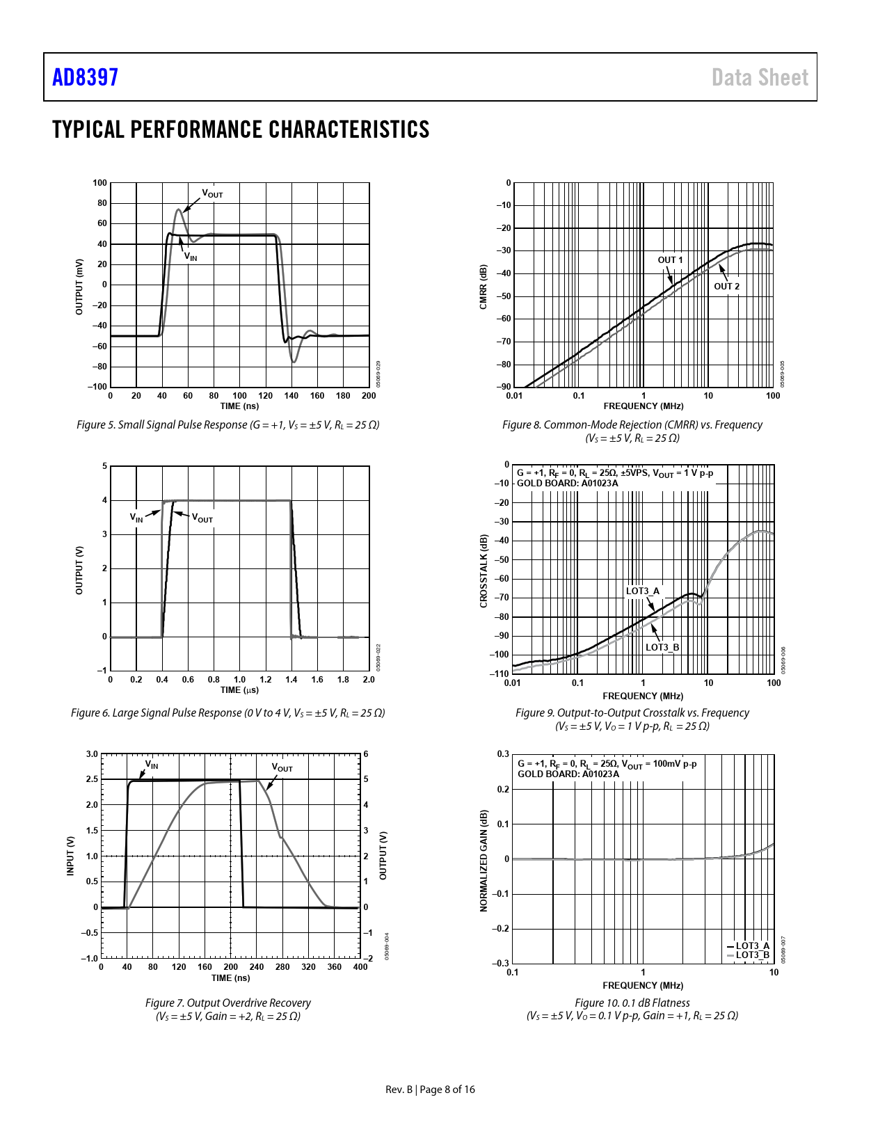

AD8397. Data Sheet. TYPICAL PERFORMANCE CHARACTERISTICS. 100. VOUT. –10. –20. –30. VIN. OUT 1. –40. OUT 2. –50. CMRR (dB). OUTPUT (. –60. –70. –80. –100. –90

Figure 5. Small Signal Pulse Response (G = +1, VS = ±5 V, RL = 25 Ω) Figure 8. Common-Mode Rejection (CMRR) vs. Frequency (VS = ±5 V, RL = 25 Ω)

Figure 6. Large Signal Pulse Response (0 V to 4 V, VS = ±5 V, RL = 25 Ω) Figure 9. Output-to-Output Crosstalk vs. Frequency (VS = ±5 V, VO = 1 V p-p, RL = 25 Ω)

Figure 7. Output Overdrive Recovery Figure 10. 0.1 dB Flatness (VS = ±5 V, Gain = +2, RL = 25 Ω) (VS = ±5 V, VO = 0.1 V p-p, Gain = +1, RL = 25 Ω) Rev. B | Page 8 of 16 Document Outline FEATURES APPLICATIONS GENERAL DESCRIPTION PIN CONFIGURATION TABLE OF CONTENTS REVISION HISTORY SPECIFICATIONS ABSOLUTE MAXIMUM RATINGS MAXIMUM POWER DISSIPATION ESD CAUTION TYPICAL PERFORMANCE CHARACTERISTICS APPLICATIONS INFORMATION POWER SUPPLY AND DECOUPLING LAYOUT CONSIDERATIONS UNITY-GAIN OUTPUT SWING CAPACITIVE LOAD DRIVE OUTLINE DIMENSIONS ORDERING GUIDE
