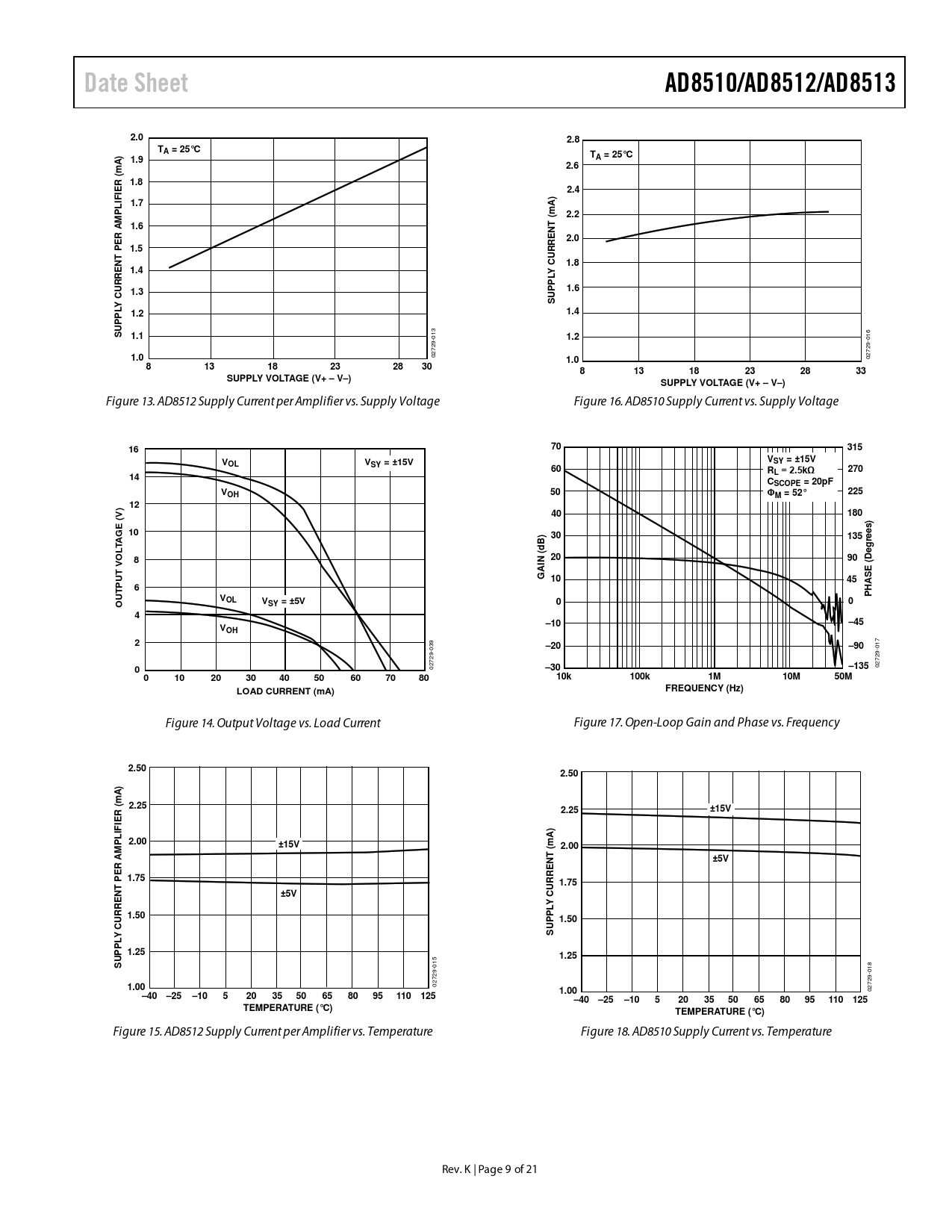

Date Sheet. AD8510/AD8512/AD8513. 2.0. 2.8. TA = 25°C. 1.9. A = 25°C. 2.6. mA) R ( 1.8 IE. 2.4. IF L. 1.7. mA) (. 2.2. 1.6. R E. P 1.5 NT. CURRE. 1.8. 1.4. Y L
Date Sheet AD8510/AD8512/AD8513 2.0 2.8 TA = 25°C 1.9 A = 25°C 2.6 mA) R ( 1.8 IE 2.4 IF L 1.7 mA) ( 2.2 1.6 R E P 1.5 NT CURRE 1.8 1.4 Y L
Date Sheet AD8510/AD8512/AD8513 2.0 2.8 TA = 25°C T 1.9 A = 25°C 2.6 mA) R ( 1.8 IE 2.4 IF L 1.7 P mA) ( 2.2 AM 1.6 NT R E 2.0 P 1.5 NT CURRE 1.8 1.4 Y L 1.3 PP 1.6 CURRE Y SU L 1.2 1.4 PP SU 1.1

8 13 18 23 28 30 8 13 18 23 28 33 SUPPLY VOLTAGE (V+ – V–) SUPPLY VOLTAGE (V+ – V–)
Figure 13. AD8512 Supply Current per Amplifier vs. Supply Voltage Figure 16. AD8510 Supply Current vs. Supply Voltage
16 70 315 V V OL VSY = ±15V SY = ±15V 60 R 270 14 L = 2.5kΩ CSCOPE = 20pF VOH 50 225 ΦM = 52° 12 40 180 E (V) G 10 30 A 135 B) rees) LT d O 8 N ( 20 90 Deg ( T V AI E U G 10 45 TP 6 HAS V P OL OU VSY = ±5V 0 0 4 –10 –45 VOH 2

0 10 20 30 40 50 60 70 80 10k 100k 1M 10M 50M LOAD CURRENT (mA) FREQUENCY (Hz)
Figure 14. Output Voltage vs. Load Current Figure 17. Open-Loop Gain and Phase vs. Frequency
2.50 2.50 mA) 2.25 ±15V R ( 2.25 IE IF L P 2.00 ±15V mA) ( 2.00 AM NT ±5V R E P 1.75 1.75 NT ±5V CURRE Y L 1.50 PP 1.50 CURRE Y SU L PP 1.25 1.25 SU

–40 –25 –10 5 20 35 50 65 80 95 110 125 –40 –25 –10 5 20 35 50 65 80 95 110 125 TEMPERATURE (°C) TEMPERATURE (°C)
Figure 15. AD8512 Supply Current per Amplifier vs. Temperature Figure 18. AD8510 Supply Current vs. Temperature Rev. K | Page 9 of 21 Document Outline FEATURES APPLICATIONS PIN CONFIGURATIONS GENERAL DESCRIPTION TABLE OF CONTENTS REVISION HISTORY SPECIFICATIONS ELECTRICAL CHARACTERISTICS ABSOLUTE MAXIMUM RATINGS ESD CAUTION TYPICAL PERFORMANCE CHARACTERISTICS GENERAL APPLICATION INFORMATION INPUT OVERVOLTAGE PROTECTION OUTPUT PHASE REVERSAL TOTAL HARMONIC DISTORTION (THD) + NOISE TOTAL NOISE INCLUDING SOURCE RESISTORS SETTLING TIME OVERLOAD RECOVERY TIME CAPACITIVE LOAD DRIVE OPEN-LOOP GAIN AND PHASE RESPONSE PRECISION RECTIFIERS I-V CONVERSION APPLICATIONS Photodiode Circuits Signal Transmission Applications Crosstalk OUTLINE DIMENSIONS ORDERING GUIDE
