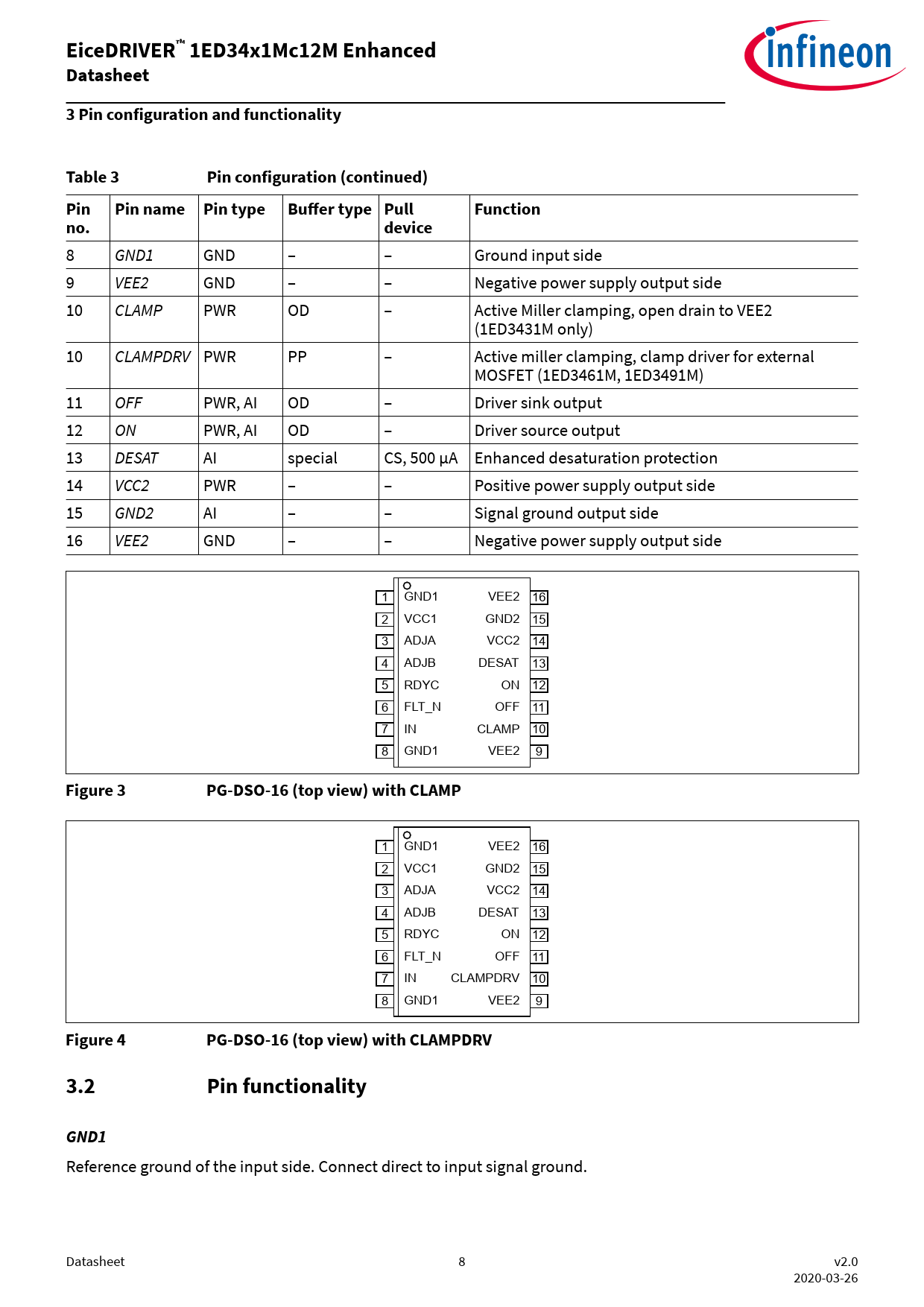

EiceDRIVER™ 1ED34x1Mc12M Enhanced. Datasheet. 3 Pin configuration and functionality. Table 3. Pin configuration (continued). Pin
EiceDRIVER™ 1ED34x1Mc12M Enhanced Datasheet 3 Pin configuration and functionality Table 3 Pin configuration (continued) Pin Pin name Pin type Buffer type Pull Function no. device
8 GND1 GND – – Ground input side 9 VEE2 GND – – Negative power supply output side 10 CLAMP PWR OD – Active Miller clamping, open drain to VEE2 (1ED3431M only) 10 CLAMPDRV PWR PP – Active miller clamping, clamp driver for external MOSFET (1ED3461M, 1ED3491M) 11 OFF PWR, AI OD – Driver sink output 12 ON PWR, AI OD – Driver source output 13 DESAT AI special CS, 500 µA Enhanced desaturation protection 14 VCC2 PWR – – Positive power supply output side 15 GND2 AI – – Signal ground output side 16 VEE2 GND – – Negative power supply output side 1 GND1 VEE2 16 2 VCC1 GND2 15 3 ADJA VCC2 14 4 ADJB DESAT 13 5 RDYC ON 12 6 FLT_N OFF 11 7 IN CLAMP 10 8 GND1 VEE2 9
Figure 3 PG-DSO-16 (top view) with CLAMP
1 GND1 VEE2 16 2 VCC1 GND2 15 3 ADJA VCC2 14 4 ADJB DESAT 13 5 RDYC ON 12 6 FLT_N OFF 11 7 IN CLAMPDRV 10 8 GND1 VEE2 9
Figure 4 PG-DSO-16 (top view) with CLAMPDRV 3.2 Pin functionality GND1
Reference ground of the input side. Connect direct to input signal ground. Datasheet 8 v2.0 2020-03-26 Document Outline Table of contents 1 Block diagram 2 Related products 3 Pin configuration and functionality 3.1 Pin configuration 3.2 Pin functionality 4 Functional description 4.1 Start-up and fault clearing 4.2 Supply 4.2.1 Input side undervoltage lockout, VCC1 UVLO 4.2.2 Output side under-voltage lockout, VCC2 UVLO 4.3 Input side logic 4.3.1 IN non-inverting driver input 4.3.2 RDYC ready status output, fault-off and fault clear input 4.3.2.1 RDYC fault-off input 4.3.2.2 RDYC fault clear input 4.3.3 FLT_N status output and fault-off input 4.3.3.1 FLT_N fault-off input 4.4 Desaturation protection 4.4.1 DESAT behavior 4.4.2 DESAT filter and leading edge blanking time adjustment with ADJB 4.5 Gate driver output 4.5.1 Turn-on behavior 4.5.2 Turn-off and fault turn-off behavior 4.5.2.1 Hard switching turn-off 4.5.2.2 Soft turn-off 4.5.2.2.1 Soft-off current source adjustment with ADJA 4.5.3 Active shut-down 4.5.4 Active Miller clamp 4.5.4.1 CLAMP output types 4.5.5 Switch-off timeout until forced switch-off 4.6 Short circuit clamping 5 Electrical parameters 5.1 Absolute maximum ratings 5.2 Thermal parameters 5.3 Operating parameters 5.4 Electrical characteristics 5.4.1 Voltage supply 5.4.2 Logic input and output 5.4.3 Analog input 5.4.4 Gate driver 5.4.5 Active Miller clamp 5.4.6 Dynamic characteristics 5.4.7 Desaturation protection 5.4.8 Soft-off current source 5.4.9 Over-temperature protection 6 Insulation characteristics 6.1 Certified according to VDE 0884-11 and IEC 60747-17 reinforced insulation (planned) 6.2 Recognized under UL 1577 (planned) 6.3 Reliability 7 Package information 8 Application notes 8.1 Reference layout for thermal data 8.2 Printed circuit board guidelines Revision history Disclaimer
