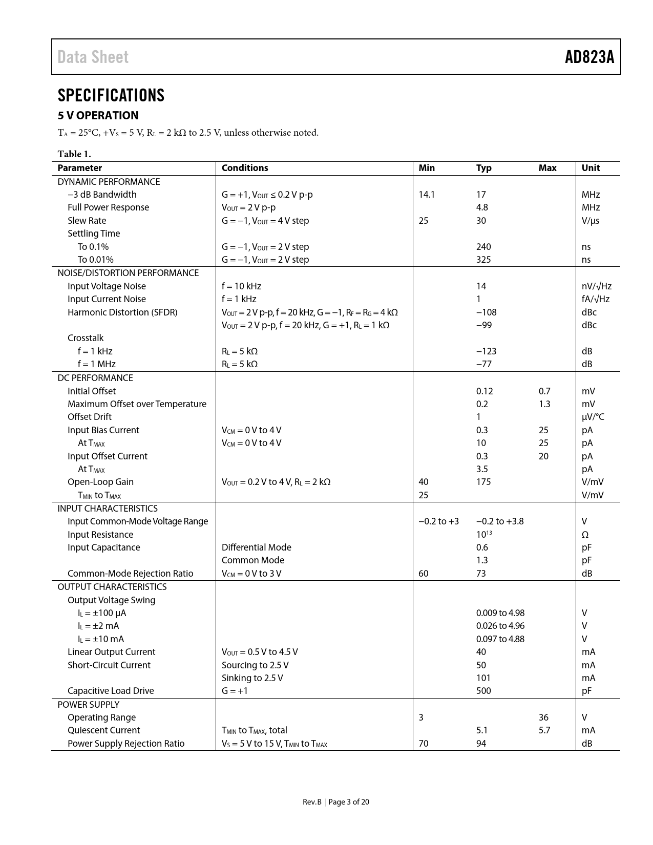

Data Sheet. AD823A. SPECIFICATIONS 5 V OPERATION. Table 1. Parameter. Conditions. Min. Typ. Max. Unit
Data Sheet AD823A SPECIFICATIONS 5 V OPERATION Table 1 Parameter Conditions Min Typ Max Unit
TA = 25°C, +VS = 5 V, RL = 2 kΩ to 2.5 V, unless otherwise noted.
Table 1. Parameter Conditions Min Typ Max Unit
DYNAMIC PERFORMANCE −3 dB Bandwidth G = +1, VOUT ≤ 0.2 V p-p 14.1 17 MHz Full Power Response VOUT = 2 V p-p 4.8 MHz Slew Rate G = −1, VOUT = 4 V step 25 30 V/µs Settling Time To 0.1% G = −1, VOUT = 2 V step 240 ns To 0.01% G = −1, VOUT = 2 V step 325 ns NOISE/DISTORTION PERFORMANCE Input Voltage Noise f = 10 kHz 14 nV/√Hz Input Current Noise f = 1 kHz 1 fA/√Hz Harmonic Distortion (SFDR) VOUT = 2 V p-p, f = 20 kHz, G = −1, RF = RG = 4 kΩ −108 dBc VOUT = 2 V p-p, f = 20 kHz, G = +1, RL = 1 kΩ −99 dBc Crosstalk f = 1 kHz RL = 5 kΩ −123 dB f = 1 MHz RL = 5 kΩ −77 dB DC PERFORMANCE Initial Offset 0.12 0.7 mV Maximum Offset over Temperature 0.2 1.3 mV Offset Drift 1 µV/°C Input Bias Current VCM = 0 V to 4 V 0.3 25 pA At TMAX VCM = 0 V to 4 V 10 25 pA Input Offset Current 0.3 20 pA At TMAX 3.5 pA Open-Loop Gain VOUT = 0.2 V to 4 V, RL = 2 kΩ 40 175 V/mV TMIN to TMAX 25 V/mV INPUT CHARACTERISTICS Input Common-Mode Voltage Range −0.2 to +3 −0.2 to +3.8 V Input Resistance 1013 Ω Input Capacitance Differential Mode 0.6 pF Common Mode 1.3 pF Common-Mode Rejection Ratio VCM = 0 V to 3 V 60 73 dB OUTPUT CHARACTERISTICS Output Voltage Swing IL = ±100 µA 0.009 to 4.98 V IL = ±2 mA 0.026 to 4.96 V IL = ±10 mA 0.097 to 4.88 V Linear Output Current VOUT = 0.5 V to 4.5 V 40 mA Short-Circuit Current Sourcing to 2.5 V 50 mA Sinking to 2.5 V 101 mA Capacitive Load Drive G = +1 500 pF POWER SUPPLY Operating Range 3 36 V Quiescent Current TMIN to TMAX, total 5.1 5.7 mA Power Supply Rejection Ratio VS = 5 V to 15 V, TMIN to TMAX 70 94 dB Rev. B | Page 3 of 20 Document Outline Features Applications General Description Connection Diagram Revision History Specifications 5 V Operation 3.3 V Operation ±15 V Operation Absolute Maximum Ratings Thermal Resistance ESD Caution Pin Configuration and Function Descriptions Typical Performance Characteristics Theory of Operation Output Impedance Applications Information Input Characteristics Output Characteristics Wideband Photodiode Preamp Active Filter Maximizing Performance Through Proper Layout Outline Dimensions Ordering Guide
