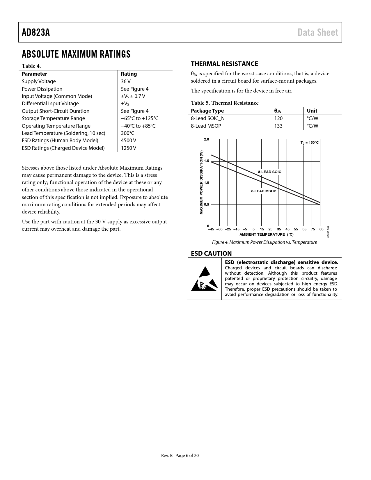

AD823A. Data Sheet. ABSOLUTE MAXIMUM RATINGS Table 4. THERMAL RESISTANCE. Parameter Rating. Table 5. Thermal Resistance
AD823A Data Sheet ABSOLUTE MAXIMUM RATINGS Table 4 THERMAL RESISTANCE Parameter Rating Table 5 Thermal Resistance
link to page 6 link to page 6
AD823A Data Sheet ABSOLUTE MAXIMUM RATINGS Table 4. THERMAL RESISTANCE Parameter Rating
θJA is specified for the worst-case conditions, that is, a device Supply Voltage 36 V soldered in a circuit board for surface-mount packages. Power Dissipation See Figure 4 The specification is for the device in free air. Input Voltage (Common Mode) ±VS ± 0.7 V Differential Input Voltage ±VS
Output Short-Circuit Duration See Figure 4
Package Type θJA Unit
Storage Temperature Range −65°C to +125°C 8-Lead SOIC_N 120 °C/W Operating Temperature Range −40°C to +85°C 8-Lead MSOP 133 °C/W Lead Temperature (Soldering, 10 sec) 300°C ESD Ratings (Human Body Model) 4500 V
2.0 TJ = 150°C
ESD Ratings (Charged Device Model) 1250 V
) (W N IO 1.5 T
Stresses above those listed under Absolute Maximum Ratings
PA 8-LEAD SOIC
may cause permanent damage to the device. This is a stress
ISSI
rating only; functional operation of the device at these or any
D 1.0 ER
other conditions above those indicated in the operational
W 8-LEAD MSOP
section of this specification is not implied. Exposure to absolute
PO M
maximum rating conditions for extended periods may affect
MU 0.5 XI
device reliability.
MA
Use the part with caution at the 30 V supply as excessive output
0
current may overheat and damage the part. 4
–45 –35 –25 –15 –5 5 15 25 35 45 55 65 75 85
-00 9
AMBIENT TEMPERATURE (°C)
43 09 Figure 4. Maximum Power Dissipation vs. Temperature
