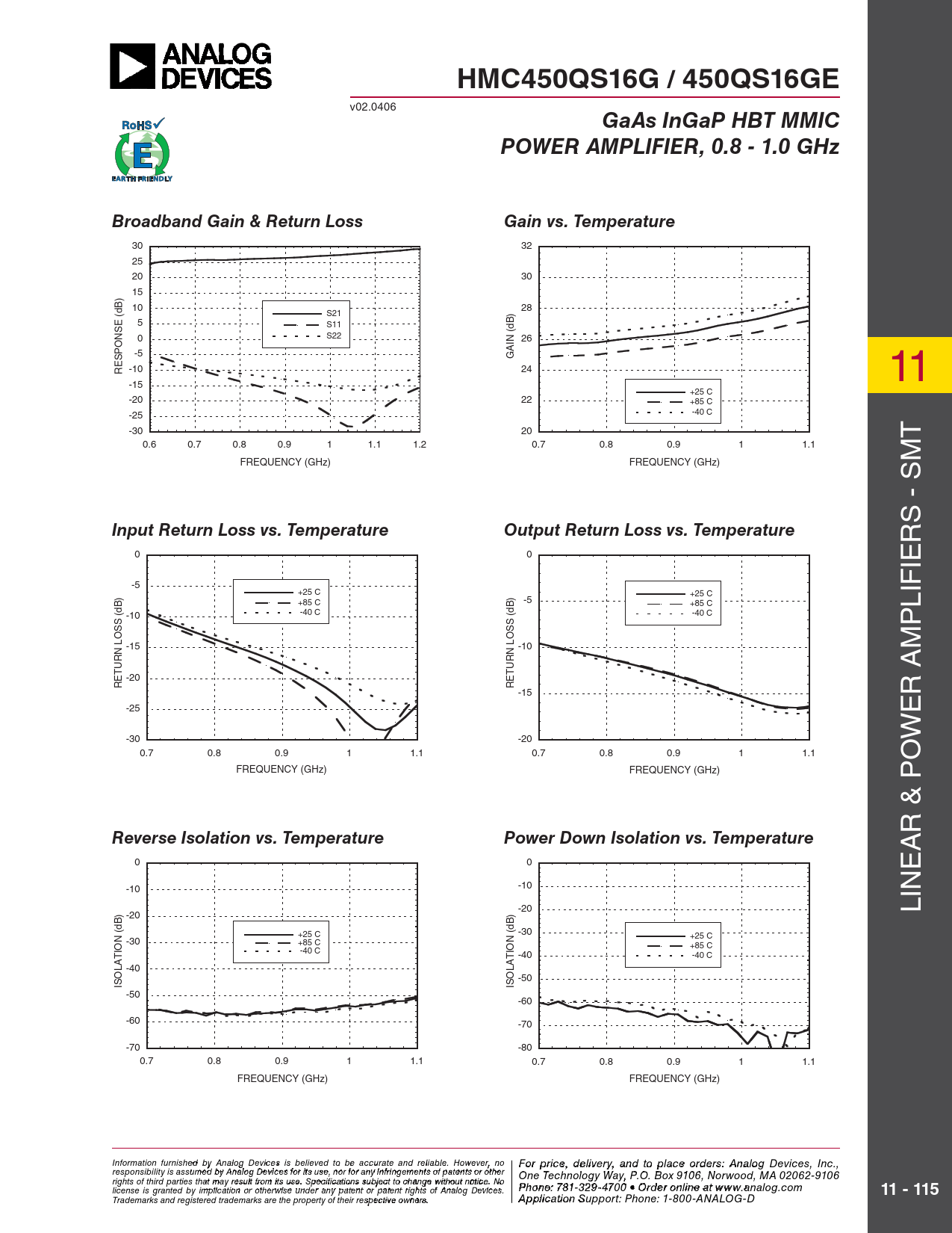

DescriptionGaAs InGaP HBT MMIC POWER AMPLIFIER, 0.8 - 1.0 GHz
Pages / Page8 / 2 — HMC450QS16G / 450QS16GE. GaAs InGaP HBT MMIC. POWER AMPLIFIER, 0.8 - 1.0 …
File Format / SizePDF / 417 Kb
HMC450QS16G / 450QS16GE. GaAs InGaP HBT MMIC. POWER AMPLIFIER, 0.8 - 1.0 GHz. Broadband Gain & Return Loss
HMC450QS16G / 450QS16GE GaAs InGaP HBT MMIC POWER AMPLIFIER, 0.8 - 1.0 GHz Broadband Gain & Return Loss
v02.0406
GaAs InGaP HBT MMIC POWER AMPLIFIER, 0.8 - 1.0 GHz Broadband Gain & Return Loss Gain vs. Temperature
30 32 25 20 30 15 10 28 S21 5 S11 0 S22 26 -5 GAIN (dB) -10 RESPONSE (dB) 24 -15 11 +25 C -20 22 +85 C -25 -40 C -30 20 T 0.6 0.7 0.8 0.9 1 1.1 1.2 0.7 0.8 0.9 1 1.1 FREQUENCY (GHz) FREQUENCY (GHz) - SM S
Input Return Loss vs. Temperature Output Return Loss vs. Temperature
R 0 0 IE -5 +25 C +25 C IF +85 C -5 +85 C L -40 C -40 C -10 P -15 -10 M -20 RETURN LOSS (dB) RETURN LOSS (dB) -15 R A -25 E -30 -20 W 0.7 0.8 0.9 1 1.1 0.7 0.8 0.9 1 1.1 O FREQUENCY (GHz) FREQUENCY (GHz) & P R
Reverse Isolation vs. Temperature Power Down Isolation vs. Temperature
A 0 0 E -10 -10 IN -20 L -20 +25 C -30 +25 C -30 +85 C +85 C -40 C -40 -40 C -40 -50 ISOLATION (dB) ISOLATION (dB) -50 -60 -60 -70 -70 -80 0.7 0.8 0.9 1 1.1 0.7 0.8 0.9 1 1.1 FREQUENCY (GHz) FREQUENCY (GHz) Information furnish F e o d r pri by An ce, de alog Devic leis vie s rbyeli, a eve nd to pla d to be accur ce o ate an r d der relia s ble , pl . Ho ease co wever, no For price, delivery, and to place orders: Analog Devices, Inc., responsibility is assumed by Analog Devices for its use, nor for any infringements of patents or other ntact Hittite Microwave Corporation: One Technology Way, P.O. Box 9106, Norwood, MA 02062-9106 20 Alpha Road, Chelmsford, MA 01824 Phone rights of third parties that may result from its use. Specifications subject to change without notice. No license is granted by implication or otherwise under any patent or patent rights of Analog Devices. : 978 Pho - n 25 e: 7 0- 81 33 2 4 9- 3 F 470 ax: 978 0 • Order o - n 25 lin 0 e a-t 3373 www.analog.com
