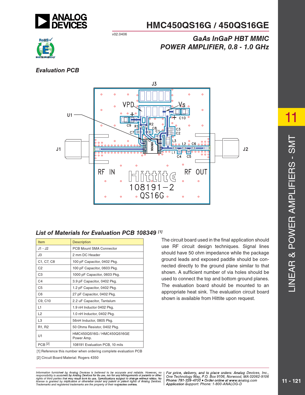

HMC450QS16G / 450QS16GE. GaAs InGaP HBT MMIC. POWER AMPLIFIER, 0.8 - 1.0 GHz. Evaluation PCB
HMC450QS16G / 450QS16GE GaAs InGaP HBT MMIC POWER AMPLIFIER, 0.8 - 1.0 GHz Evaluation PCB
v02.0406
11 T - SM S R IE IF L P M R A E
List of Materials for Evaluation PCB 108349 [1]
W The circuit board used in the fi nal application should Item Description O use RF circuit design techniques. Signal lines J1 - J2 PCB Mount SMA Connector should have 50 ohm impedance while the package J3 2 mm DC Header ground leads and exposed paddle should be con- & P C1, C7, C8 100 pF Capacitor, 0402 Pkg. nected directly to the ground plane similar to that R C2 100 pF Capacitor, 0603 Pkg. shown. A sufficient number of via holes should be A C3 1000 pF Capacitor, 0603 Pkg. E used to connect the top and bottom ground planes. C4 3.9 pF Capacitor, 0402 Pkg. The evaluation board should be mounted to an C5 1.2 pF Capacitor, 0402 Pkg. IN appropriate heat sink. The evaluation circuit board L C6 27 pF Capacitor, 0402 Pkg. shown is available from Hittite upon request. C9, C10 2.2 uF Capacitor, Tantalum L1 1.9 nH Inductor 0402 Pkg. L2 1.0 nH Inductor, 0402 Pkg. L3 56nH Inductor, 0805 Pkg. R1, R2 50 Ohms Resistor, 0402 Pkg. HMC450QS16G / HMC450QS16GE U1 Power Amp. PCB [2] 108191 Evaluation PCB, 10 mils [1] Reference this number when ordering complete evaluation PCB [2] Circuit Board Material: Rogers 4350 Information furnish F e o d r pri by An ce, de alog Devic leis vie s rbyeli, a eve nd to pla d to be accur ce o ate an r d der relia s ble , pl . Ho ease co wever, no For price, delivery, and to place orders: Analog Devices, Inc., responsibility is assumed by Analog Devices for its use, nor for any infringements of patents or other ntact Hittite Microwave Corporation: One Technology Way, P.O. Box 9106, Norwood, MA 02062-9106 20 Alpha Road, Chelmsford, MA 01824 Phone rights of third parties that may result from its use. Specifications subject to change without notice. No license is granted by implication or otherwise under any patent or patent rights of Analog Devices. : 978 Pho - n 25 e: 7 0- 81 33 2 4 9- 3 F 470 ax: 978 0 • Order o - n 25 lin 0 e a-t 3373 www.analog.com
