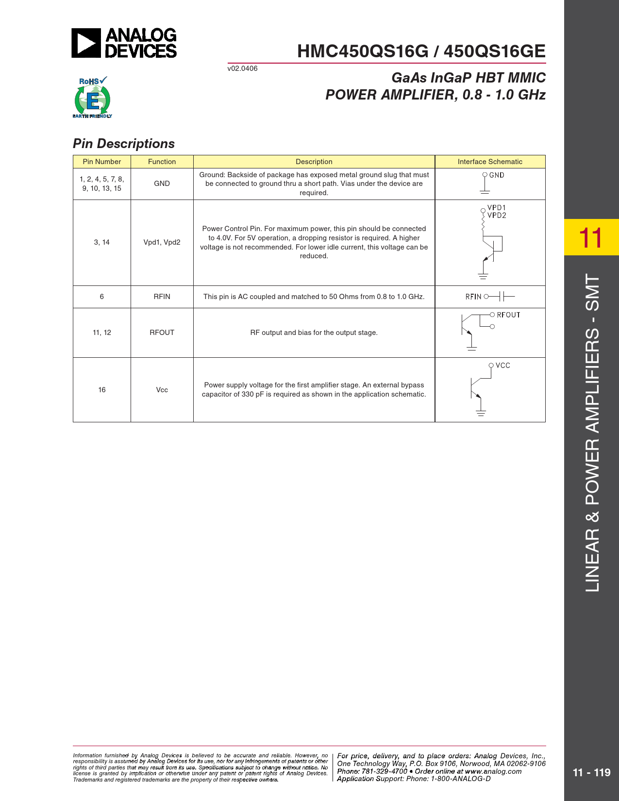

HMC450QS16G / 450QS16GE. GaAs InGaP HBT MMIC. POWER AMPLIFIER, 0.8 - 1.0 GHz. Pin Descriptions. 11 - 119
HMC450QS16G / 450QS16GE GaAs InGaP HBT MMIC POWER AMPLIFIER, 0.8 - 1.0 GHz Pin Descriptions 11 - 119
v02.0406
Pin Number Function Description Interface Schematic Ground: Backside of package has exposed metal ground slug that must 1, 2, 4, 5, 7, 8, GND be connected to ground thru a short path. Vias under the device are 9, 10, 13, 15 required. Power Control Pin. For maximum power, this pin should be connected to 4.0V. For 5V operation, a dropping resistor is required. A higher 3, 14 Vpd1, Vpd2 voltage is not recommended. For lower idle current, this voltage can be 11 reduced. T 6 RFIN This pin is AC coupled and matched to 50 Ohms from 0.8 to 1.0 GHz. - SM 11, 12 RFOUT RF output and bias for the output stage. S R IE Power supply voltage for the fi rst amplifi er stage. An external bypass IF 16 Vcc capacitor of 330 pF is required as shown in the application schematic. L P M R A E W O & P R A E IN L Information furnish F e o d r pri by An ce, de alog Devic leis vie s rbyeli, a eve nd to pla d to be accur ce o ate an r d der relia s ble , pl . Ho ease co wever, no For price, delivery, and to place orders: Analog Devices, Inc., responsibility is assumed by Analog Devices for its use, nor for any infringements of patents or other ntact Hittite Microwave Corporation: One Technology Way, P.O. Box 9106, Norwood, MA 02062-9106 20 Alpha Road, Chelmsford, MA 01824 Phone rights of third parties that may result from its use. Specifications subject to change without notice. No license is granted by implication or otherwise under any patent or patent rights of Analog Devices. : 978 Pho - n 25 e: 7 0- 81 33 2 4 9- 3 F 470 ax: 978 0 • Order o - n 25 lin 0 e a-t 3373 www.analog.com
