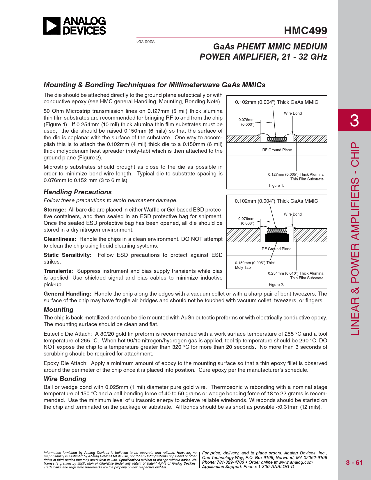

The die should be attached directly to the ground plane eutectically or with conductive epoxy (see HMC general Handling, Mounting, Bonding Note). 0.102mm (0.004”) Thick GaAs MMIC 50 Ohm Microstrip transmission lines on 0.127mm (5 mil) thick alumina Wire Bond thin fi lm substrates are recommended for bringing RF to and from the chip 0.076mm (Figure 1). If 0.254mm (10 mil) thick alumina thin fi lm substrates must be (0.003”) 3 used, the die should be raised 0.150mm (6 mils) so that the surface of the die is coplanar with the surface of the substrate. One way to accom- plish this is to attach the 0.102mm (4 mil) thick die to a 0.150mm (6 mil) thick molybdenum heat spreader (moly-tab) which is then attached to the RF Ground Plane IP ground plane (Figure 2). H Microstrip substrates should brought as close to the die as possible in order to minimize bond wire length. Typical die-to-substrate spacing is 0.127mm (0.005”) Thick Alumina 0.076mm to 0.152 mm (3 to 6 mils). Thin Film Substrate S - C Figure 1. R

Follow these precautions to avoid permanent damage. 0.102mm (0.004”) Thick GaAs MMIC IE

Suppress instrument and bias supply transients while bias 0.254mm (0.010”) Thick Alumina O is applied. Use shielded signal and bias cables to minimize inductive Thin Film Substrate pick-up. Figure 2.
