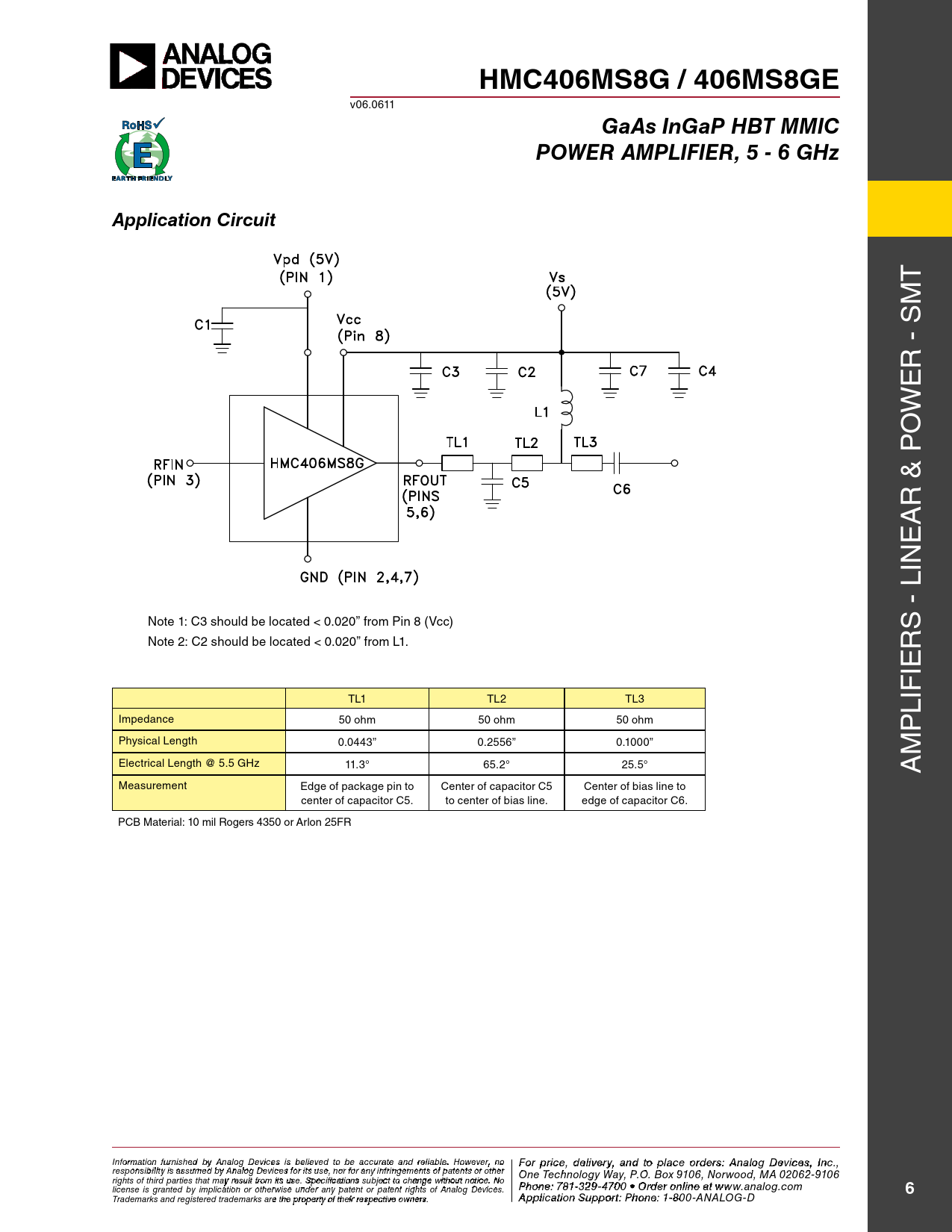

HMC406MS8G / 406MS8GE. GaAs InGaP HBT MMIC. POWER AMPLIFIER, 5 - 6 GHz. Application Circuit
HMC406MS8G / 406MS8GE GaAs InGaP HBT MMIC POWER AMPLIFIER, 5 - 6 GHz Application Circuit
v06.0611
T m s r - e w o p r & A e lin note 1: C3 should be located < 0.020” from pin 8 (Vcc) s - note 2: C2 should be located < 0.020” from l1. r ie Tl1 Tl2 Tl3 lif impedance 50 ohm 50 ohm 50 ohm p physical length 0.0443” 0.2556” 0.1000” m electrical length @ 5.5 GHz 11.3° 65.2° 25.5° A measurement edge of package pin to Center of capacitor C5 Center of bias line to center of capacitor C5. to center of bias line. edge of capacitor C6. pCB material: 10 mil rogers 4350 or Arlon 25fr Inf F or o m r p atio r n ifc ur e n , d ishe e d lbiv y e A r n y a alog n D d t evic o p es is la beclie o eved rd to ebre sa: H ccur iattti e tae M nd re ilicarbloew . H a o ve C wever, o n rp o For price, delivery, and to place orders: Analog Devices, Inc., responsibility is assumed by Analog Devices for its use, nor for any infringements of patents or other oration, 2 Elizabeth Drive, Chelmsford, MA 01824 One Technology Way, P.O. Box 9106, Norwood, MA 02062-9106 Phone: 978-250-3343 Fax: 978-250-3373 O rights of third parties that may result from its use. Specifications subject to change without notice. No P rd ho e ne r O : 7 n 81- -3li 2n 9 e a -47 t w 0 w 0 • O w rd .h e it r o tniltie n .c e ao t m license is granted by implication or otherwise under any patent or patent rights of Analog Devices. www.analog.com
