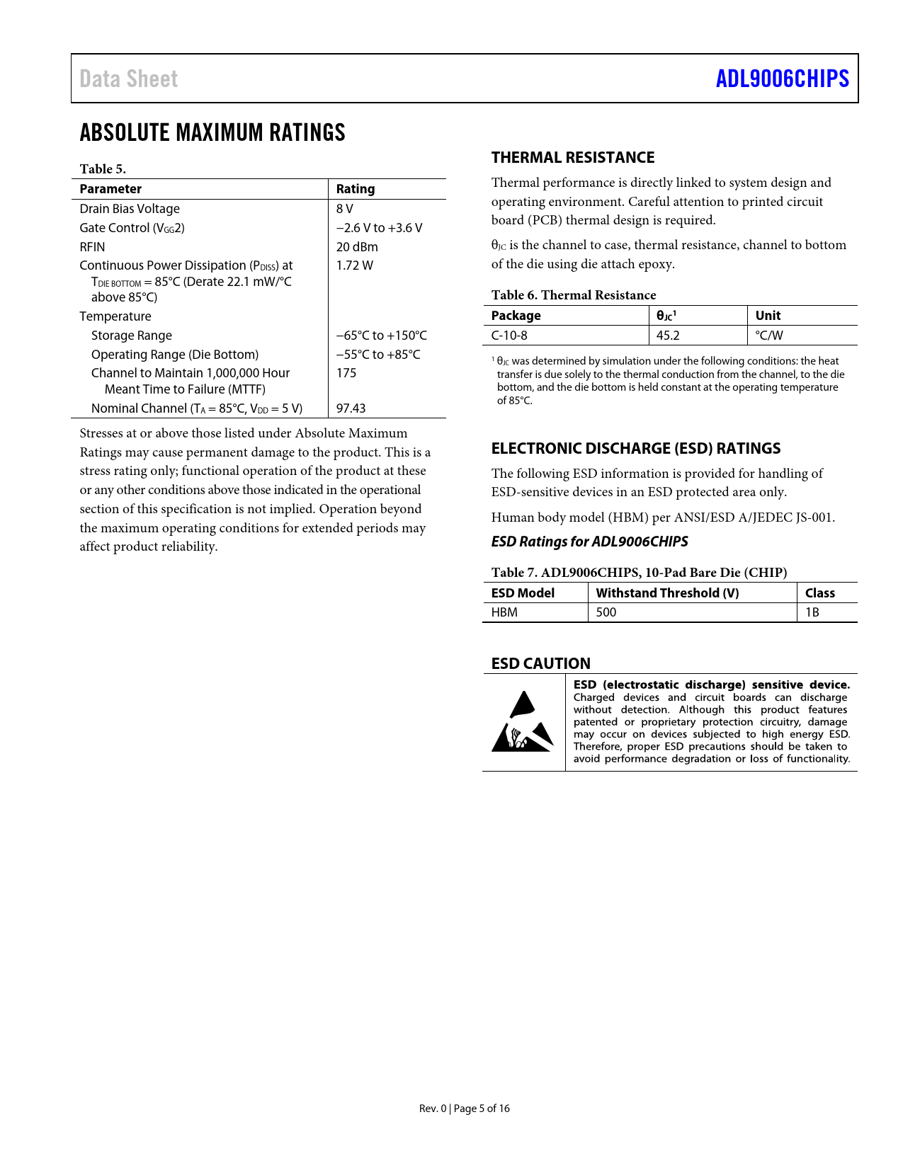

Data Sheet. ADL9006CHIPS. ABSOLUTE MAXIMUM RATINGS. THERMAL RESISTANCE. Table 5. Parameter. Rating. Table 6. Thermal Resistance
Data Sheet ADL9006CHIPS ABSOLUTE MAXIMUM RATINGS THERMAL RESISTANCE Table 5 Parameter Rating Table 6 Thermal Resistance
Data Sheet ADL9006CHIPS ABSOLUTE MAXIMUM RATINGS THERMAL RESISTANCE Table 5. Parameter Rating
Thermal performance is directly linked to system design and Drain Bias Voltage 8 V operating environment. Careful attention to printed circuit Gate Control (V board (PCB) thermal design is required. GG2) −2.6 V to +3.6 V RFIN 20 dBm θJC is the channel to case, thermal resistance, channel to bottom Continuous Power Dissipation (PDISS) at 1.72 W of the die using die attach epoxy. TDIE BOTTOM = 85°C (Derate 22.1 mW/°C above 85°C)
Temperature
Package θ 1 JC Unit
Storage Range −65°C to +150°C C-10-8 45.2 °C/W Operating Range (Die Bottom) −55°C to +85°C 1 θJC was determined by simulation under the following conditions: the heat Channel to Maintain 1,000,000 Hour 175 transfer is due solely to the thermal conduction from the channel, to the die Meant Time to Failure (MTTF) bottom, and the die bottom is held constant at the operating temperature Nominal Channel (T of 85°C. A = 85°C, VDD = 5 V) 97.43 Stresses at or above those listed under Absolute Maximum Ratings may cause permanent damage to the product. This is a
ELECTRONIC DISCHARGE (ESD) RATINGS
stress rating only; functional operation of the product at these The following ESD information is provided for handling of or any other conditions above those indicated in the operational ESD-sensitive devices in an ESD protected area only. section of this specification is not implied. Operation beyond Human body model (HBM) per ANSI/ESD A/JEDEC JS-001. the maximum operating conditions for extended periods may affect product reliability.
ESD Ratings for ADL9006CHIPS Table 7. ADL9006CHIPS, 10-Pad Bare Die (CHIP) ESD Model Withstand Threshold (V) Class
HBM 500 1B
ESD CAUTION
