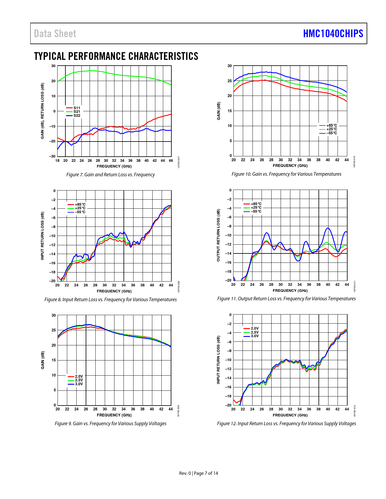

Data Sheet. HMC1040CHIPS. TYPICAL PERFORMANCE CHARACTERISTICS. B) d ( S S. S11. URN L. S21. N (. S22. , RE. B) d. –10. +85°C +25°C. –55°C. AI G. –20
Data Sheet HMC1040CHIPS TYPICAL PERFORMANCE CHARACTERISTICS B) d ( S S S11 URN L S21 N ( S22 , RE B) d –10 +85°C +25°C –55°C AI G –20
Data Sheet HMC1040CHIPS TYPICAL PERFORMANCE CHARACTERISTICS 30 30 20 25 B) d ( S S 10 20 O B) S11 d URN L 0 T S21 15 N ( S22 AI , RE G B) d –10 10 +85°C +25°C N ( –55°C AI G –20 5 –30 0 18 20 22 24 26 28 30 32 34 36 38 40 42 44 46

16709- 16709- Figure 7. Gain and Return Loss vs. Frequency Figure 10. Gain vs. Frequency for Various Temperatures
0 0 –2 –2 +85°C +85°C –4 +25°C –4 +25°C –55°C B) –55°C B) d d –6 ( –6 ( S S S S O O –8 –8 –10 URN L –10 URN L T T –12 RE –12 RE UT UT P –14 –14 INP UT O –16 –16 –18 –18 –20 –20

16709- 16709- Figure 8. Input Return Loss vs. Frequency for Various Temperatures Figure 11. Output Return Loss vs. Frequency for Various Temperatures
30 0 –2 2.0V 25 –4 2.5V 3.0V B) d –6 ( 20 S S O –8 B) d 15 N ( –10 URN L AI T G –12 RE 10 2.0V UT –14 2.5V 3.0V INP –16 5 –18 0 –20 20 22 24 26 28 30 32 34 36 38 40 42 44

16709- Figure 9. Gain vs. Frequency for Various Supply Voltages Figure 12. Input Return Loss vs. Frequency for Various Supply Voltages Rev. 0 | Page 7 of 14 Document Outline FEATURES APPLICATIONS FUNCTIONAL BLOCK DIAGRAM GENERAL DESCRIPTION TABLE OF CONTENTS REVISION HISTORY SPECIFICATIONS 20 GHz TO 24 GHz FREQUENCY RANGE 24 GHz TO 32 GHz FREQUENCY RANGE 32 GHz TO 40 GHz FREQUENCY RANGE 40 GHz TO 44 GHz FREQUENCY RANGE ABSOLUTE MAXIMUM RATINGS THERMAL RESISTANCE ESD CAUTION PIN CONFIGURATION AND FUNCTION DESCRIPTIONS INTERFACE SCHEMATICS TYPICAL PERFORMANCE CHARACTERISTICS THEORY OF OPERATION APPLICATIONS INFORMATION RECOMMENDED BIAS SEQUENCING MOUNTING AND BONDING TECHNIQUES FOR MILLIMETERWAVE GaAs MMICS Handling Precautions TYPICAL APPLICATION CIRCUIT ASSEMBLY DIAGRAM OUTLINE DIMENSIONS ORDERING GUIDE
