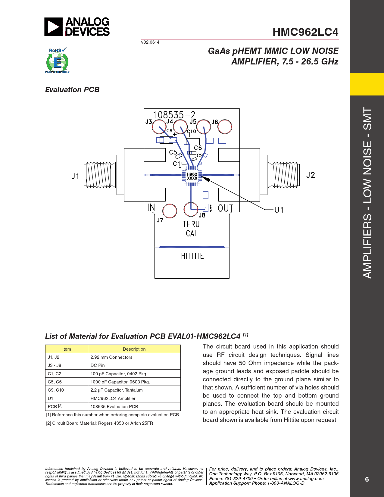

HMC962LC4. GaAs pHEMT MMIC LOW NOISE. AMPLIFIER, 7.5 - 26.5 GHz. Evaluation PCB
HMC962LC4 GaAs pHEMT MMIC LOW NOISE AMPLIFIER, 7.5 - 26.5 GHz Evaluation PCB
HMC962LC4
v02.0614
T m s e - is o w N lo s - r ie lif p m A
List of Material for Evaluation PCB EVAL01-HMC962LC4 [1]
item Description The circuit board used in this application should J1, J2 2.92 mm Connectors use rf circuit design techniques. signal lines should have 50 ohm impedance while the pack- J3 - J8 DC pin age ground leads and exposed paddle should be C1, C2 100 pf Capacitor, 0402 pkg. connected directly to the ground plane similar to C5, C6 1000 pf Capacitor, 0603 pkg. that shown. A sufficient number of via holes should C9, C10 2.2 µf Capacitor, Tantalum be used to connect the top and bottom ground U1 HmC962lC4 Amplifier planes. The evaluation board should be mounted pCB [2] 108535 evaluation pCB to an appropriate heat sink. The evaluation circuit [1] reference this number when ordering complete evaluation pCB board shown is available from Hittite upon request. [2] Circuit Board material: rogers 4350 or Arlon 25fr Inf F or o m r p atio r n ifc ur e n , d ishe e d lbiv y e A r n y a alog n D d t evic o p es is la beclie o eved rd to ebre sa: H ccur iattti e tae M nd re ilicarbloew . H a o ve C wever, o n rp o For price, delivery, and to place orders: Analog Devices, Inc., responsibility is assumed by Analog Devices for its use, nor for any infringements of patents or other oration, 2 Elizabeth Drive, Chelmsford, MA 01824 One Technology Way, P.O. Box 9106, Norwood, MA 02062-9106 Phone: 978-250-3343 Fax: 978-250-3373 O rights of third parties that may result from its use. Specifications subject to change without notice. No P rd hone e r O : 7 n 81- -3li 2n 9 e a -47 t w 0 w 0 • O w rd .h e it r o t niltie n .c e ao t m license is granted by implication or otherwise under any patent or patent rights of Analog Devices. www.analog.com
