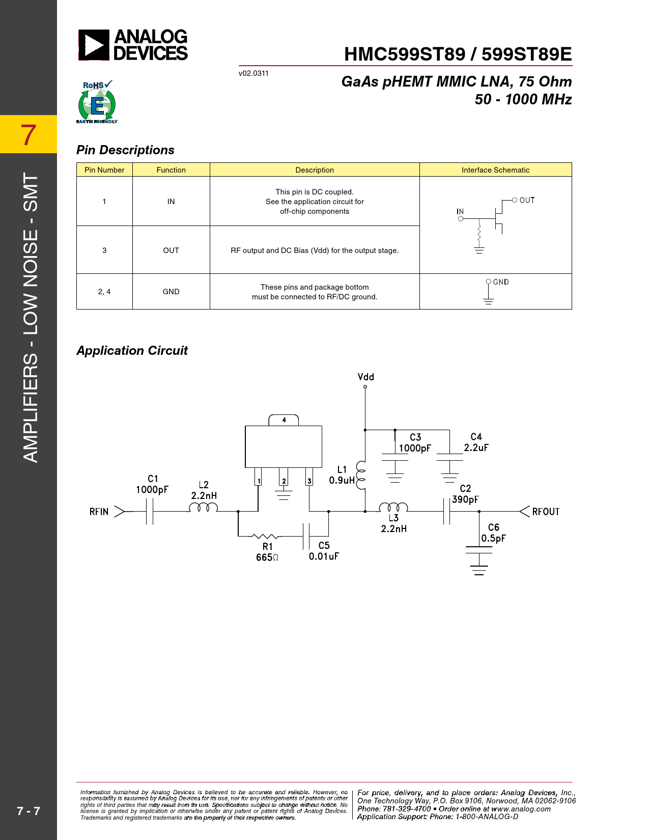

HMC599ST89 / 599ST89E
v02.0311
GaAs pHEMT MMIC LNA, 75 Ohm 50 - 1000 MHz
7
Pin Descriptions
T pin Number function Description interface schematic m This pin is DC coupled. s 1 iN see the application circuit for off-chip components e - is 3 OUT RF output and DC Bias (Vdd) for the output stage. o These pins and package bottom 2, 4 GND w N must be connected to RF/DC ground. lo s -
Application Circuit
