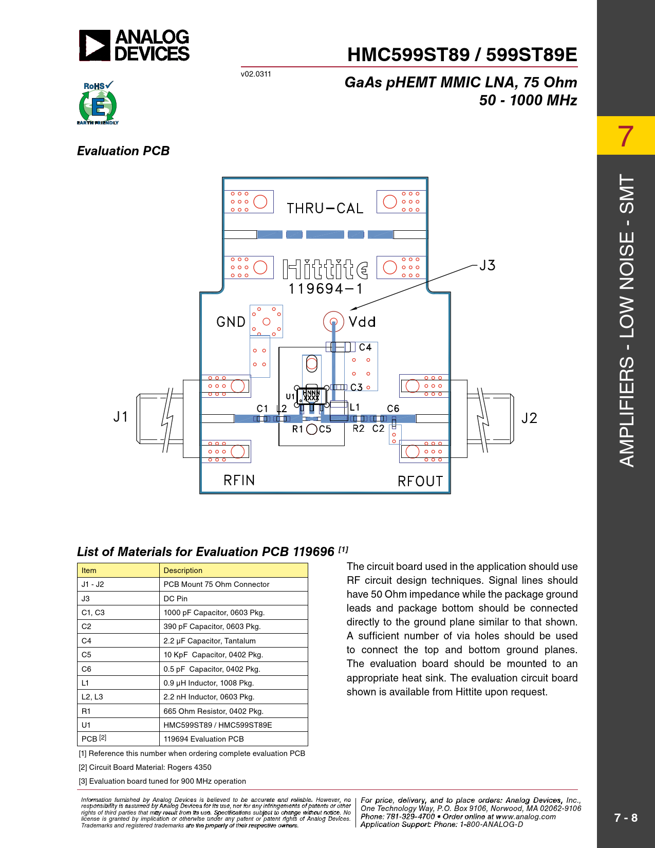

Evaluation PCB
T m s e - is o w N lo s - r ie lif p m A
List of Materials for Evaluation PCB 119696 [1]
The circuit board used in the application should use item Description rf circuit design techniques. signal lines should J1 - J2 pCB mount 75 ohm Connector have 50 ohm impedance while the package ground J3 DC Pin leads and package bottom should be connected C1, C3 1000 pf Capacitor, 0603 pkg. directly to the ground plane similar to that shown. C2 390 pf Capacitor, 0603 pkg. A sufficient number of via holes should be used C4 2.2 µf Capacitor, Tantalum to connect the top and bottom ground planes. C5 10 Kpf Capacitor, 0402 pkg. The evaluation board should be mounted to an C6 0.5 pf Capacitor, 0402 pkg. appropriate heat sink. The evaluation circuit board l1 0.9 μH inductor, 1008 pkg. shown is available from Hittite upon request. l2, l3 2.2 nH inductor, 0603 pkg. r1 665 ohm resistor, 0402 pkg. U1 HmC599sT89 / HmC599sT89e pCB [2] 119694 evaluation pCB [1] reference this number when ordering complete evaluation pCB [2] Circuit Board material: rogers 4350 [3] evaluation board tuned for 900 mHz operation Inf F or o m rat ip o r n ifc ur e n ,is hd e e d lbiv y e Anry alo a g n D d evi cto es ips la beclie ev eo d rtd o e b r e sa: ccH ur iattte itaen M d reliic a r bl o e w . H a o v weev eC r, o n r o For price, delivery, and to place orders: Analog Devices, Inc., responsibility is assumed by Analog Devices for its use, nor for any infringements of patents or other poration, 20 Alpha Road, Chelmsford, MA 01824 One Technology Way, P.O. Box 9106, Norwood, MA 02062-9106 Phone: 978-250-3343 Fax: 978-250-3373 rights of third parties that may result from its use. Specifications subject to change without notice. No Or P d hoe n r e O : 7 n- 81-li 3 n 2 e 9- a 4 t 7 0 www 0 • O . rdh e itt r o it n e li . n co e a m license is granted by implication or otherwise under any patent or patent rights of Analog Devices. t www.analog.com
