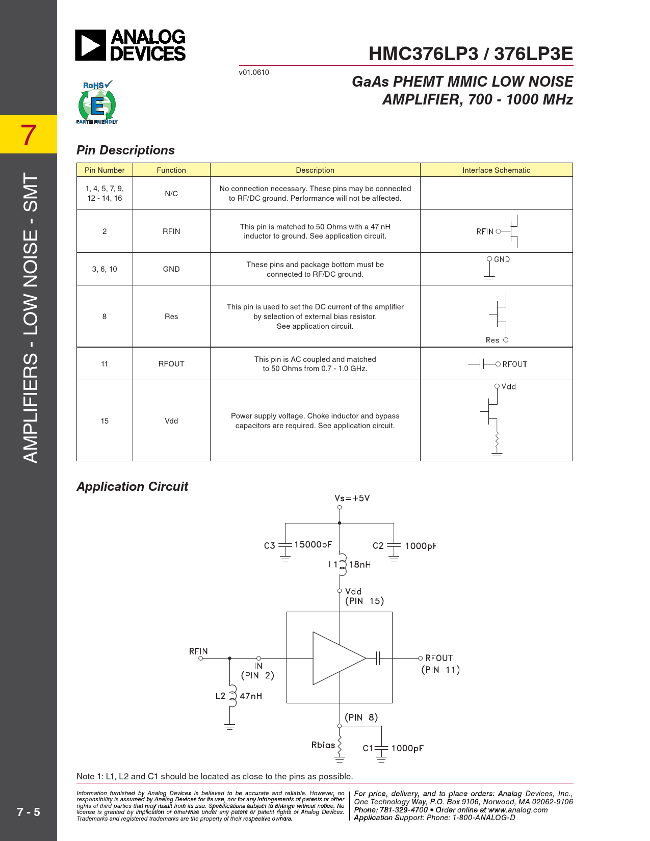

HMC376LP3 / 376LP3E
v01.0610
GaAs PHEMT MMIC LOW NOISE AMPLIFIER, 700 - 1000 MHz
7
Pin Descriptions
T Pin Number Function Description Interface Schematic 1, 4, 5, 7, 9, No connection necessary. These pins may be connected N/C 12 - 14, 16 to RF/DC ground. Performance will not be affected. This pin is matched to 50 Ohms with a 47 nH E - SM 2 RFIN inductor to ground. See application circuit. IS These pins and package bottom must be 3, 6, 10 GND connected to RF/DC ground. W NO This pin is used to set the DC current of the amplifi er O 8 Res by selection of external bias resistor. See application circuit. - L S This pin is AC coupled and matched 11 RFOUT R to 50 Ohms from 0.7 - 1.0 GHz. IE IF L Power supply voltage. Choke inductor and bypass 15 Vdd P capacitors are required. See application circuit. M A
Application Circuit
Note 1: L1, L2 and C1 should be located as close to the pins as possible. Information furnish F e o d r pri by An ce, de alog Devic leis vie s rby eli, a eve nd to pla d to be accur ce o ate an r d der relia s ble , pl . Ho ease co wever, no For price, delivery, and to place orders: Analog Devices, Inc., responsibility is assumed by Analog Devices for its use, nor for any infringements of patents or other ntact Hittite Microwave Corporation: One Technology Way, P.O. Box 9106, Norwood, MA 02062-9106 20 Alpha Road, Chelmsford, MA 01824 Phone rights of third parties that may result from its use. Specifications subject to change without notice. No : 978 Phon -e25 : 7 0 81 - - 3 3 3 29 4 - 3 F 470 ax 0 • O : 978 rder o - nl 25 in 0 e a - t 33 ww 73
