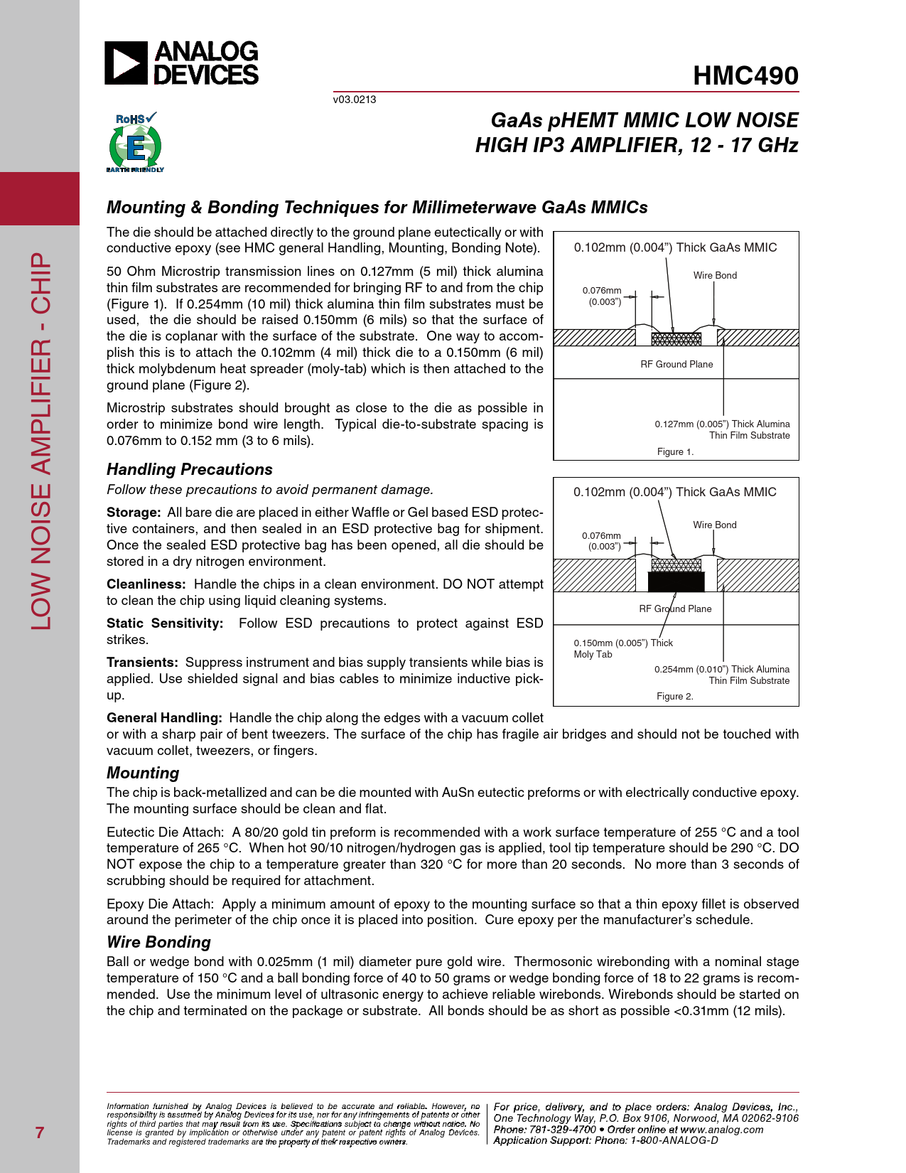

GaAs pHEMT MMIC LOW NOISE HIGH IP3 AMPLIFIER, 12 - 17 GHz Mounting & Bonding Techniques for Millimeterwave GaAs MMICs
The die should be attached directly to the ground plane eutectical y or with conductive epoxy (see HMC general Handling, Mounting, Bonding Note). 0.102mm (0.004”) Thick GaAs MMIC IP H 50 Ohm Microstrip transmission lines on 0.127mm (5 mil) thick alumina Wire Bond thin film substrates are recommended for bringing RF to and from the chip 0.076mm C (Figure 1). If 0.254mm (10 mil) thick alumina thin film substrates must be (0.003”) - used, the die should be raised 0.150mm (6 mils) so that the surface of R the die is coplanar with the surface of the substrate. One way to accom- plish this is to attach the 0.102mm (4 mil) thick die to a 0.150mm (6 mil) IE thick molybdenum heat spreader (moly-tab) which is then attached to the RF Ground Plane ground plane (Figure 2). LIF Microstrip substrates should brought as close to the die as possible in P order to minimize bond wire length. Typical die-to-substrate spacing is 0.127mm (0.005”) Thick Alumina M 0.076mm to 0.152 mm (3 to 6 mils). Thin Film Substrate Figure 1. A

E Follow these precautions to avoid permanent damage. 0.102mm (0.004”) Thick GaAs MMIC IS

All bare die are placed in either Waffle or Gel based ESD protec- O tive containers, and then sealed in an ESD protective bag for shipment. Wire Bond 0.076mm Once the sealed ESD protective bag has been opened, all die should be (0.003”) N stored in a dry nitrogen environment. W

Moly Tab Suppress instrument and bias supply transients while bias is 0.254mm (0.010”) Thick Alumina applied. Use shielded signal and bias cables to minimize inductive pick- Thin Film Substrate up. Figure 2.
