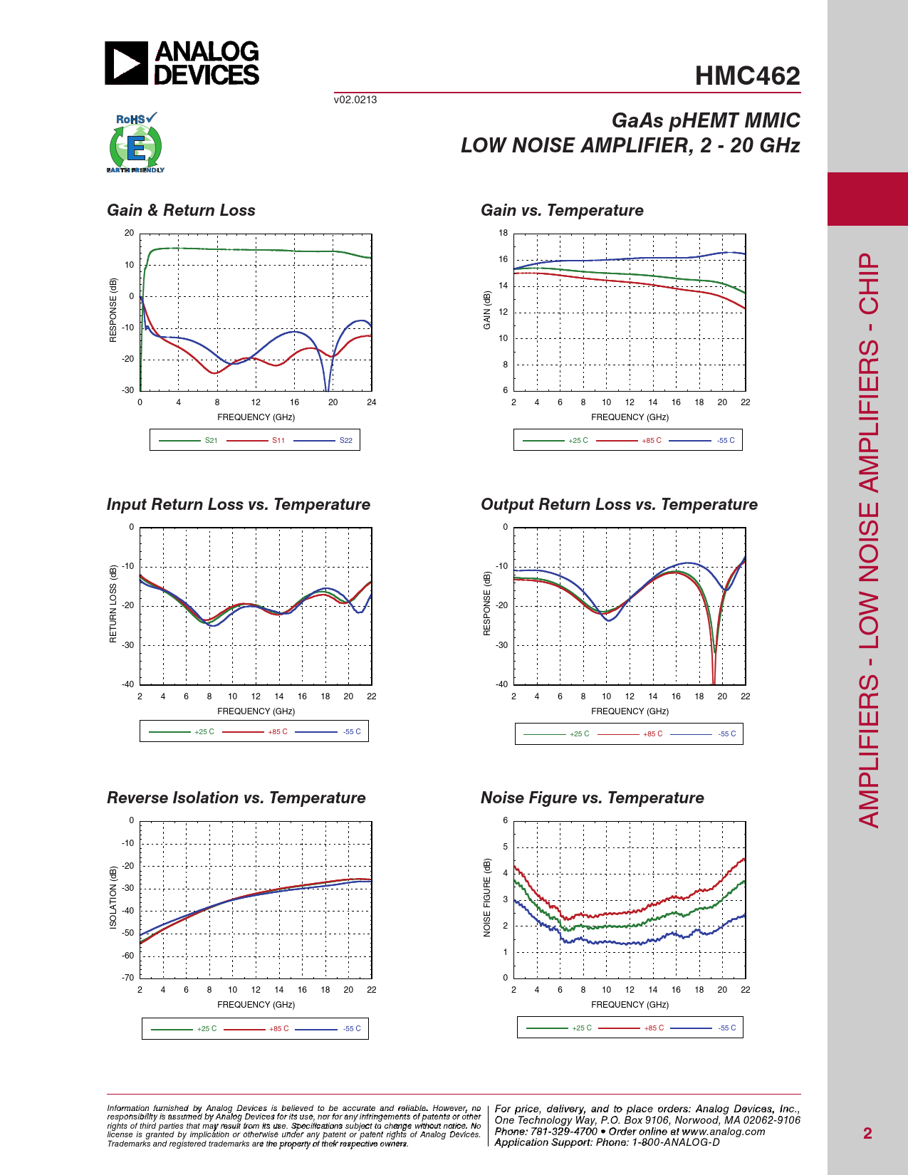

HMC462. GaAs pHEMT MMIC. LOW NOISE AMPLIFIER, 2 - 20 GHz. Gain & Return Loss. Gain vs. Temperature
HMC462 GaAs pHEMT MMIC LOW NOISE AMPLIFIER, 2 - 20 GHz Gain & Return Loss Gain vs Temperature
HMC462
v02.0213
GaAs pHEMT MMIC LOW NOISE AMPLIFIER, 2 - 20 GHz Gain & Return Loss Gain vs. Temperature
20 18 16 10 ip 14 (dB) 0 h (dB) 12 C -10 GAIN RESPONSE 10 - -20 s 8 r -30 6 0 4 8 12 16 20 24 2 4 6 8 10 12 14 16 18 20 22 ie FREQUENCY (GHz) FREQUENCY (GHz) S21 S11 S22 +25 C +85 C -55 C lif p m A
Input Return Loss vs. Temperature Output Return Loss vs. Temperature
e 0 0 is -10 -10 o (dB) (dB) N LOSS -20 -20 w RESPONSE RETURN -30 -30 lo - -40 -40 s 2 4 6 8 10 12 14 16 18 20 22 2 4 6 8 10 12 14 16 18 20 22 FREQUENCY (GHz) FREQUENCY (GHz) r +25 C +85 C -55 C +25 C +85 C -55 C ie lif p
Reverse Isolation vs. Temperature Noise Figure vs. Temperature
m 0 6 A -10 5 ) -20 (dB 4 (dB E N -30 R U IO T IG 3 F LA -40 E O IS IS 2 O -50 N -60 1 -70 0 2 4 6 8 10 12 14 16 18 20 22 2 4 6 8 10 12 14 16 18 20 22 FREQUENCY (GHz) FREQUENCY (GHz) +25 C +85 C -55 C +25 C +85 C -55 C Inf F or o m r p atio r n ifc ur e n , d ishe e d lbiv y e A r n y a alog n D d t evic o p es is la beclie o eved rd to ebre sa: H ccur iattti e tae M nd re ilicarbloew . H a o ve C wever, o n rp o For price, delivery, and to place orders: Analog Devices, Inc., responsibility is assumed by Analog Devices for its use, nor for any infringements of patents or other oration, 2 Elizabeth Drive, Chelmsford, MA 01824 One Technology Way, P.O. Box 9106, Norwood, MA 02062-9106 Phone: 978-250-3343 Fax: 978-250-3373 O rights of third parties that may result from its use. Specifications subject to change without notice. No P rd hone e r O : 7 n 81- -3li 2n 9 e a -47 t w 0 w 0 • O w rd .h e it r o t niltie n .c e ao t m license is granted by implication or otherwise under any patent or patent rights of Analog Devices. www.analog.com
